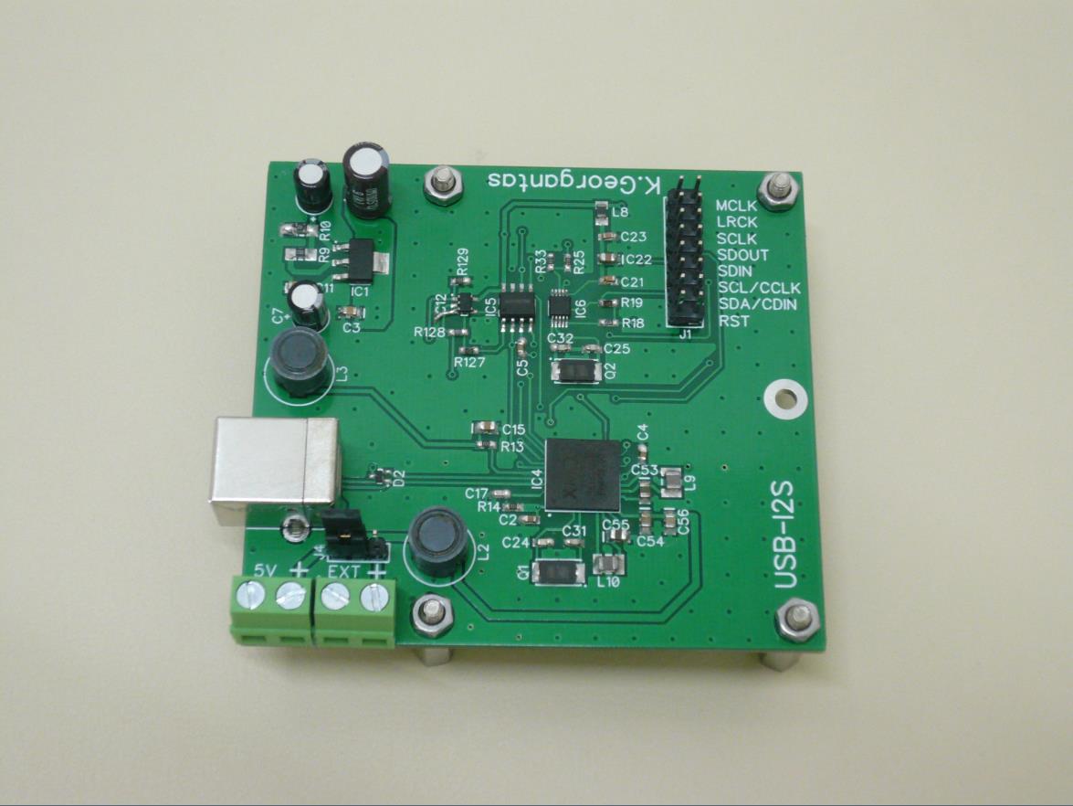

...PS. Meanwhile, I've been playing... An application notes "copy and paste" without deviations. With through hole parts.😀 That was the easy part. It needs a USB to i2s converter. The plan is to reverse engineer Behringer's pcb and transplant the chips hopefully with their conscious intact i.e. make use of the proprietary drivers. Winter's project.
attachment.php
Winter and spring project. A multi layer pcb involving a BGA96 chip. Anti-diy conspiracy, no doubt. 😀 I didn't make it to work. And I'm not going to insist on that anymore. I mean, it was a very interesting learning curve, I know a little bit more now but debugging this is simply beyond my reach.
So, I'm in search for a readily available USB to I2S module capable for data in and out plus master clocks and everything as shown on the picture. I need it for the "sequel" of this project. I found that one :XMOS Multichannel high-quality USB to/from I2S/DSD SPDIF PCB - DIYINHK Any opinions or suggestions for alternatives would be much appreciated.

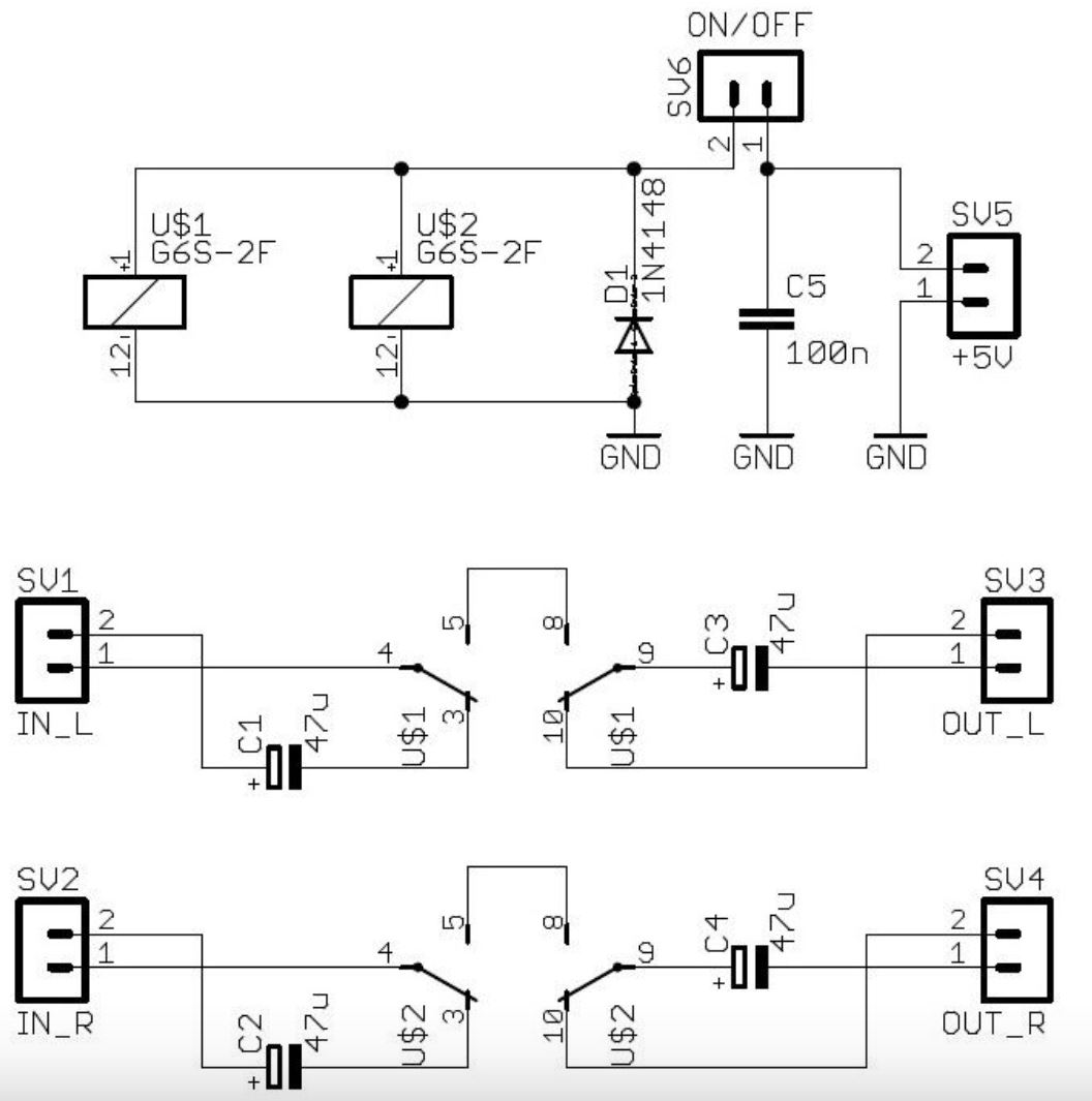

This mod is similar to one of MagicBus mods, but with relays.
https://www.elektroda.pl/rtvforum/topic3655998.html

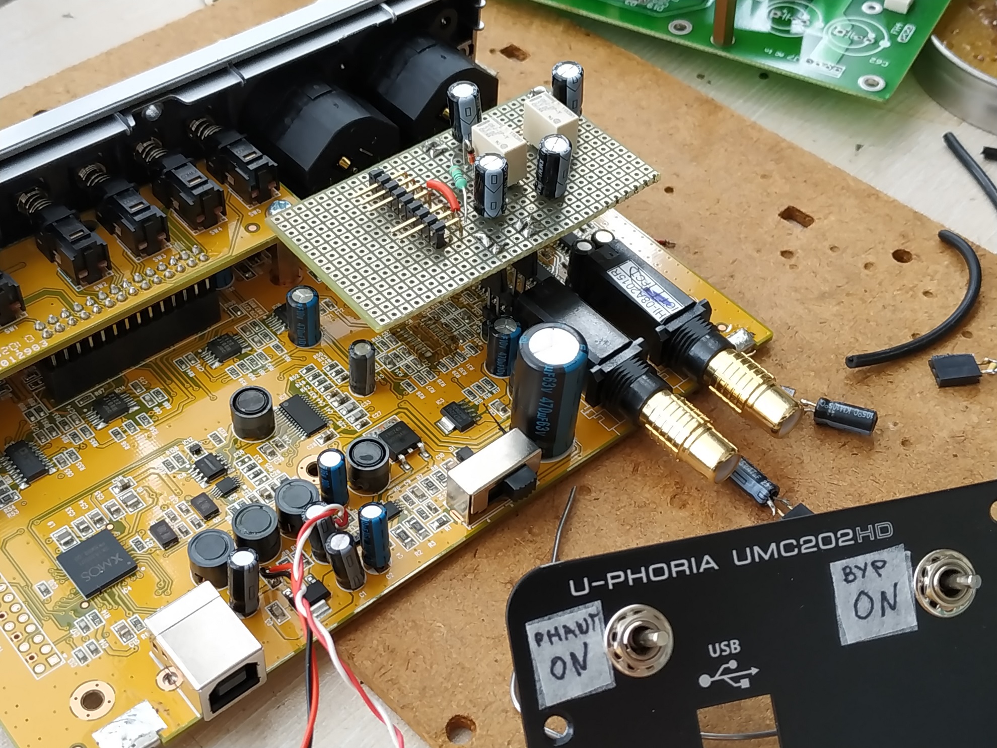

I made the same mod, on a breadboard. The results were much better.
Unfortunately, when measuring I burned the ADC input op amp 🙁. The codec survived.
I ordered a replacement.

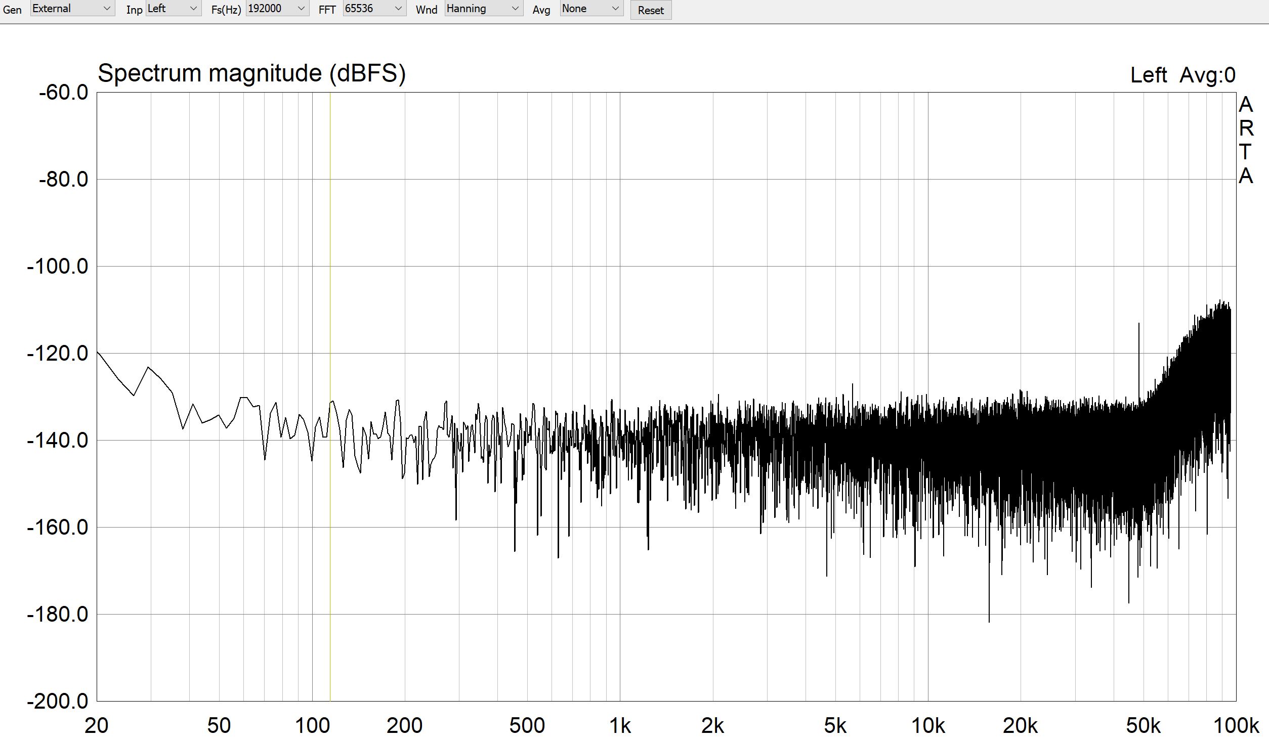

I found frequency spikes in the audio amplitude spectrum. Their origin was the 48V boost.
It does not switch off when the 48V switch is Off. So - I added another switch disconnecting the power of the booster.

Thanks! Your work is nice too! I checked your website but I can't read Bulgarian. Could you please explain what have you done around C81, C85? Also if you could elaborate about the noise related with the 48V phantom power? Is it the high pitched spike mentioned earlier?
I have extracted the whole USB section of my sound card to build the -failed - module shown in post #61. I may try to restore it but it will take some mental preparation... But sniffing around that section, I found something interesting. There is only one 3,3V regulator for all the chips - the XMOS microcontroller, the flash memory and the PLL clock. Sadly, even decoupling capacitors are missing. And then this power rail goes to the audio codec digital supply via just an inductor. I think this may be the culprit for the high pitched noise after all. It would be very interesting if somebody could try to separate the audio codec from the rest. The mod seems very easy. Just remove the inductor L11 and feed the CS4272 from another 3,3V LDO.
The miniDSP module is nice but it lacks the I2C ports from what I understand. Not sure if it's necessary but also I don't know how to configure the audio codec in this case. So, I've ordered the DIYINHK module. It's on the way.

My mod is with the ugly prototype board. I haven't removed any input components around C81 and C85.
The noise from the 48V boost was rather strange. It presented itself as a spike and a noise floor increase around 50kHz. I saw several times a spike around 26kHz, but not every time. That was rather strange. 😕
When I change the ADC input op amp I will post some pictures of the noise observed.

To further add info to post 65. At last I changed the ADC input op amp.
The amplitude spectrum with 48V phantom ON and OFF can be seen attached.
