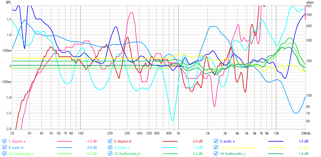

let's review the reason why we would need calibration for a small capsule omni electret.
absolute sensitivity influences:
diaphragm to backplate distance variation
fet drain source capacitance variation, fet forward transconductance variation when in common source configuration, fet drain gate voltage modulation (cause for distortion and gain variation)
high frequency response is also determined by diaphragm stiffness, and mic front grill design.
I have designed a panasonic capsule source follower with stabilized and bootstrapped drainvoltage such that electronics do not play a role in the frequency and gain response. Then even a panasonic 61 capsule showed a class1 behaviour .
I asked audix and earthworks for some cal files. My own two dayton mics are in this mix.
The beheringer curve looks good. The difference are small and having a cal file is only a starting point if you want absolute accuracy. There are a number of factors that will increase the uncertanty of the measurements. Everything from ambient temperature, humidity and pressure affect the accuracy as does the superposition accuracy. And even then if the mike casings are not identical they will affect the measurements at higher frequencies. NIST level measurements of class zerouncertanties are in the .3 to .5 dB range in ideal conditions. In practice .5 dB is very good. And above 10 KHz don't expect 1 dB from measurement to measurement with the same stuff if you move the hardware even slightly.
For distortion keep the level constant and move the mike to 2X distance and see if the distortion falls. If it does then you are looking at mike distortion. If not its driver distortion.
not yet, i did modify the panasonic capsule into a source follower version to achieve that., will try to find the design files, it has been a while, wanted to sel, the design to neutrik, but they did not believe the class1 behaviour... I did test the sensitivity using a piston calibrator at -20degr , 25 degr and 50 degr. could not to a freq response test, sadly.
