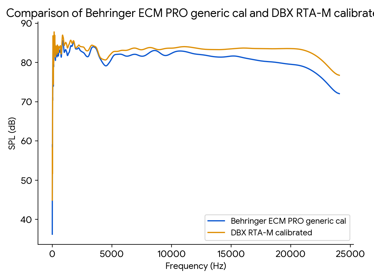

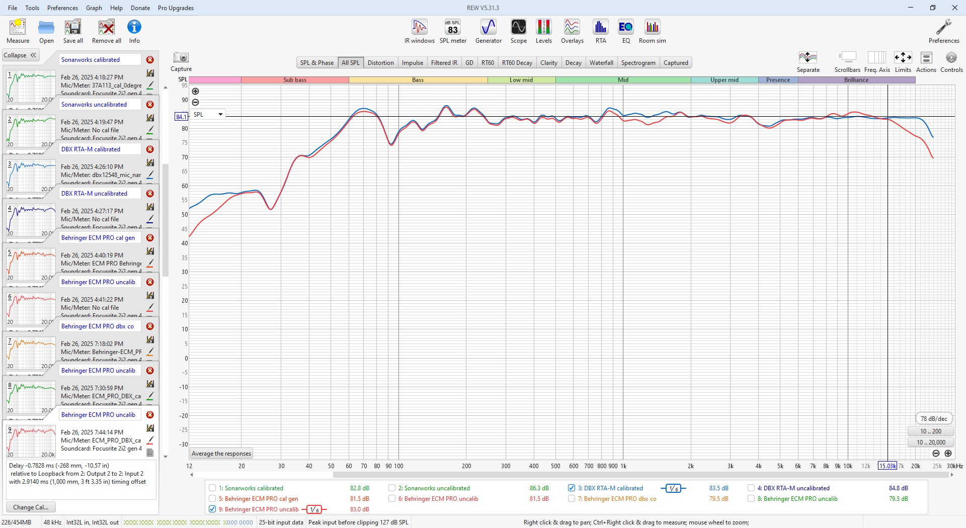

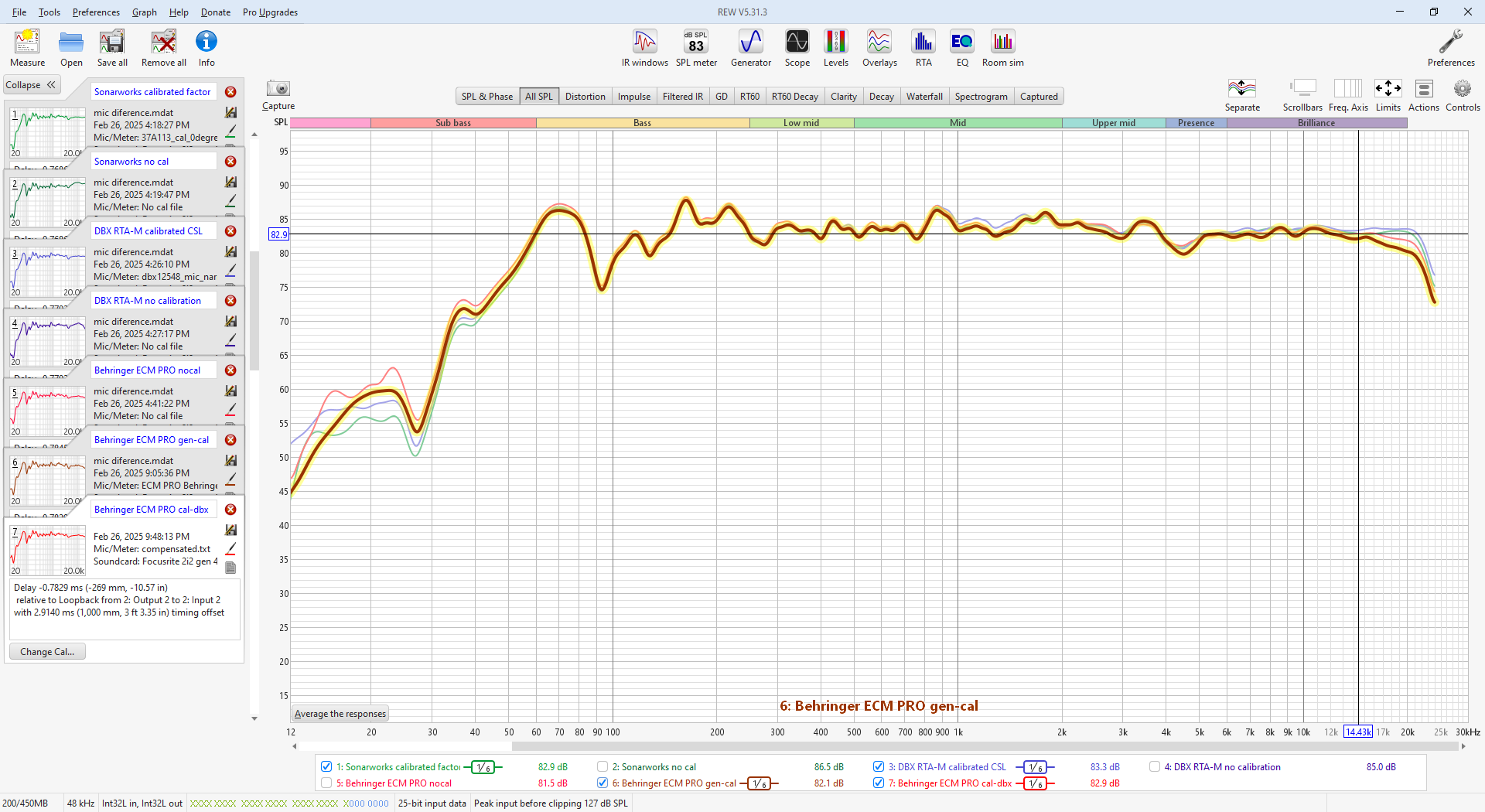

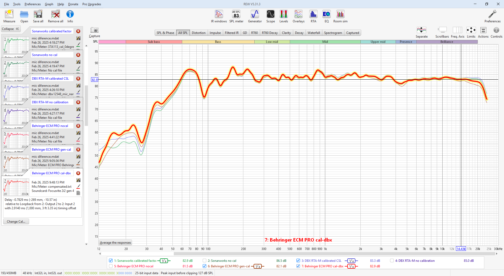

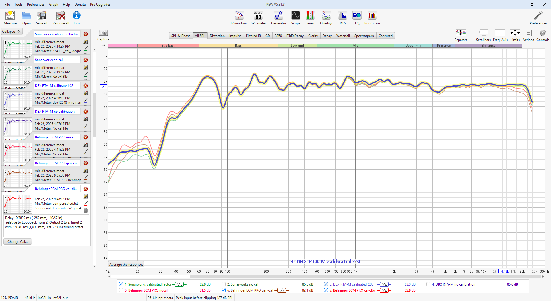

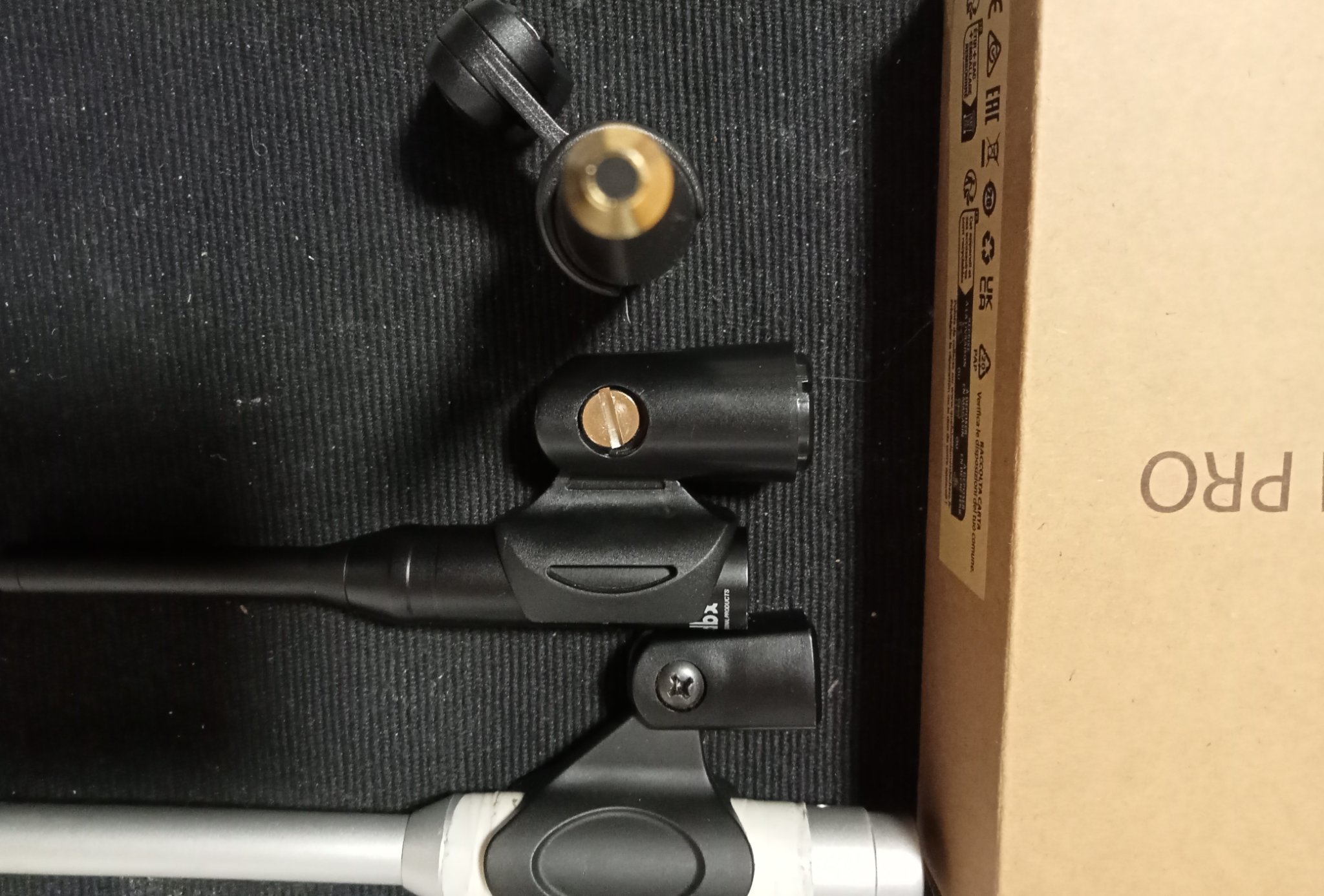

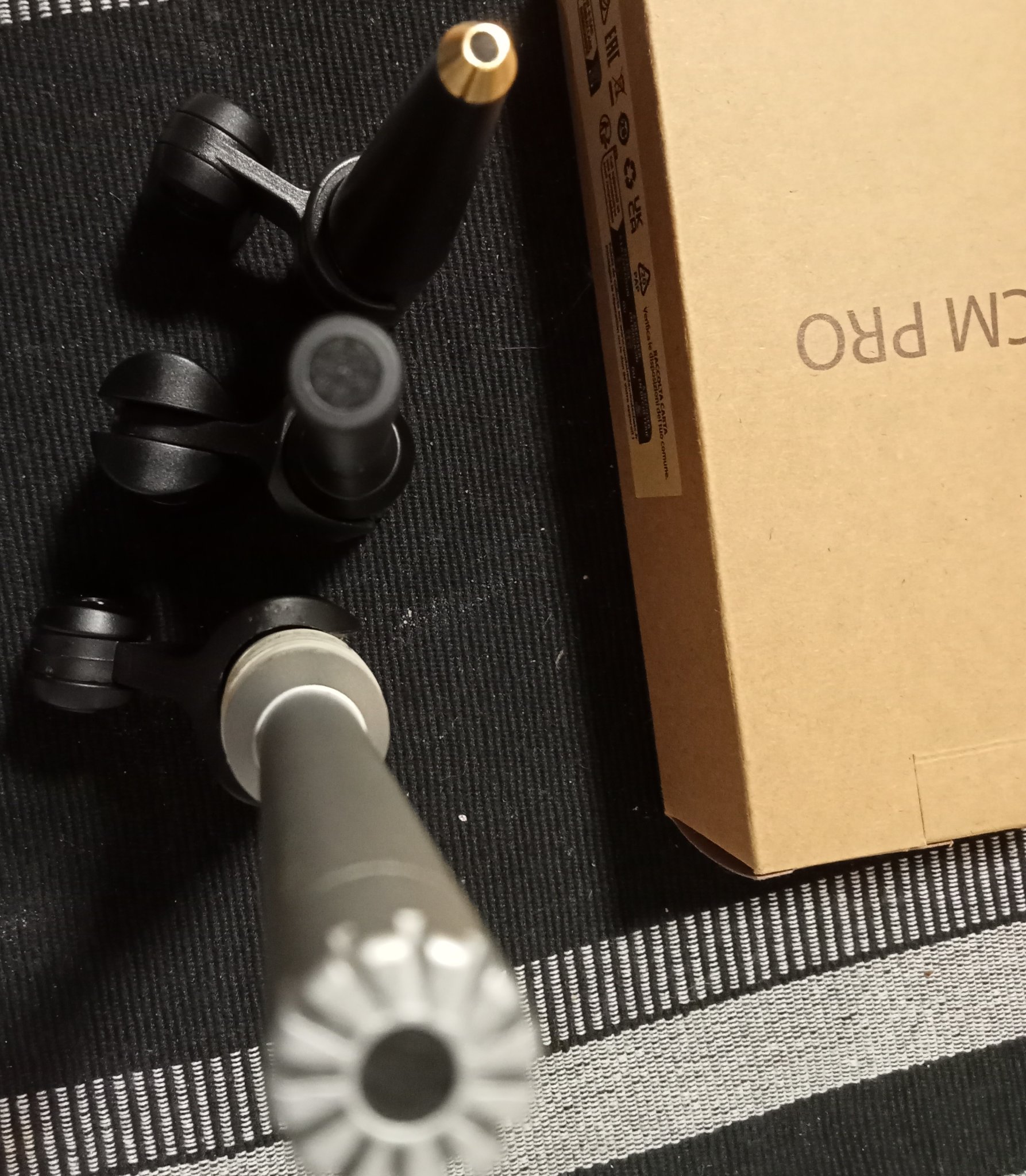

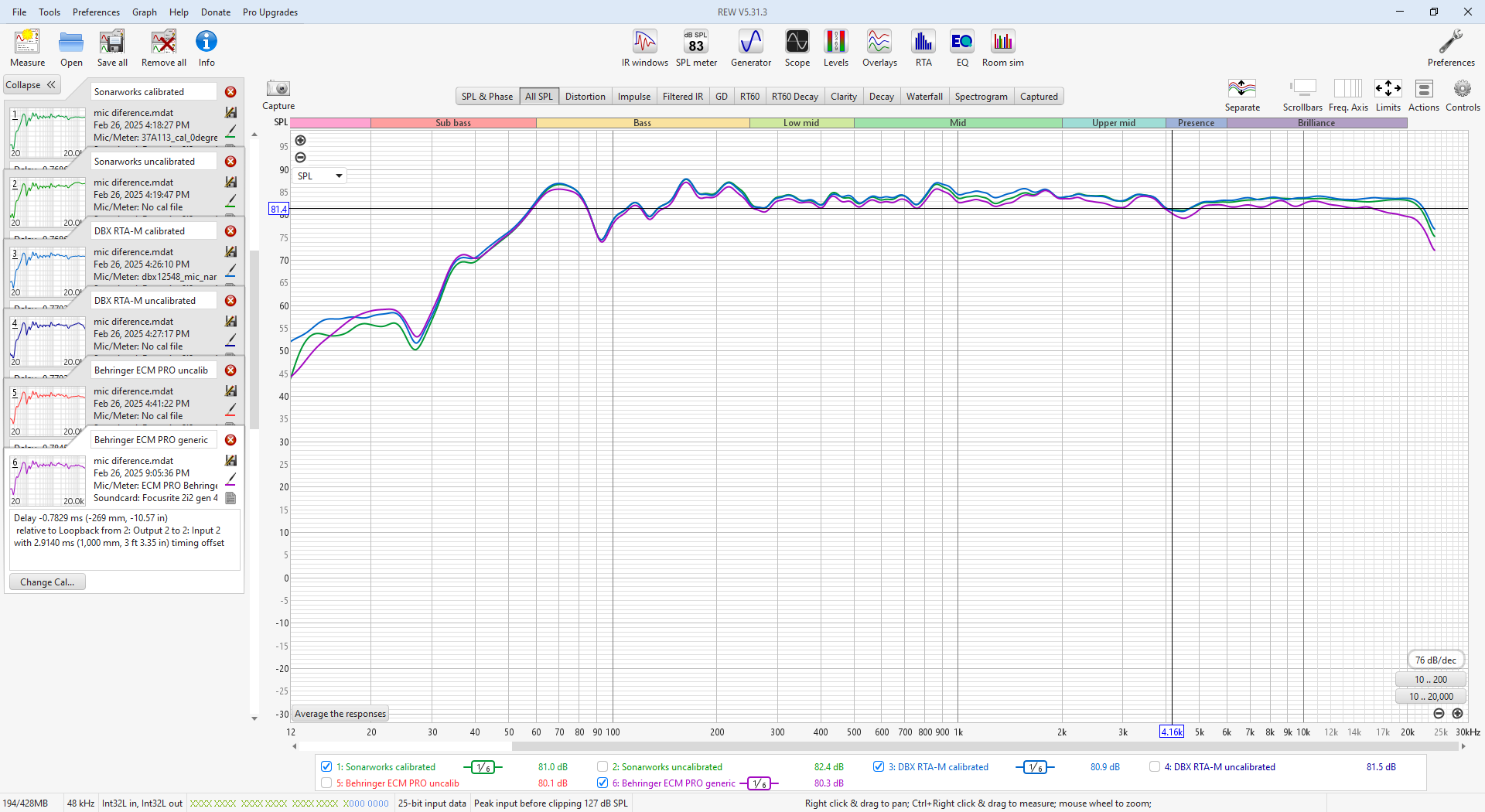

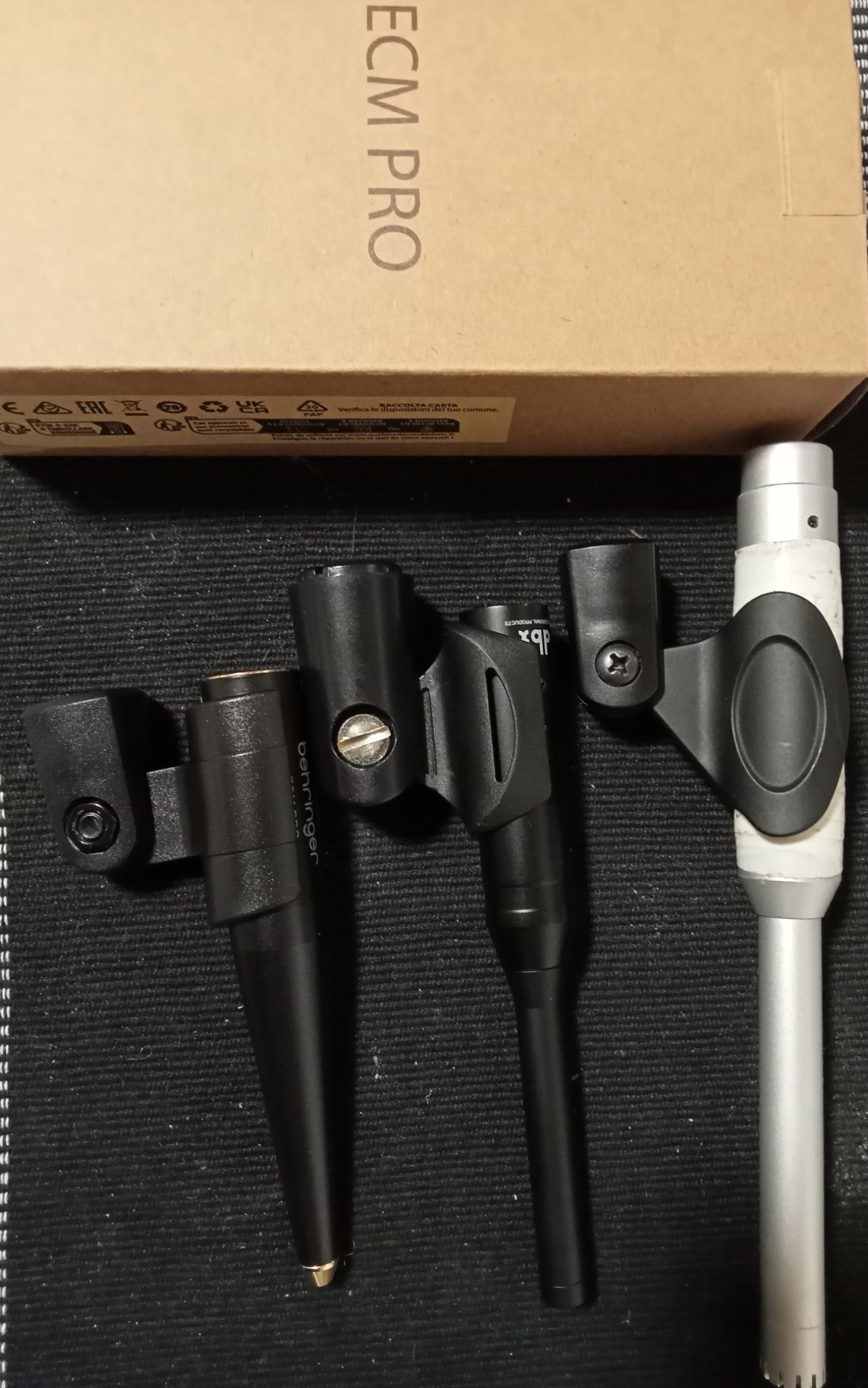

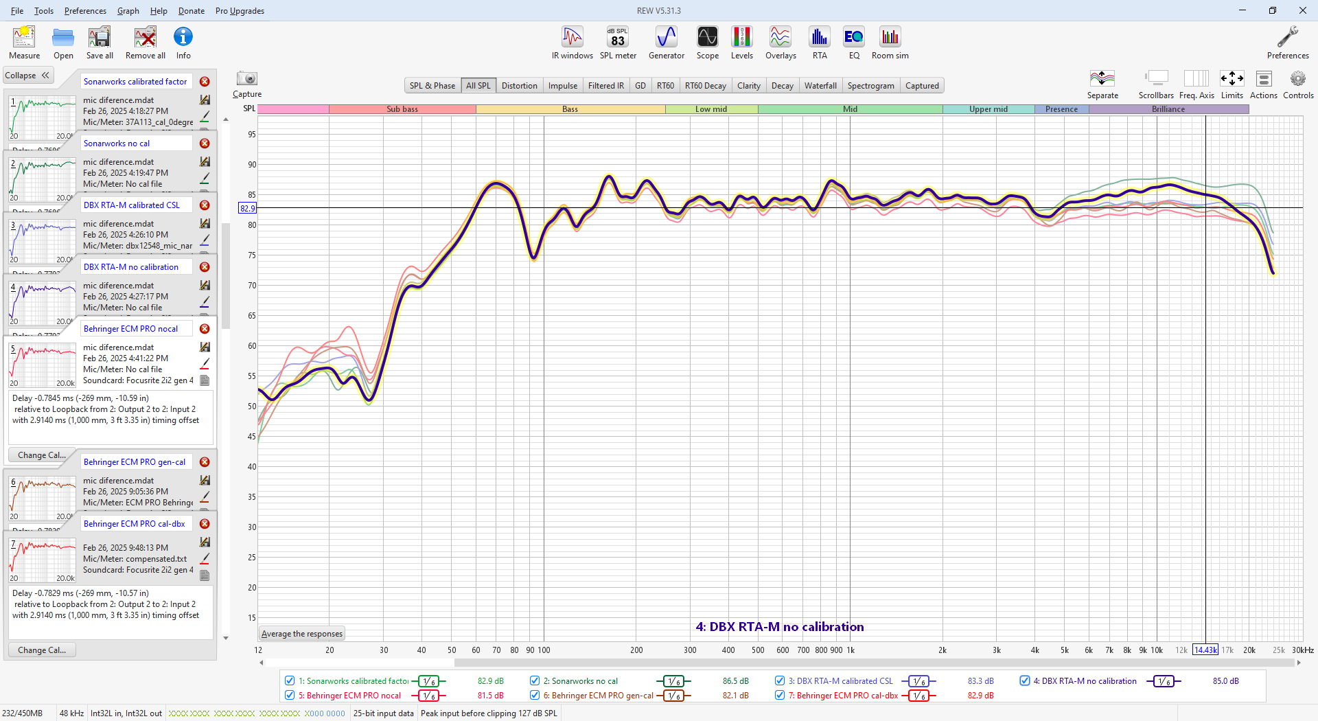

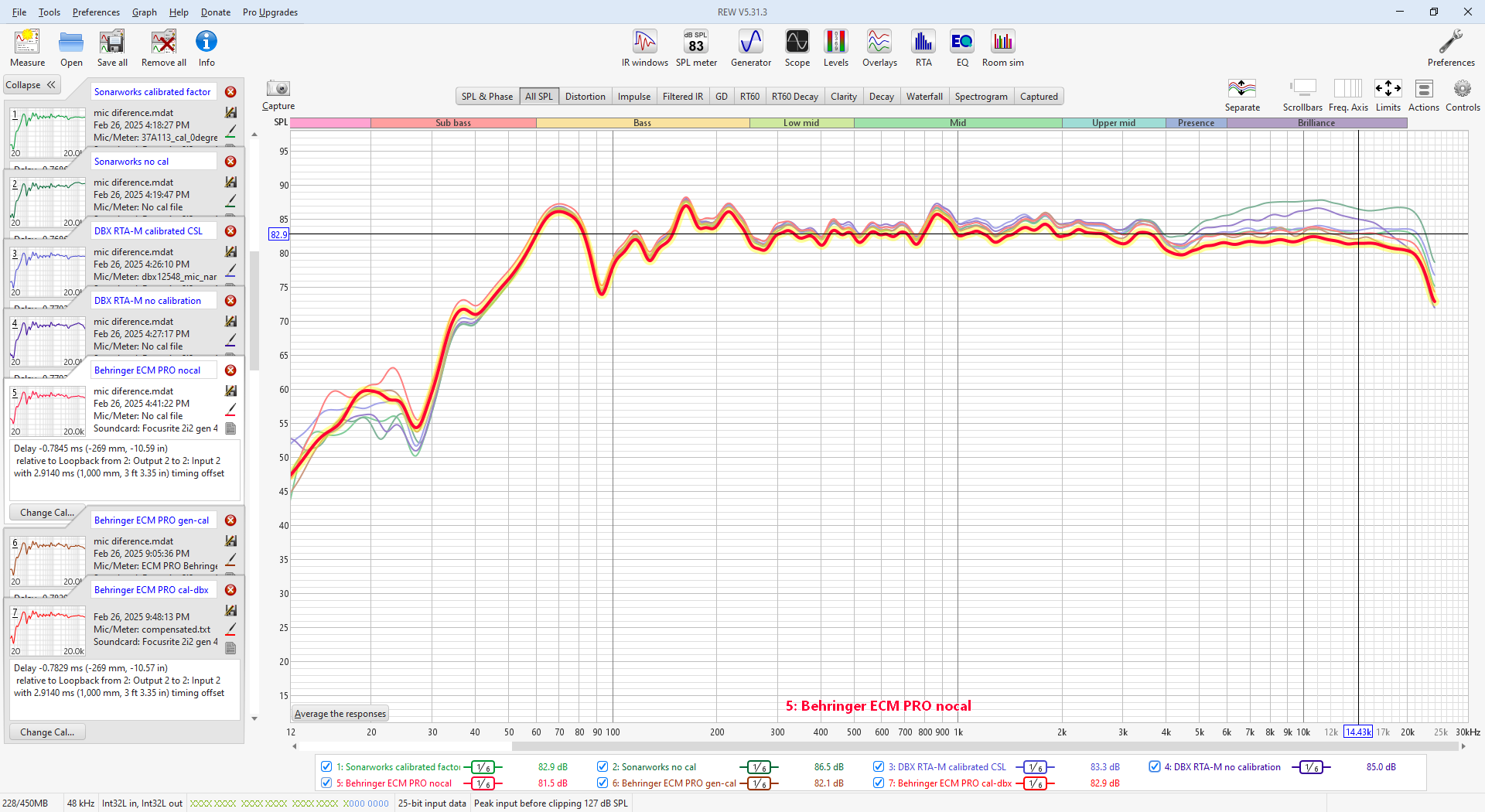

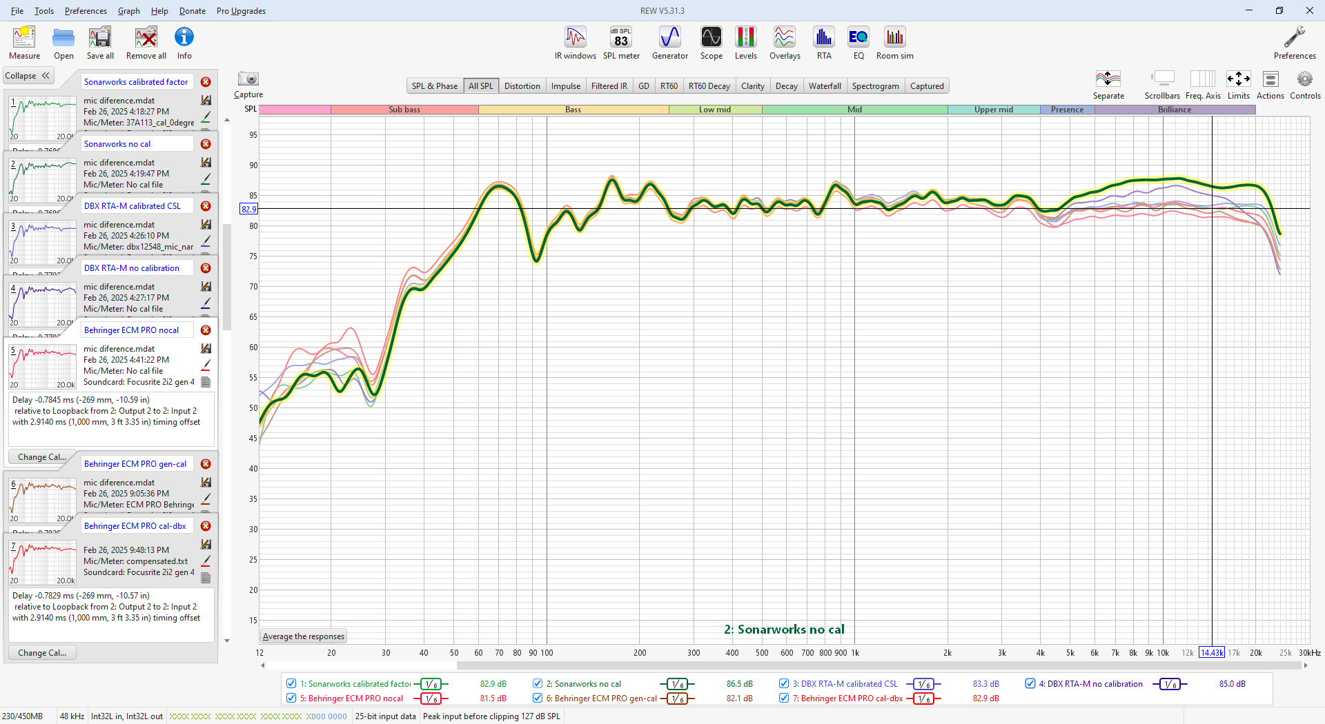

I bought the new model, a behringer ecm pro microphone with a small capsule, on their page there is a generic calibration file, in the tests I did, I compared the 2 calibrated microphones, crossspectrum laboratories calibrated dbx rta-m and reference sonarworks, calibrated from the factory, I made the measurements with and without calibration, after an hour of perfect fixation at the distance height point, I took the measurements and entered them in chatgpt, I was not satisfied with the result, so I switched to google gemini which turned out to be more accurate, see screenshots. The important thing is to be patient with the AI and explain to it where it goes wrong, to ask him specific questions, this requires you to show it the printscreen and give it the measured data.The result will also contain the non-minimum phase effects from both measurements. If these effects are caused by the acoustics of the room and not the microphone, then the calibration file could introduce errors, this calibration is only for the room where it is made, it is not a universal one for all environments, if you want to make measurements outside or in an anechoic chamber, you have to make other calibrations.This calibration is done at the DIY amateur level.
The next pass for a perfect calibration I will do with an acoustic chamber and a midbass speaker in a pvc tube, example in Arta/software link: https://www.artalabs.hr/.../AN5-MicroMeasChamber-Rev4Eng.pdf

Good idea, I will make detailed measurements when I finish the measuring chamber, I will wait a few days when I can work outside. unfortunately I did not save the .mdat from the rew and it is difficult for me to fix each microphone again, perfectly in the exact place.Any differences between the mics on measured harmonic distortion?
An easy way to reproduce microphone positions is to use 2 laser(pointers) with some distance (e.g. low right of speaker and high left) and aim at the microphone membrane. They lasers only meet at one point in the room and when you put your mic there you can reproduce the position to about +-1mm.

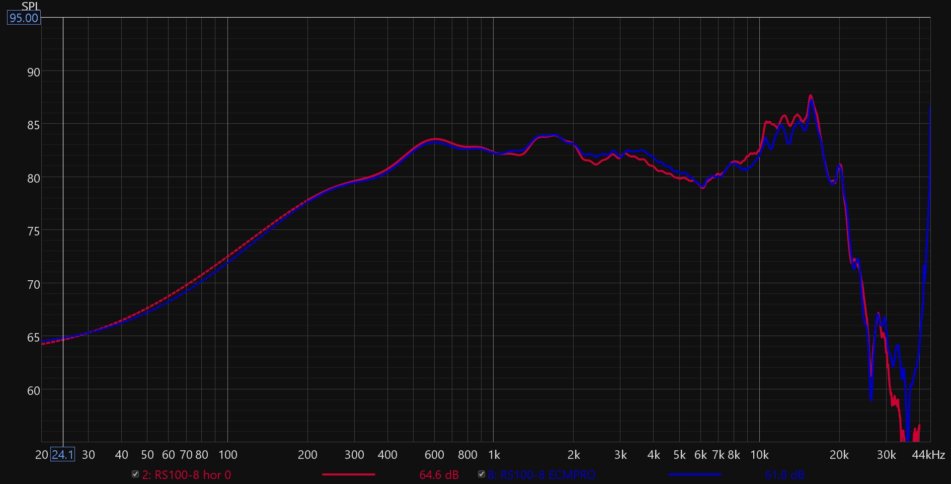

My Earthworks M23R is not working right so I have to send it to Sweetwater for several weeks. I sure hope they get it fixed, it was a pretty big deal for me to pull the trigger on that purchase.
I bought the new Behringer ECMPRO a few months ago but hadn't hooked it up.
I took a bunch of measurements 2 weeks ago before the EW started acting funny. Wanting to get this project done I will try to use the Behringer to wrap things up. My measurement rig is setup to be able to make pretty repeatable measurements. The ECMPRO does not have a calibration file and is supposed to measure out to 40kHz. I figured I would measure the speaker and make a calibration file to finish things up.
What the F@#!
Earthworks M23R $600 in blue
Behringer ECMPRO $40 in red - NO CALIBRATION FILE
I'll do more thorough testing and test distortion when I get the EW back, but just had to post this comparison.

If anything, I would first like to see a sample comparison of more than about 10 mics to check production quality and consistency.
https://www.hifi-selbstbau.de/index...0:1000-mikrofonkalibrierungen-eine-uebersicht
Only thing I have seen so far are just anecdotal comparisons, which are not useful at all.

I realized I do have distortion measurements of the drivers before the EW stopped working, so I can compare that, maybe this weekend.
@b_force - I agree to your point about seeing more, but anecdotal is not the right word. Anectodal: (of an account) not necessarily true or reliable, because based on personal accounts rather than facts or research. The measurements are facts/research, not a story, but I agree that one or two observations aren't statistically significant.

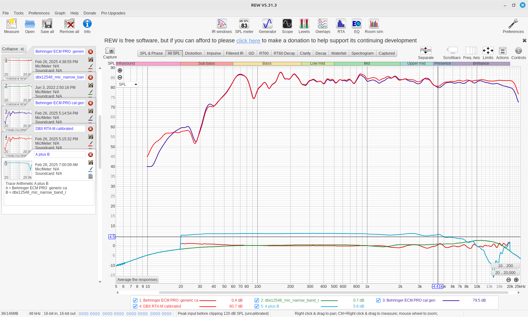

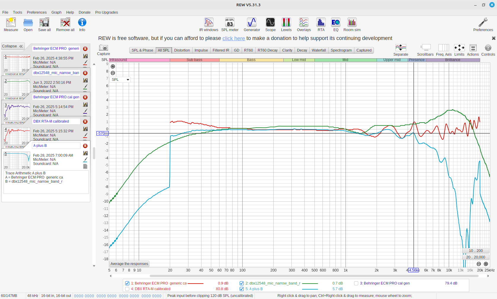

Don't calibrate here, it's a mess, I compared a microphone bought by a friend with the cross spectrum labs calibration, see the differences here.If anything, I would first like to see a sample comparison of more than about 10 mics to check production quality and consistency.

Sorry, don't have Facebook anymore, maybe you can share the results here?Don't calibrate here, it's a mess, I compared a microphone bought by a friend with the cross spectrum labs calibration, see the differences here.
Without account you can only see like 3 photos/pictures.
In general I don't know what you mean with "a mess".
