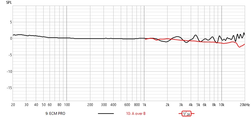

Let’s recap this all: the posts above don’t prove wrong the assumption that this mike is doing pretty well in some ways. And it seems to do level measurements from 20Hz to 30kHz quite OK. That is something and could (like in other places) be investigated further.

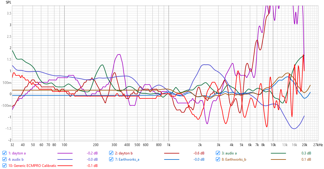

The beheringer curve looks good. The difference are small and having a cal file is only a starting point if you want absolute accuracy. There are a number of factors that will increase the uncertanty of the measurements. Everything from ambient temperature, humidity and pressure affect the accuracy as does the superposition accuracy. And even then if the mike casings are not identical they will affect the measurements at higher frequencies. NIST level measurements of class zerouncertanties are in the .3 to .5 dB range in ideal conditions. In practice .5 dB is very good. And above 10 KHz don't expect 1 dB from measurement to measurement with the same stuff if you move the hardware even slightly.
For distortion keep the level constant and move the mike to 2X distance and see if the distortion falls. If it does then you are looking at mike distortion. If not its driver distortion.

Someone here has done a comparison of 7 ECM Pro samples: https://www.diymobileaudio.com/thre...ics-7-behringer-ecm-8000-vs-7-ecm-pro.473008/ Looks fairly consistent.
Looks way better as the old one - as expected but great to see.
