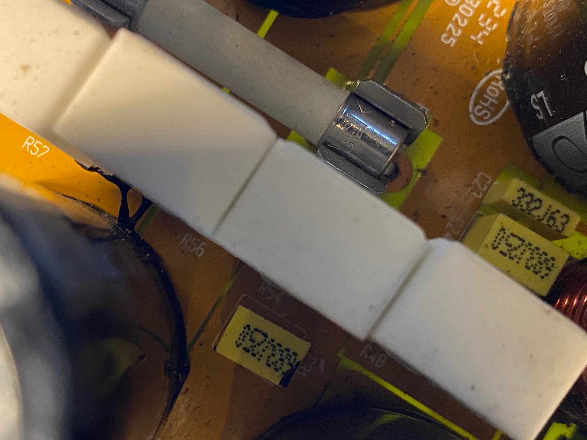

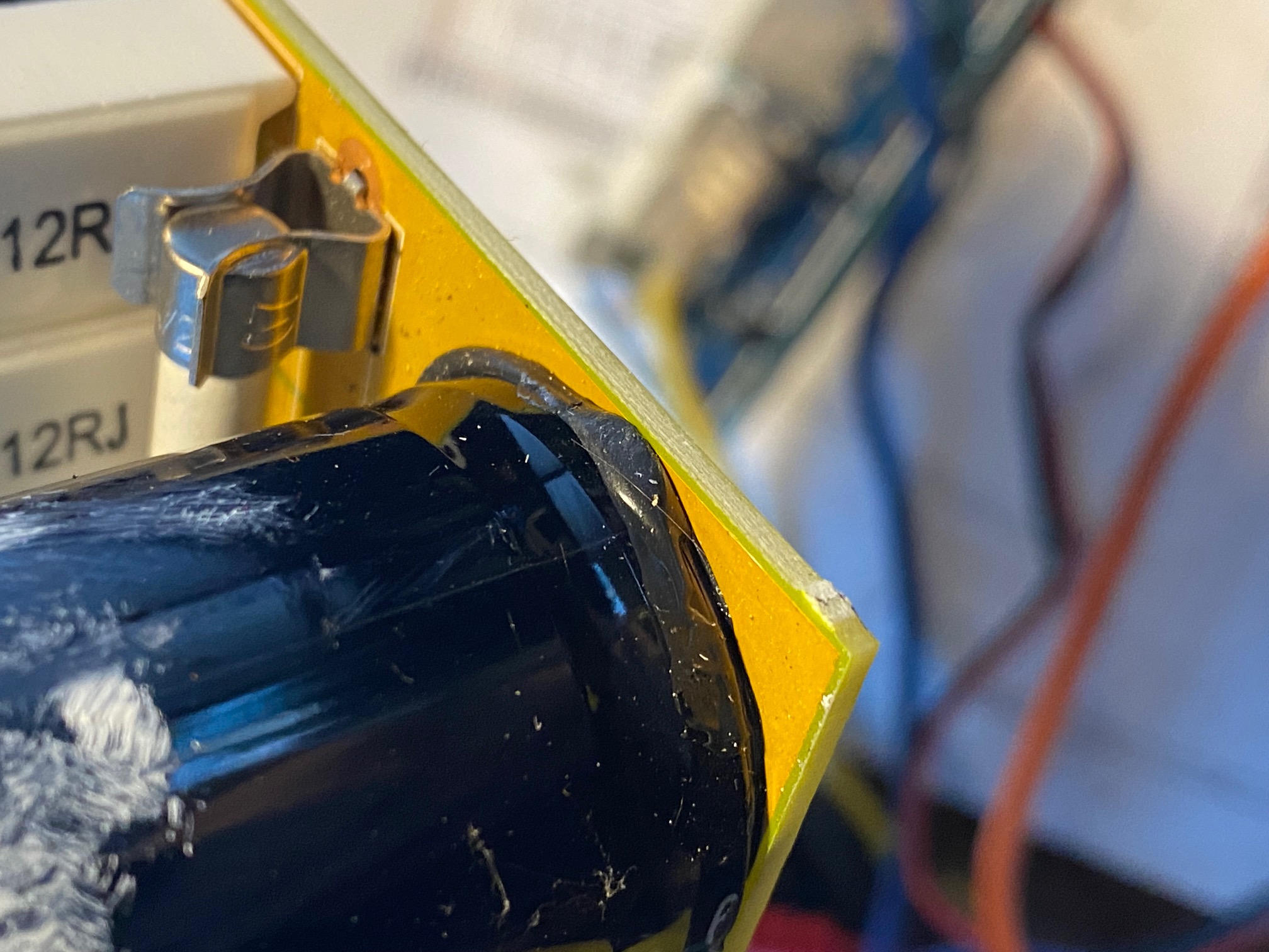

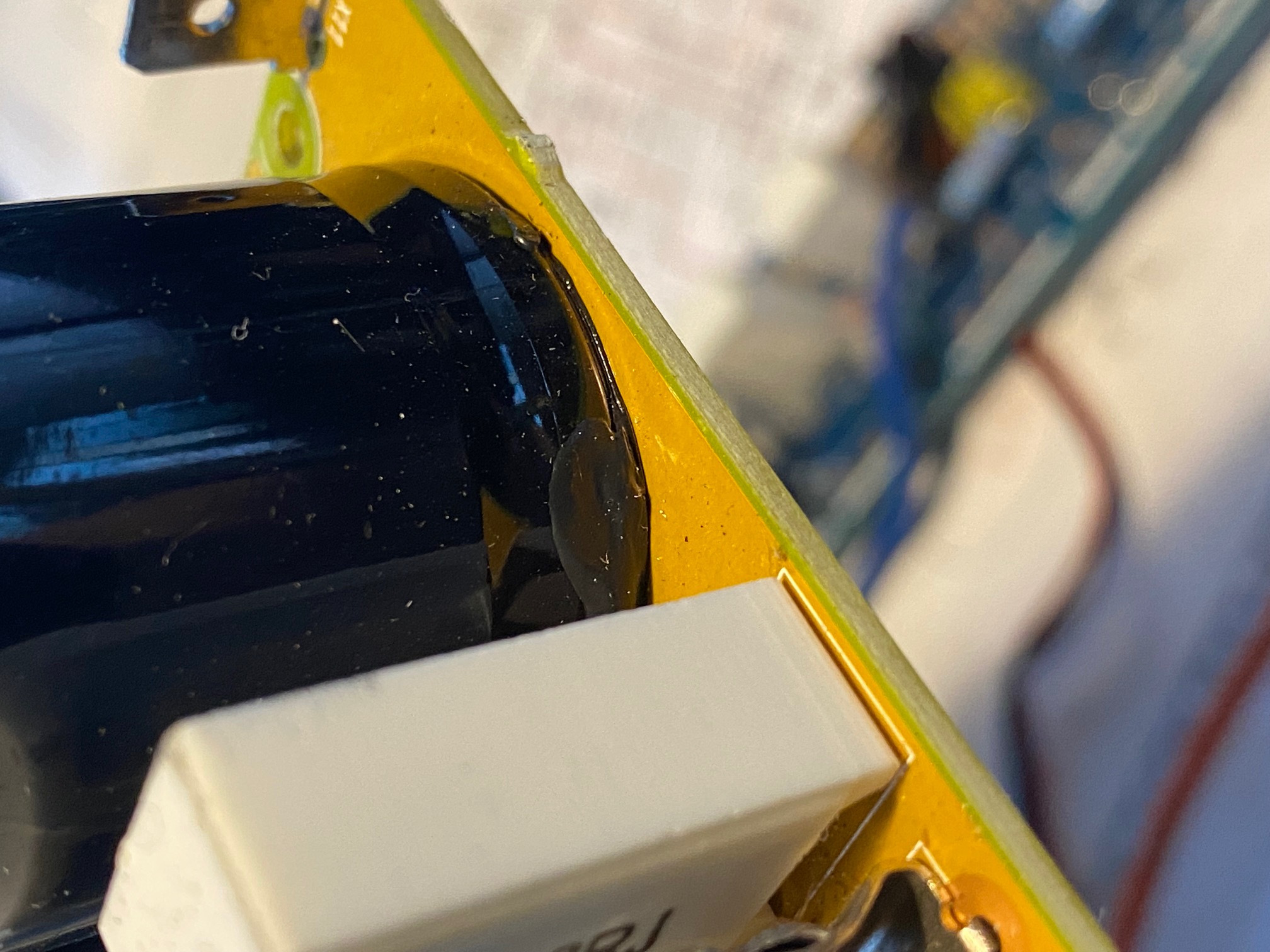

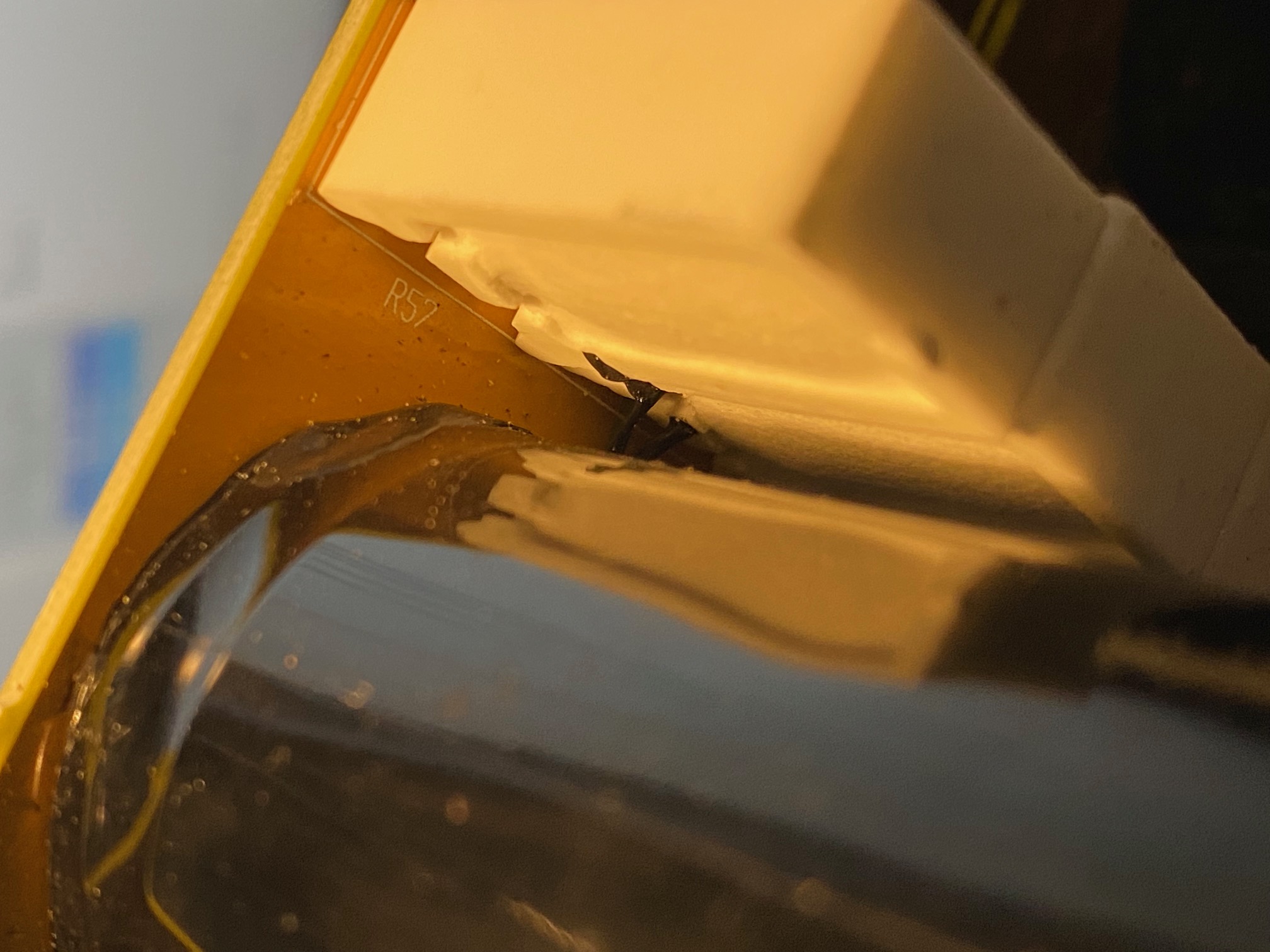

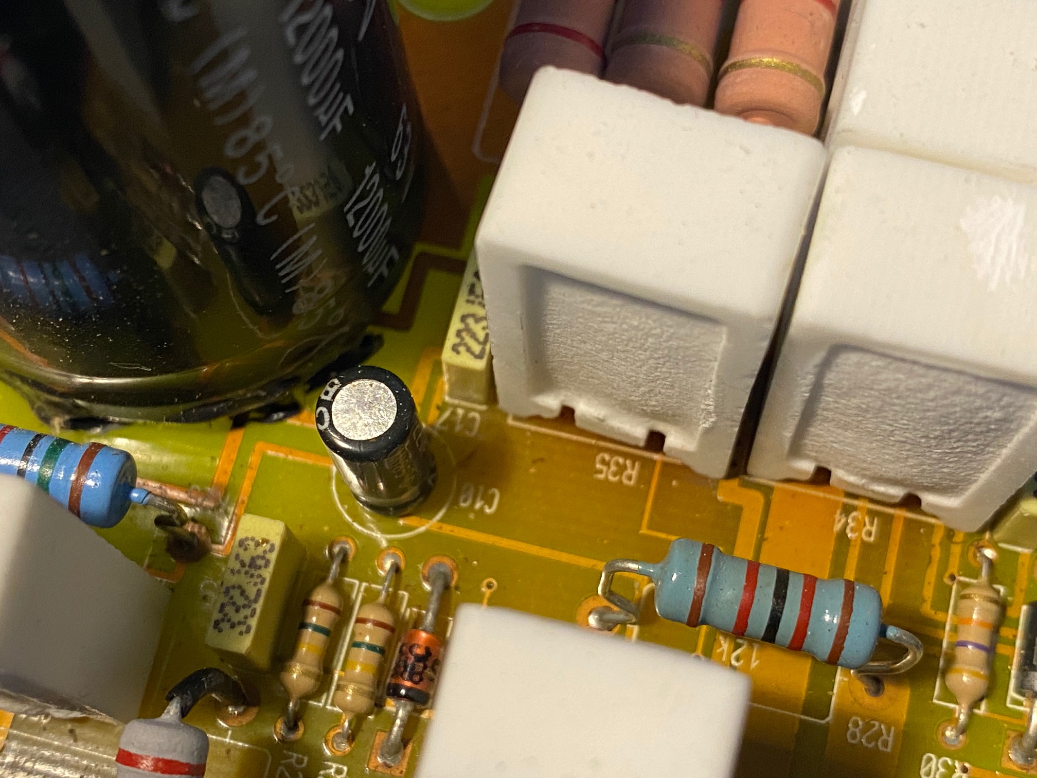

Poking around and noticed this, what appears to be melted plastic at the bottoms of the 12000uf 63v caps....

Ok, caps seem ok.
