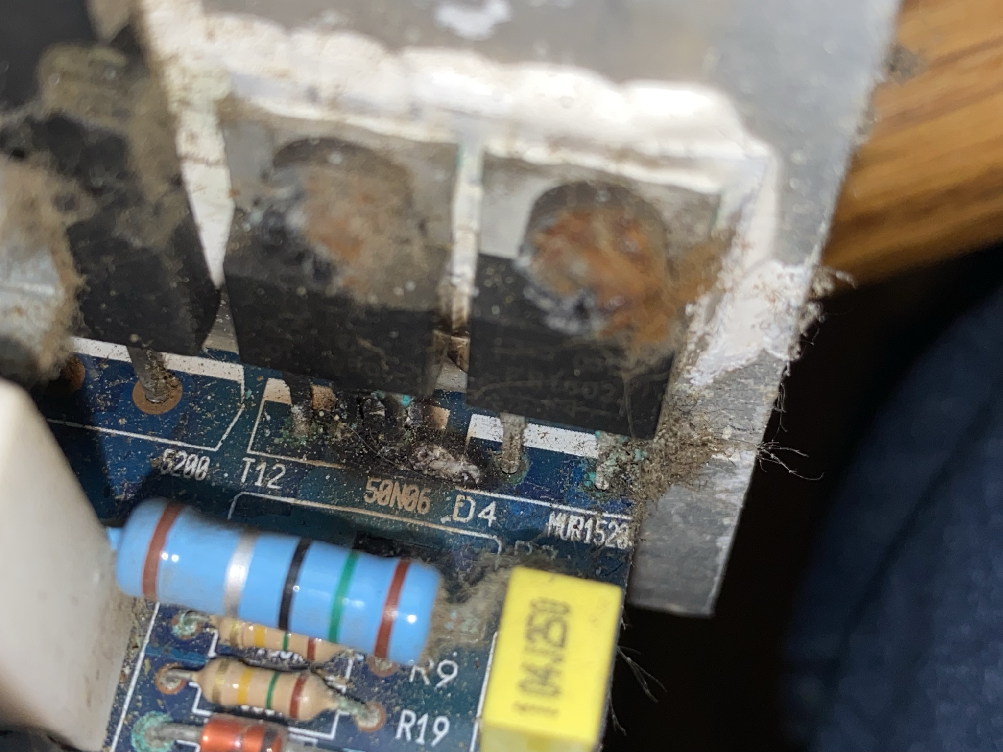

Hi all, first post here! I have 2 x Behringer EP4000's driving 8x18" subs in an infinite baffle system for my home cinema.
I have had them up in the attic for 4 years now, they are remotely powered when the receiver is powered up.

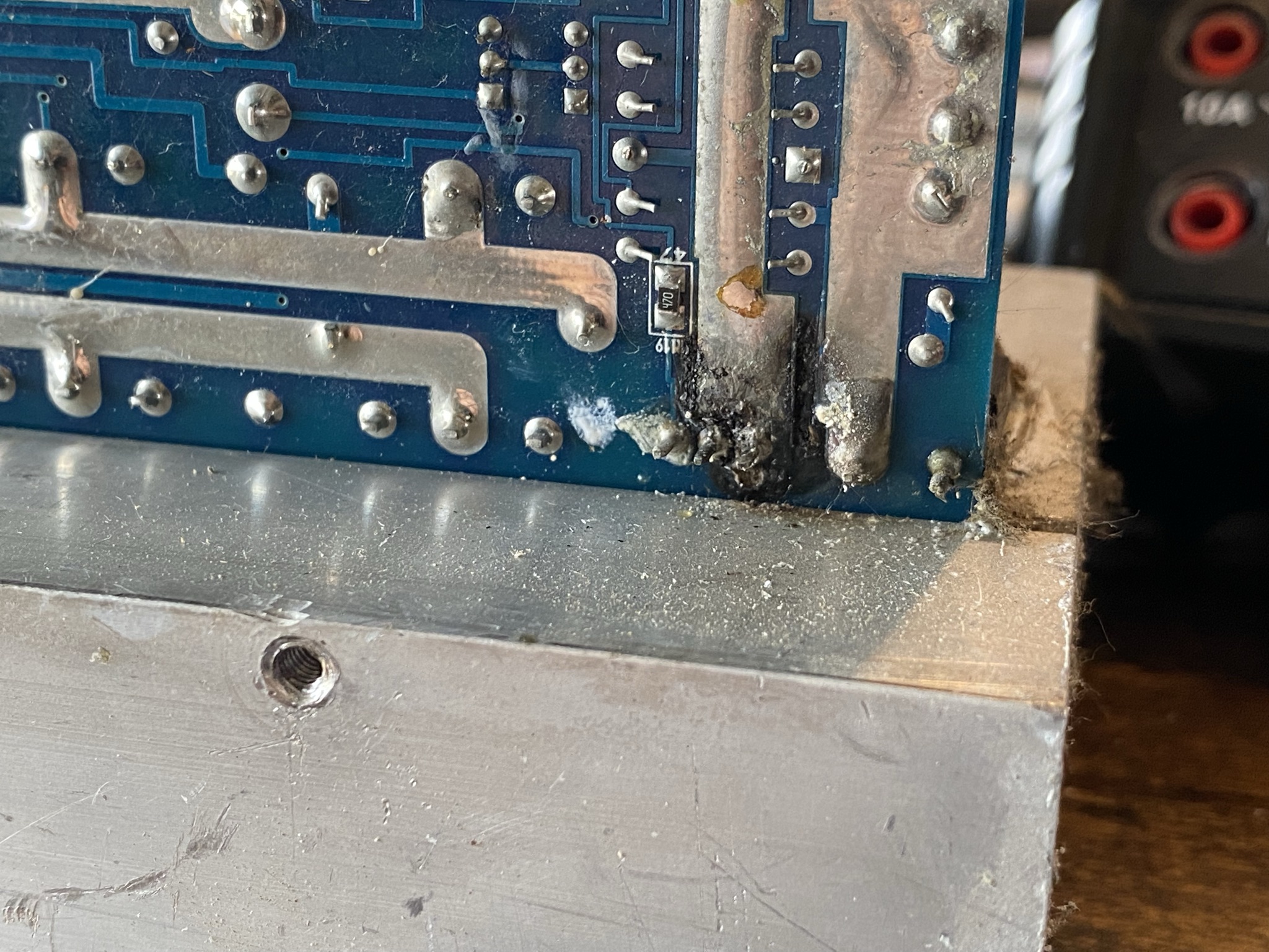

Recently i noticed i wasn't getting the usual 'ompf' that i used to, and ventured up there to see what's going on. Both amp's integrated breakers had tripped. On switching them, they would both buzz and trip off again.
So, I've pulled one out of the loft and via a process of elimination discovered the channel one is causing the tripping of the breakers.
I pulled that board out for closer inspection and discovered T16, a 50N06 had blown its top.
I have found a schematic online but don't pretend to know exactly what i am looking at here. I can replace the 50N06, but is there anything else it would be worth testing and upgrading while in there? I will pull the other amp out of the attic, but i suspect that as both went at the same time, it will have the same issue.
Thanks for any advice:)
Steve

That is the rail switch that blew out. If that was the only thing that shorted, the amp would still *work*, but overheat in seconds at high power. In order to cause the breaker to trip either T19-T22 or D30 would need to be shorted. If any one of T19-22 is bad you would change them all (use the Fairchild version, they are the only ones you can trust nowadays). There may be other collateral damage. Check the driver transistors and the bias stack as a precaution any time you go fixing an output stage.
Running an amp up in the attic where it is hot reduces the thermal margin. Are you running bridged 4 ohms? MTTF at full power 2 ohms per channel is about 50 cumulative hours at “normal” temperatures, and of course gets cut in half every 10C.
Thanks, wg-ski, All T19-T22 are short circuit B-C-E in all directions and T23-T26.
In comparison to the other channel, which are all resistive.
There's charing around T12 on the other channel though...I probably need to pull a few of these out to properly check them before considering them ok
Cheers
steve
