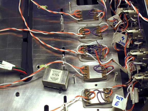

AR2 said:Here is how is connected on the Lundahls. I got them from Kevin at K&K audio and he was very helpfull and nice to deal with. Give him a call and he could help you a lot.

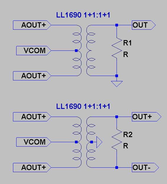

I have just read through the whole DCX-thread as I wanted to find if someone else had used transformers in and out. Found out that you did the right thing!
The AKM4393 is a voltage-out DAC but the LL1674 seems to be connected for some kind of current-out. With the primary center grounded, each side of the balanced out will see 33ohms DC load parallelled with the AC-load from the secondary!
I have read Kevins (K&K) explanation at their forum but I do not buy it as we are talking DC here. With +2,6VDC at the both of the DAC outputs and a current capability of 3,5mA there shouldn´t be much left in terms of AC-output level. The data sheet says min 1k DC connected. Ground-connecting shouldn´t anyway be needed as I see it. Without it both sides is at same potential and no DC current will flow. Have you tried with the ground lifted?
The AKM gives 4,8Vptp balanced out (if I understand it right) so a 1:1 (without CT to ground 😉 ) should be able to deliver 1,7Vrms into any typical power amp input-load.
Transformer should be the obvious choice when modding the DCX even if it also is the most costly. I have ordered LL1544A for mid+treble and LL1690 for low output. Will also use a 4+4:1+1 connected LL1674 (but for the input) that also serves as parafeed transformer for the presceding tube preamp. The tube pre is needed as the sensitivity at the transformer input will be just below 7Vrms.
You are right that you must treat current output and voltage output DAC differently.
The DAC chip in RAKK DAC is a current out and the K&K passive output board works flawlessly for it.
I found a schematic for a voltage DAC and I believe a 10K + 100 uF were connected from center tap to ground, with the secondaries either unloaded or 100k across the secondary.

It didn't work without ground. Ground has to be connected. I also remember that I had to monkey around with the ground as it didn't work exactly as it was on schematics, but do not take me by the word since it was long time ago. The fact is - there is O V DC at the output.
Depending of your amp - speaker situation after the Lundahls, you might be able to drive it without any line or pre amp. When you do it, it is such a great sound. I use that as a reference to compare anything else to. Typically my amps are without any caps in the line of signal. So it is as clean, straight and short as it is possible. I have tested various opamps, discrete caps and resistors after the DAC and nothing compares to Lundahls. Simple and works great.

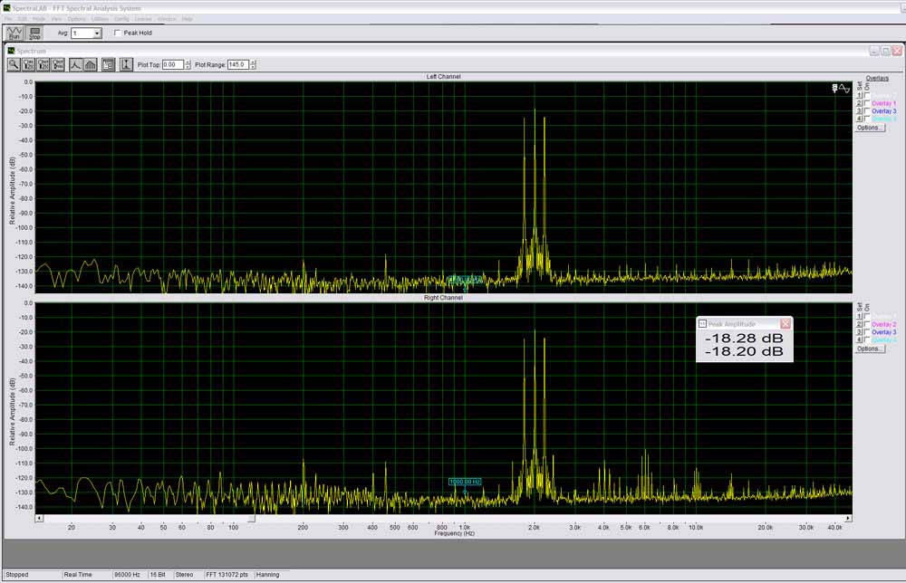

Here is the measurement done on stock DCX without any modifications - bottom and measurement on modded Lundahls output DCX - top graph. It is remarkably obvious difference.

CT output transformer
Think I got the CT question solved. If using a centertapped primary the tap should go to VCOM not to GND. VCOM is at the same potential as the differential outputs.
Found this now so obvious answer from Dave Davenport(Raleigh Audio) at K&Ks forum.
