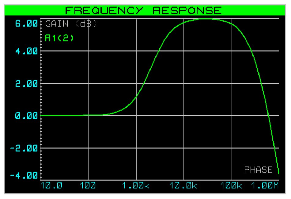

IMSTOOPID: Before I say anything I’d just like to make it clear that in no way did any aspect of the sound after the upgrade was ‘worse’.
From my small experience in modify equipment, the sound only seems to change slightly, such as improved detail. But with this mod the ‘tone’ of the DCX has changed. I guess because the analog section has been completely changed and as I don’t have another DCX so I can’t do an AB comparison. If I had to take a wild guess I would say it sounds less ‘forward/pushy’ because the ‘grain’ in the sound has been greatly reduced, so this would be noticeable on any of the mods that remove the original input/output section.
I now no longer use the analog input for my music listening because of the built-in preamp facilities in Jan’s kit and have moved to the digital input. The analog input will now only be used for AV use, where (to me) the sound quality is less critical.
From a technical point, I can give at least two reasons for the change in the analog input.
- In the stock situation, the analog input signals goes through 3 not-so-hot opamps. In my active mod, that trio has been replaced by a single very high performance fully balanced opamp (OPA1632);
- In the stock situation, Behringer slightly rolls UP the mid/high frequencies (up to +6dB at 20kHz) as shown in the simulator pic. I don't know why, possibly to improve the subjective 'presence'. For me it sounded a bit unnatural, though. My new analog input is ruler flat.
Jan Didden
Ok, this does explain why I had redo the crossover straight after getting the kit going and why I had problems balancing the bass amps with the original DCX.
The in stock situation also has some Cs in the output section (e.g. 220p || 2k32 at IC1B). I didn't do a simulation - just a guess: could be a kind of preemphasis (just do have some more bits & less noise in a range with usually lower levels).
This theory doesn't fit well to the obeserved balancing problems... hmmm...
