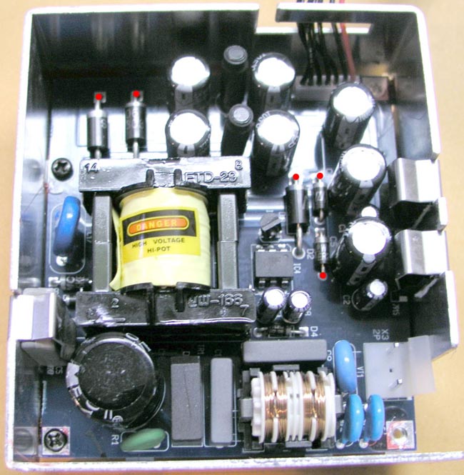

I'm currently developing an dedicated linear PSU for the DEQ/DCX which will replace the original PSU. I personally have a DEQ2496 and I'm looking for more details on the DCX. If a DCX owner can help?
I like to know the "working" voltage for the DCX inside the PSU in use with a close 95% use of the DSP board. To do this, you need to inject a signal on the input at 0dB et mesure voltages at the red points (see the inclosed pictures).
The dedicated board is 80 x 90 mm. The board will use 2 toroid transformers (2x9v or 2x7v, and 2x15v) or may be later a custom made transformer with all voltages. The size of these kind of transformer is 62x34mm. Can someone check if the board and the 2 transformers will fit in the DCX? (without the original PSU as well).
The board and the 2 transformers fit well in the DEQ2496.

This is the results of the Swedish jury(one of them)😉
Meters on RED,
14,83v
-15,10v
8,97v
0
0
5,00v
3,37v
Sorry bad pic,The RED line is 120mm,The GREEN is 140mm,The YELLOW is 40mm.So unless you/we find some trafos that are about 55mm large,there is either to move the DSP board or mount the trafos where the original PSU is and the new PSU board on the other side of the DSP board,any other solutions?🙂

A custom made toroid will be the best but it's expensive for one unit or two.
It seems that 2x9v will be too high. The LM7505 on the DSP board will need a dissipator. I'll try tomorrow with a 2x6v transformer (2x7v do not exist in 15va). I'm pretty sure that the board will work with 2x6v but the LM7805 on the DSP board may be not. Too low end regulator.

Can't you work around a transformer of Amveco? Look for type 70050 at there webpage.

Maybee make the PCB larger and have the trafos on it,you should gain some space by removing J1 and J2.Just a suggestion.🙂Look for type 70050 at there webpage.
