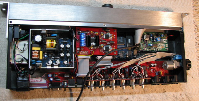

Hi DCX owners and groupies. I want to share my experience with the assemblage of the Selectronic I/O and analogue supply boards. Please excuse my basic English, it is my third language. My comments are for the French version of the documentation.
A little bit of background so you can better judge my comments. I would qualify myself as an intermediate DIY guy but do not know a lot about modern electronics. I have built my own tube SET amplifiers and tweaked some amplifiers and CDP. I've also tweaked my DCX.
I installed a Tentlabs clock, some BG capacitors in the power supply and replaced DAC's decoupling caps with os-con ones. I`ve installed a passive output mod à la T. Martin with first order filter (r = 900 ohm) and DC blocking audiophile caps. The last tweak was a 6x10 k gang Alps potentiometer. Of course all these tweaks have improved the sound a lot, but you know this is a hobby….
I bought the Selectronic boards because I wanted the I/O tweaks to look more professional and maybe sound better with the new analogue PS. I hoped also to obtain some gain on the signal strength due to the summing of both halves of the signal.
As you know the Selectronic boards are not cheap. I paid around 200 euros including shipping to Canada. The PCB seems to be of good quality but I'm not an expert. The kit is nicely packed and comes with some documentation. Components are of good quality ex 1% resistors, mica capacitors, BB opamps etc. Some parts were missing like cables and adhesive pads (minor but annoying).
This is my first experience with a kit so I cannot compare but I must say that though I assembled it I didn't liked "the making off".
This kit is not for beginners. You have to know at least the basic of electronics, the parts identification, soldering (opamps!) and be rather a wise guy because you have to handle the lack of clear instructions.
The main problem is the poor documentation. I will have a lot to say but will limit myself to some examples:
the list of components furnished is for the complete kit (with analogue inputs) so it is impossible to verify if the kit is complete if ones bought the basic version;
the schematic is not supplied;
the implementation scheme is supplied but only the numbers of the parts are given ex R107; the value are only written in the parts list; BTW the PS board is supplied with the opposite the values are given on the implementation drawing, confusing;
the parts numbers are not printed on the PCB, the right place has to be found following the pictures (color) or the implementation scheme, it is very painful to find the right position at the beginning and I made some mistakes (I love to desolder !). Some dozens of holes on the PCB are not used. Not easy.
despite the two voltage regulators used on the board no instructions are given for some voltage verification on finished board. You have to solder and pray!
no information about the output voltage levels, input or output impedances, not a word of the DC offset. There is an option with BG blocking caps but nothing is explained.
What I disliked most was the feeling of being treated like a semi intelligent monkey. You have to follow the pictures and don't have the right to know what you are doing. The reverse engineering is of course possible but I would much prefer to be fully informed for 200 euros! You follow me guys: I'm not saying that it is a bad product but I was expecting more.
I just finished the assemblage and haven't installed the boards in the DCX yet. I will post a follow-up as soon as the boards are functional.

Selectronic mod, part 2, conclusion
This is the part 2 as posted on yahoo group forum:
Hello anybody. After two days of intense work I finished the implementation of the Selectronic cards – I/O and analogue PS. A lot work to do since the DCX must be taken completely to pieces. I insist: this is not a beginner kit. I had some apprehensions (see my previous post) about the rightness of my assemblage since it is not easy to verify it without installing it in the DCX.
I put everything in the chassis, soldered the last supply connections and fired the power switch – not connected to the amps of course. No explosion, no smoke, no noise, the only apparent glitch: the C input shows a full strength signal. I made some checks and one of the decoupling capacitors was soldered in the wrong position (exactly like on the photo, thanks Selectronic for the clear instructions !), both legs were connected to ground. I switched it but it hasn't changed anything. I will have to take the whole card out to verify but don't know where to start.
Despite this bug I decided to install it in my system. First I had to modify my cables which were XLR to RCA since the card uses RCA connectors. I tried first on the midband amplifier and it worked, the sound came from the speakers. In fact all 6 channels worked. Alleluia ;-), it was Easter after all.
I know that everyone is dying to hear about the sound and can not retain myself:
THIS IS A MAJOR UPGRADE. The sound is very good, much better than I expected. All of you know that very often the tweaks or even new components make some changes which are on the threshold of the perception and how the "happy father" or placebo syndromes can be powerful. But I swear the difference is huge compared to stock unit (I have one) and my previously tweaked one with passive but single ended mod. There is more of everything in the sound. The biggest improvement is RESOLUTION. Now the DCX really sounds like a very good DAC. The sound is very vivid, live like (I use high efficiency horns). Improvements are particularly clear I the mids (voices) and highs maybe less in the bass (this can be an issue of impedance matching with my amplifier).
I cannot tell the part due to the PS but both the I/O card and the PS should be used together.
Congratulation to the Selectronic team and last but not least the enthusiastic participation of Thierry Martin who started these mods. Thanks guys.
Chris
PS : Somebody has an idea what is the problem with the C input? BTW I discovered another one the RS 485 link seems not work.
Chris

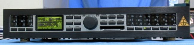

- Digital Line Level
- Behringer DCX2496 digital X-over
