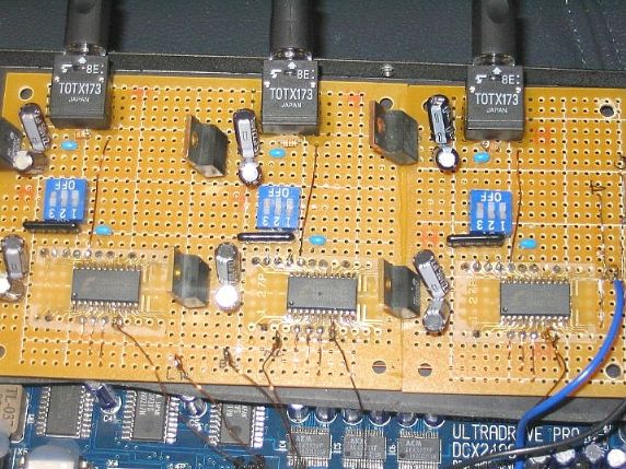

I'd still like to see someone offer to put 3 SPDIF outputs onto the Behringer units. I'd probably drop the PC at that point.
Something like this you are looking for?
Sorry, I can't for the life of me remember where I copyed it from. I do believe it was a French site. Someone that can help here?

Reading trough Tanto's thread I'm thinking there are two different path one can go with a digital upgrade for the DCX.
http://www.diyaudio.com/forums/showthread.php?s=&threadid=36252
The CS8404 Tanto use is a rather expensive chip. If our implementation is not for digital amp's it would make sense just to build in better DAC chips rather then use three external DAC's . If the DCX main board is capable of driving 3 x CS8404 in parallel with the internal DAC's it might also be capable driving 3 parallel DAC's inside the DCX?
As I understand Tanto configuration's he set the CS8404 up for I2S mode. There are several threads dealing with the task of overcome S/PDIF's limitation. One approach is to interface external DAC direcly to the I2S 'bus'. I should think that one need to think trough how to implement synchronized clock if one like to use external DAC's? The I2S approach would take care of that.

Hi Frank,
The 110 ohms you mentioned is there for proper cable termination and if you take it out you may have higher level but worse signal (bad square waves, ringing, jitter etc.).
My own solution was to built a small S/PDIF to AES/EBU converter because the Behringer's CS8420 expects AES/EBU format, it works often with S/PDIF but that's just luck.
See the yahoo DCX2496 group for schematic details and a small PCB.
Jan Didden

Hello guys,
Here's a modification for converting the digital input to SP/DIF SPDIF conversion
It's from my DCX296 website which by the way is being translated into english.
Lot of work indeed : http://www.dcx2496.fr
TM
