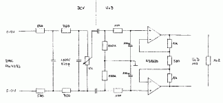

Hi Janneman,
Yes it does. Draw it. This is elementary and important to understand!
Assume two sine waves. At t=0 both are zero, midpoint is zero.
At t= 90 degrees, one is +maxV, the other is -maxV. Midpoint is zero. Midpoint is ALWAYS zero.
this is so fundamental I could not believe I had said the opposite.
However, I went back to post 844 to check the context of what I had said.
Extracting that sentence from the context of the post, the preceeding discussion and schematic completely changes the meaning of what I was referring to.
Yes, I could have worded it more carefully to ensure confusion did not exist in the minds of any reader.
BUT, I stand by the message I had intended. The schematic shows the pot and downstream unbalanced and upstream balanced. The pot uses one end as reference and wiper as tapping point. With the phase inversion across the whole pot and the wiper at midpoint then the down stream does NOT see zero signal. There is NOT cancellation of the balanced signal at midpoint.
Explain where I have gone wrong.
I do wish you had come back sooner, as I fear a number of readers may have been misled if I am wrong.

Hi Janneman, this is so fundamental I could not believe I had said the opposite.[snip]
I knew you knew, and that there was some kind of confusion.
Sorry I didn't notice it earlier.
My point was that in the lower half output part the opamp ALWAYS gets the max neg phase from the DAC output, while ONLY the upper part opamp gets the pot output fed. And that pot output varies between max upper phase through 0 to max lower phase. So, at the output you get some kind of a varying signal between max sum and zero, but is a) totally out of whack with the expected pot setting and b) not have the advantages of the balanced signal wrt supressing cm non-linearity and noise.
Jan Didden
Hi Janneman,
sorry, I do not understand.
Can you try explaining that again?
But, have a look at the schematic in post827.
The right hand side (unbalanced, even though it's made to look balanced) is measuring and amplifying the voltage across part of the pot.
AndrewT said:
Hi Janneman,
I am talking about this:
The input to the lower opamp is always max, independent of the pot setting.
Jan Didden

Hi Janneman,
we are looking at the same schematic.
Now explain.
why this should apply?
The differantial amp measures the voltage across it's inputs and amplifies it.
One measuring point us at the lower end of the pot.
The other measuring end is on the wiper.
The voltage difference between the two points is amplified. BUT it is not balanced, the lower measuring point is offset from the ground reference. In fact the lower end has become the reference.
The voltage at the top referred to ground is +V and the voltage at the bottom referred to ground is -V but when the reference is moved from ground to the lower end, their voltages become 0 and 2V and halfway up becomes V. NOT 0V.
Now, approaching from a different direction.
If the source side were referenced to the SAME ground as the amplifying side then all is different. It closer matches what you are reading into the schematic.
But in a balanced system one must assume the two signal poles are NOT referenced to ground. That's what makes balanced so good at rejecting spurious signals. Just the wanted differential signal is passed on without reference to the source ground. The schematic as posted shows NO GROUND REFERENCE. But the amplifying end does show a ground reference because it is an electronically balanced input and not a true balanced and galvanically isolated input.

PS: The former (post 826) circuit (different pot) you are just talking about might cause some CMRR problem at the instrumental amp.
I read your last posts based on the circuit shown in post 826 more carefully. For my understanding input and output are galvanically isolated due to the two AC coupling caps, as long as you do not connect grounds.
But in real life there is a common main and therefore you might get some noise from the PSUs. So connecting the grounds via the shield of the cable would result in a signal (seen by the opamps) which is identical to the negative output of the DAC (pot setting 0). The difference between the two inputs of the opamps (pot setting 0) is 0 which should result in a 0 output of the opamps. But unfortunately the CMRR of an opamp is not infinite.
Between the low end of the pot and the wiper there is always a 180° phase inverted signal independent of pot setting.
