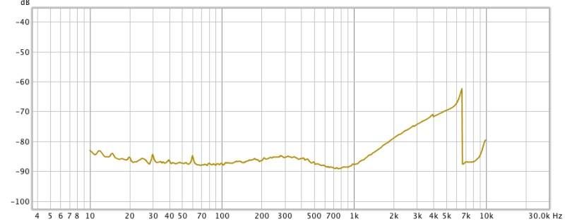

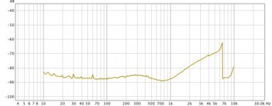

This REW THD plot was sitting around. Not sure what where or what but "-80" is ".1%" and I have no idea about that treble bump..
After maybe 12 yrs with the unit and hundreds of measurements of all kinds and with all kinds more gear besides the DSP in the measurement loop, my impression is that the distortion is comparable to a good amp or better.

I think -80 is actually 0.01%

Is this the DCX2496 distortion spectrum? He’s disgusting, something’s not right here. More similar to the distortion spectrum of cheap class D amplifiers (-62dB at 6.5kHz)

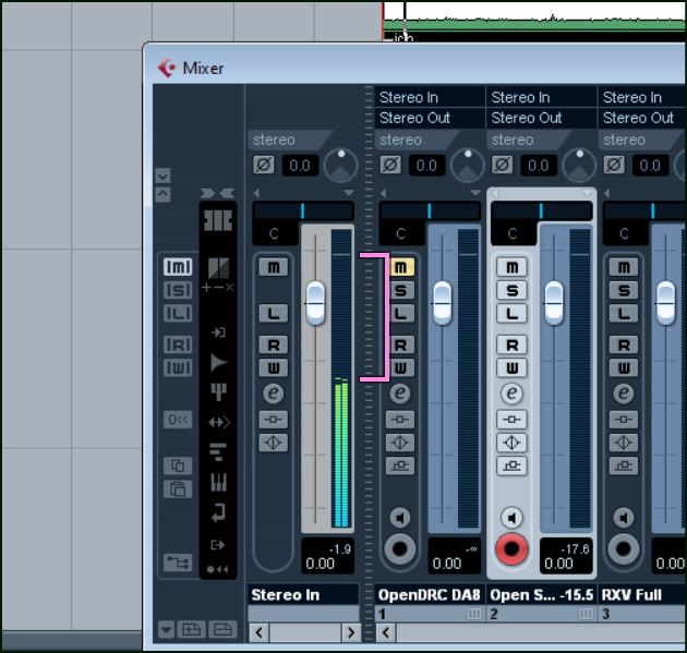

I recorded the difference between halved digital vol, and rxv rds 800 (analog) equivalent, as well as the difference full digital and full digital through analog volume on full tap.

are these measurements done with digital input?
anlog input add another AD conversion worsening the figures

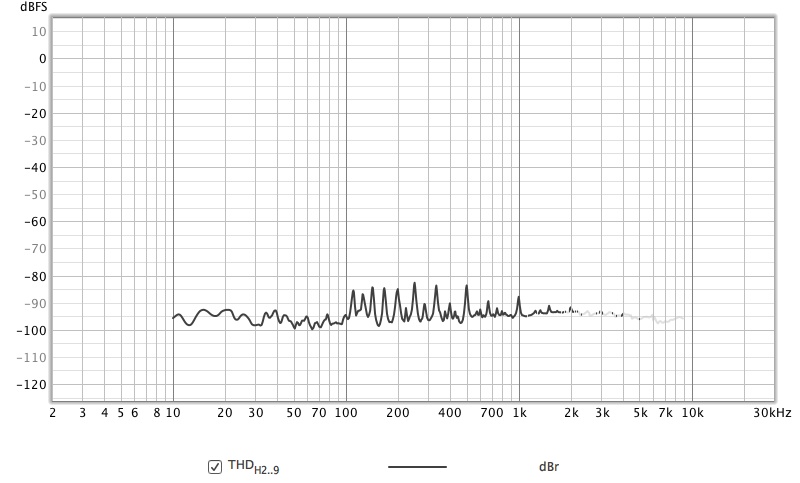

In this thread, one hears an awful lot of criticism of the DCX2496. Here are REW plots I made 5 minutes ago.
About 2-3 lamps on the input and output displays so not pushing to get the most S/N. And all kinds of vintage gear included in the loop adding to the THD (such as the DAC I bought for $4 at the Salvation Army store 15 yrs ago). But I am going from USB to S/PDIF (coax) with a Breeze converter thus skipping a stage or two that others might encounter before and interior to the DCX.
High freq is as high as REW goes and THD about the same as residual noise level.
Not bad, eh.
Enjoy.

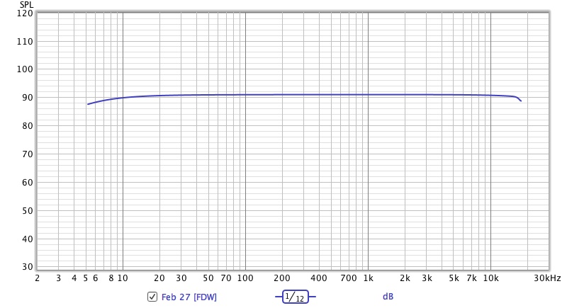

To test, like I did in previous post, all you need is REW (donate if your conscience says so) and possibly a DAC, depending on your computer's inputs and outputs. No mic used. All electric.
If you want to move beyond faith and the possibility of self-deception, try REW.
Glad to hear your re-modeling didn't make things sound better or worse. But for all your effort, did it reduce the THD below the astonishingly low level I documented for the stock DCX2496 (using AES input) in my post? Within 1dB from 5 to 25kHz and -85dB (and would have been better with better test circuit).
