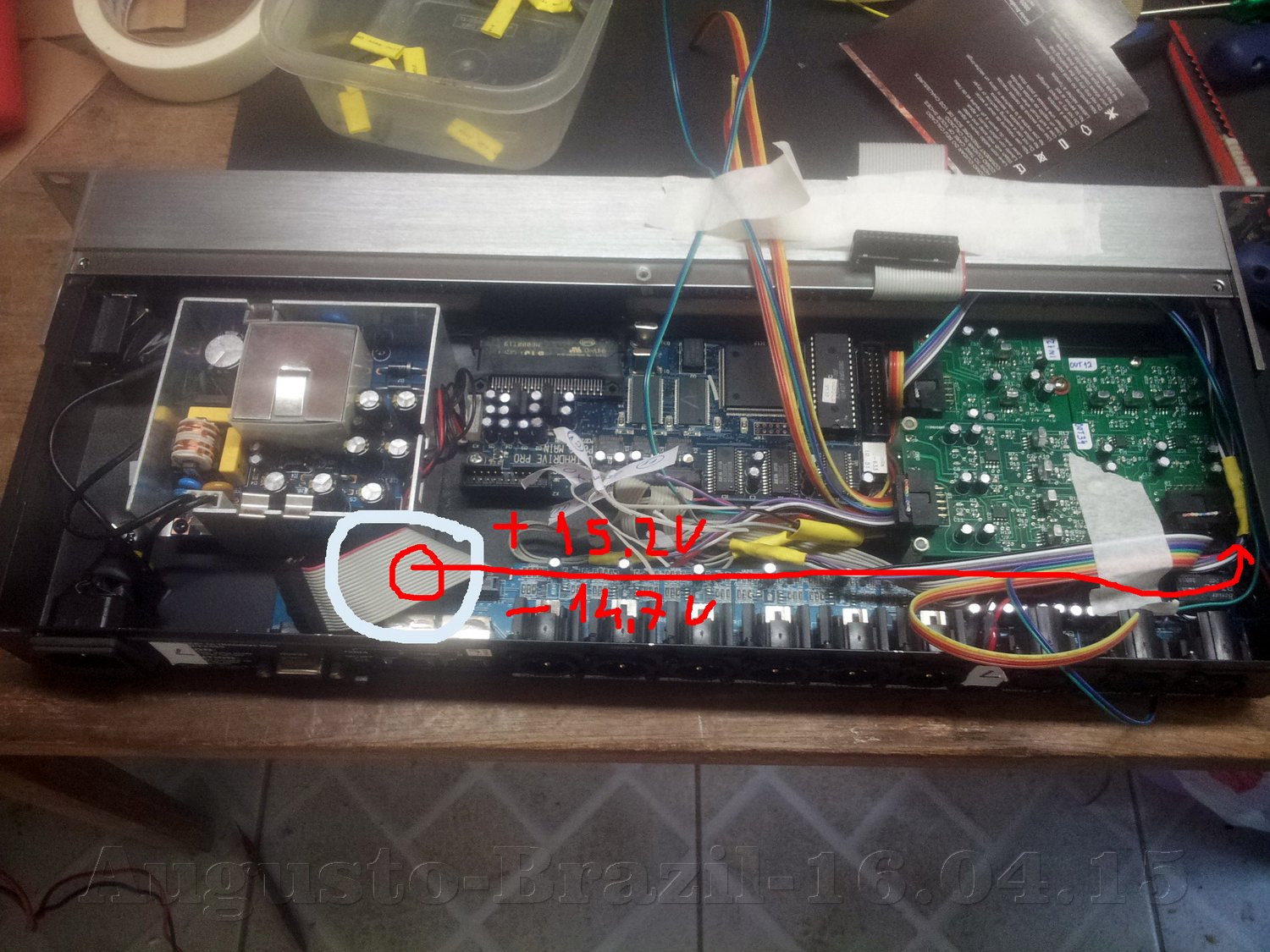

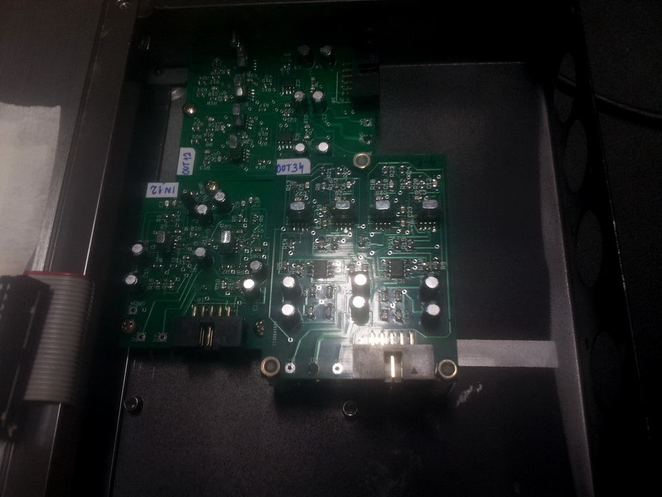

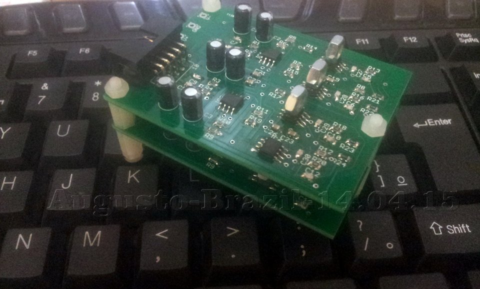

Hi all: I bought and made mods from Behringer Mods - Upgrade DEQ2496, DCX2496, SRC2496, on two DCX2496 units, the result was good compared to the original NJM4580 IC. At the time the seller Mr. Simon Ashton claimed to be AD797, LM4562 and LME49724 ICs. However on delivery a heatsink fell from one of them and I did not find the numbering of the expensive AD797 IC . At the time, claimed to have to scrape the chip to be able to glue a nut, such as heat sink. Well, the assistance provided was regular but in the end it resulted in a sort of noise, a squeak in the speakers, which increased and slowed, like a small hiss. After questioning Mr. Ashton several times, he lost his temper and told me to settle it myself. Unfortunately that's not what a buyer expects from a manufacturer. I hope others are luckier. This is my testimony. Thank you.

Sorry your project was so troublesome - I don't remember these 'nuts on top' of the ICs before (as per post 4213) - was this something special you had installed?
The first upgrade unit I attempted was a bit awkward as I reversed the output order but still relatively simple to fix. The second unit was a breeze and completed in about 4 hours and there have been no problems about reliability or performance since - no 'nuts' on the ICs

Dear jameshillj: The screw nuts as dip8 sinks were placed by developer/ salesman Mr. Ashton. On the trip from England to Brazil must have come loose. But it seems to be a feature to avoid overheat in ICs dip8. I reaffirm that the result was good: only this variable hiss bothers you when you listen close to the speakers and without music, of course. Maybe it can produce some distortion. I did not perform an oscilloscope test.
