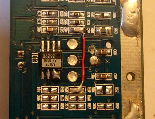

Improved digital input stage for the Behringer DCX2496
Hi folks out there,
I have developed a new and much better digital input stage for the DCX2496.
Schematics, PCB and photos included.
http://freerider.dyndns.org/anlage/Behringer-Input-Stage-E.htm
The Server is up from 8AM to 10PM german time.
Have fun!!

Re: Improved digital input stage for the Behringer DCX2496
Awesome Oehlrich,
and thank you for sharing this with us.
Does this mod eliminates needs for clock mod in order to lower jitter?
Also what is the benefit of higher sampling rate when the rest of the circuitry doesn't support that (D/A converters are 96KHz)?
It would be great to have group buy for the circuit boards.
Ar2

Re: Re: Improved digital input stage for the Behringer DCX2496
The benefit of higher input sample rate is that I now can listen to all output from my modded pioneer player(http://freerider.dyndns.org/anlage/HiresAudio.htm). Playing hires DVD-A it outputs 192kHz. Before the mod no chance to listen to it. Currently there is work in progress for a PCB for that Pioneer mod.
The mod only prevents incoming jitter from the source or the wire to be mixed in the audio signal. To get best output quality a masterclock could improove the jitter quality at the output. I did not test it until now but some people say it's worth the effort....AR2 said:
Ar2
