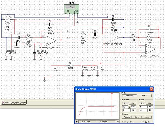

Hi petervv,
Some time ago I made a simulation using Microcap of the input stage of the DCX, and found that there was a build-in treble preemphasis.
It is true that this was my first Pspice simulation, so I may be wrong.
Have you made a frequency measurement after the mod?.
Regards
Miguel mentero
Regards
Miguel mentero

re: Pspice simulation
hi Miguel,
I haven't checked the schematic for this, but it would surprise me if there was a treble preemphasis buildt in, I can't think of any reason doing so.
No I haven't, I only use the analog input for tuner en turntable, the tuner (Pioneer 8500II) sounds better than ever, most of my 45's will never sound good 🙂
regards, Peter
hi Miguel,
regards, Peter

I got the same behauvior simulating with Electronic workbench. When connected as the DCX schematic, a 5db peak is present with it's centerpoint at about 5khz (if I remember correctly)....
// Lyckman
// Lyckman
Regarding a treble pre-emphasis: I think you fellas need to recheck your simulations.
I did a simulation a long time ago when the schematics first became available and I see no pre-emphasis....only filtering above and below the audio band and DC blocking. I later confirmed this with actual measurements and everything looked as expected.
Davey.
Davey.
Well.. Maybe I got something wrong. I double checked the circuit and could not find any errors. The frequency of the emphasis changes when changing the values of the components in the bias section. Trying to attach a screenshot.
// Lyckman
// Lyckman
Hi Lyckman,
do me a favour (if easy), delete C4 and R5 and retry.
Ill try to find my simulation file tomorrow.
Miguel mentero
Miguel mentero
Fredrik,
Yes, I stand corrected. My simulation also shows this...(I had the wrong component value entered for C4.)
However, an actual in/out transfer function measurement (DCX programmed flat) doesn't show this shelved response. There must be an equivalent "de-emphasis" somewhere along the way that counters it. I took a quick look at the remaining analog circuitry and I don't see it. Maybe something in the DSP?
Davey.
Davey.
Filter caps removed and as suspected, the response is now flat in the sim. 🙂
This is wierd. Why would one do an analog preemphasis and then (probably) a digital de-emphasis in the DSP? And further, you'll need a different "program" in the DSP when using the digital input instead (eg no filter).
I've done some measurements some time ago, bypassing the input stage with analog signal straight to the ADC's, but I can't remember that I noticed anything similar to what the schematics is applying. (one should notice a 5dB loss of the signal above 5khz, right 😉 )
Could the schematics be wrong? Can anyone confirm the values on the components? Maybe you accidently inserted the correct values for the cap(s) in your sim, davey? 😀
