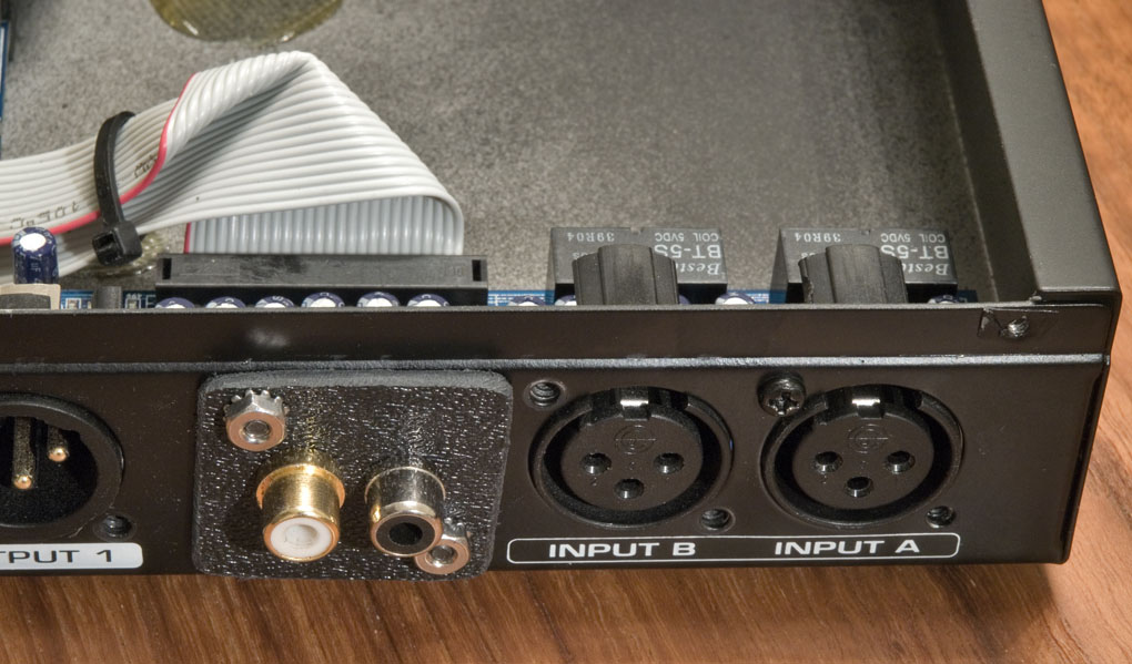

progress on adding my spdif-out board.

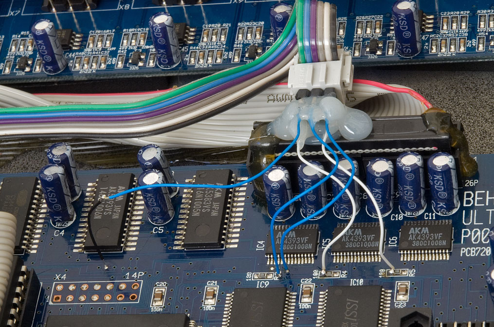

I removed one of the input XLR's to make room for a pair of rca's. those will be 4 channels worth; I will not do 6 channels as its too much work and I only really need 4 ;)
the i2s wires are in place and strain-relieved by some hot-melt glue and a 2x3 header. a ribbon and IDC connector will go from there to the actual transmitter board.
had to stop there as this was all I could get done today. I put things back together and the unit still functions, so at least no harm done yet ;)
tomorrow I'll do the perf board and actually wire it up.

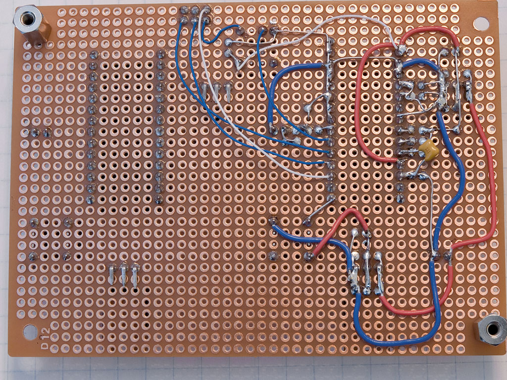

getting closer...
perf board mounted to chassis (I hate drilling but it had to be done) with stand-offs. its in securely, now. easy to remove for service, too.
i2s cable is made (I love IDC cables. its a joy to make these.)
spdif-out cables were some junk 75ohm composite tv wiring from 'yellow to yellow' patch cords. nothing high grade but better than bare wire, to be sure.
left to be done: find a clean enough 5v and ground tap and then do some testing.

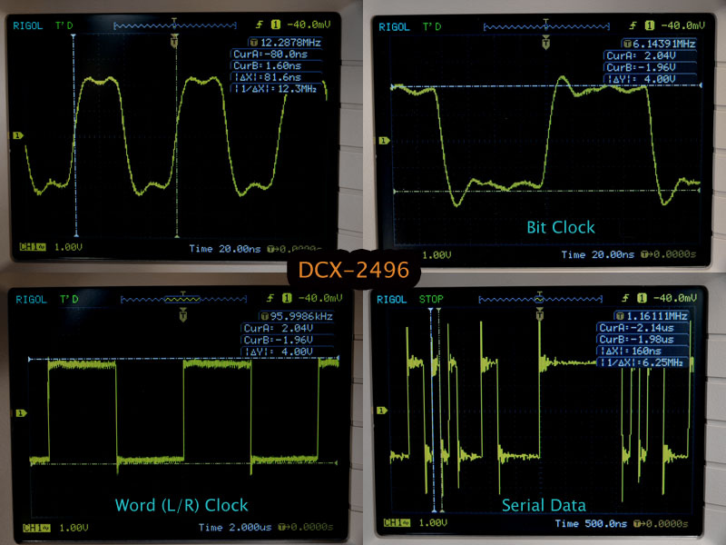

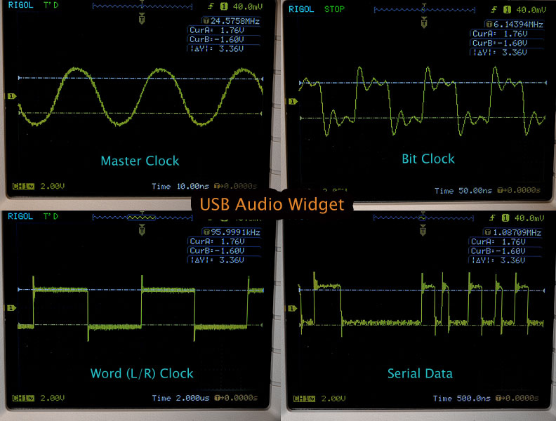

partial success (the perf board does work) but its not working with the behringer yet.
I've verified the wolfson perf board by connecting its i2s to the usb audio widget, where I have the 4 i2s lines ready and easy to tap into. things work fine there, with this new board.
but when installed in the behringer, I'm not getting audio data out of the spdif transmitter. I see spdif lock-on via my dac led but only white noise comes out.
lr-clock is seen at 96khz via my scope and counter, so I know I have that line right. I'm not so sure that the master clock is clean enough to be dragged across inches of wire, though. that might be what's stopping this from working. any comments or ideas?
I have more info (and some scope pics to upload of the waveforms, later on).
short summary: I compared a known good working config for the wolfson (96k audio file played over the 'usb audio widget') to the lines on the behringer (which is always 96k, at the output). result: the audio widget puts out 24mhz (and some fraction; the right number) but the behringer puts out 12.something (which is exactly half of what the wolfson needs).
I think the hardware mode (that I am running wolfson at) only wants to see the higher master clock freq, not a lower one. 12.something is too low and it wants 24.something. I know that 24.something works when I connect my new perf board setup to the audio widget and steal its i2s lines. music plays perfectly and glitch-free (I ran this mode for a few hours today to verify my wm8805 perf board build). and so, I know my build is ok and the hardware config of the 8805 is ok. the audio widget works with it and my dacs decode the spdif-out just fine.
the voltage levels even look more or less ok for i2s. and all the lines seem to be 'right' in that wordclock is 96k and bitclock is a few mhz and a constant wave and data is about bitclock speed but variable wave. master clock is the fastest but only 12.something.
so, this won't work just by hooking things up, as-is. at least not with this spdif transmitter chip.
I might look into doubling the 12.something and feeding that to the wolfsons. or I could look into another spdif transmitter chip, but that seems a bit drastic to me.
both devices shown with rigol scope captures.
the data and bit and wordclocks all look right! ignoring probing sloppiness and actual shape quality, for now.
the only thing that is 'wrong' is the master clock. its half of what the wolfson wants in order to work, at least in pure hardware mode for the 8805 chip.

looking further at the wm8805 datasheet, in hardware mode (what I'm using, since its controller-less) the mclk MUST be 256 * Fs. fs = 96000 and so that's 24mhz roughly that the master clock has to be in. this fully explains why things 'didnt work' direct from the behringer. the dcx puts out 128Fs and not 256Fs on ITS master clock. bingo. akm chips work that way but the wolfson does not (again, in hw-mode).
so, I either have to find somewhere on the dcx that is already 256Fs or I have to clock-double to make use of this wolfson chip. or try another spdif transmitter chip.

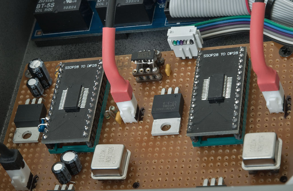

Actually there is a 24.576 MHz oscillator inside DCX2496.
do you have a handy tap location for this clock? I'm willing to try it.
update: I see clk12 and I guess that's the 12mhz clock that is there on master clock for the dacs. but I also see clk24! that must be what you are referring to? ic20b which is a 74hcu04 - that is doing some clock doubling already for me, it seems.
I'll see if I can find it and tap into it, IF that's the right one. thanks ;)
SUCCESS!

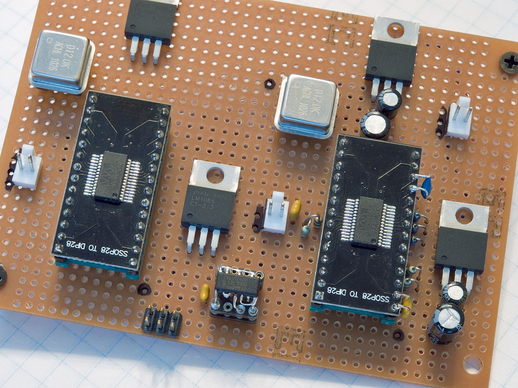

yes, the 24.576 line is truly 24.576. just what the doctor ordered ;)
photos of where the new tap location is for the master clock and also a level matching chip on my perf board (dip8 socket with 'flying soic' cmos schmitt trigger, running on 3.3v and outputing 3.3v but accepting the 5v level 24mhz clock input).
with all this in place, the wolfsons are now putting out spdif to my outboard dacs!
I am noticing some drop-outs every now and then, so the wiring probably still needs cleaning up. I might try skipping the ribbon and handling each line by itself via small coax (rg174 or equiv) runs.
but the basic idea IS now working!

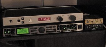

here's my system, together, with two DACs handling the HP/LP split.
notice that the two small DACs on the right have both of their status LEDs green. they are truly getting 24/96 audio from the output of the behringer!
from the 2 DACs, its as it was before, going into my cirrus 8ch vol control system and then out to a pair of stereo amps.
its playing now ;)

photos of the working board (half wired).
being only half wired (one transmitter, only) makes the wiring a bit easier to follow, for those that may want to.
after I took this photo, I finished the board up and its now working with all 4 channels active.
the wiring was not really that bad. of course, a green board would be better... ;)
