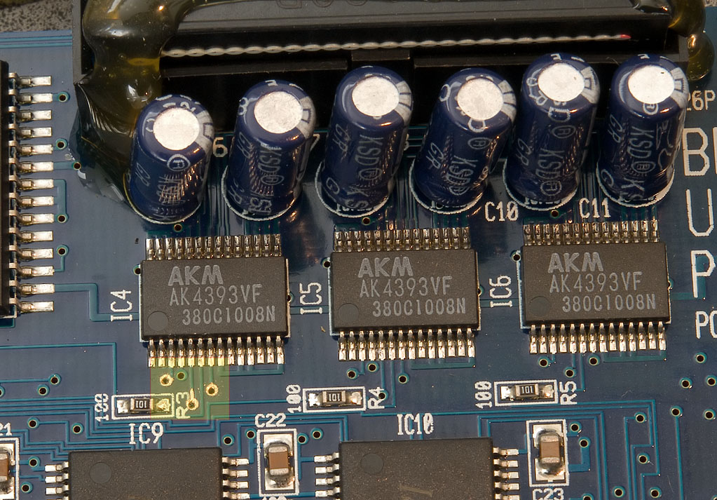

sorry if this has already been asked (searches don't find this info).
what logic level (voltage) is i2s run at, in the dcx2496? is it 3.3v or 5v?
I'm about to try to interface some wolfson wm8805 spdif tx chips by tapping into the i2s lines on the behringer. but it would be nice to know that its already 3.3v (?)
3.3V. The ADC and DAC in the DCX2496 all have 3.3V on their Vd pins.sorry if this has already been asked (searches don't find this info).

The DCX2496 is a mixed 3.3V and 5V design but the link between DSP and ADC/DACs is 3.3V only.
Is there a certain reason for converting onboard I2S to S/PDIF?
yes! I want to run my own choice of dacs as the output stage. many people prefer to mod the analog chain on the dcx's output but I'd like to go all digital and have the box just run spdif-in and spdif-outs.
I'm planning on using a chip I've already worked with, the wm8805. I've been able to hack a chip into the audio widget and that's been reliably converting i2s to spdif. my audio widget is now just a usb/spdif box at up to 24/192.
This would need a sample rate conversion (SRC) and a reclocking on the destination side of the S/PDIF line similar to the digital input (CS8420) of the DCX. This will cause a decrease of sonical performance!
I'm not sure I follow this. no src is needed. the data is 24/96 as it hits the local set of 3 dacs onboard. all I'm doing is taking the 24/96 data and skipping the AK dacs and sending it to 2 or 3 wolfson transmitter chips.

I think all the kits of boards that were done years ago are all sold out, so I'm going to try to revisit this idea but with 8805 chips instead of the cirrus ones.
I'm hoping I can use the 3 clocks as-is. I know lrclock and bitclock are 'fine' but I'm not 100% sure if I can just feed the onboard mclock to the wolfson. I'll find out really soon, though, before I build too much.
also, this is where someone else did the same mod as I'm planning:
http://www.diyaudio.com/forums/digital-line-level/36252-dcx2496-mod-digital-out-x-3-a.html

well, I'm going to try and see for myself, I guess. I've located the 3 holes for the 3 clocks that I'll need. the 3 smd resistors are the 3 data lines.
I'm still not understanding what you are trying to warn me about. the data is already digital and all I'm doing is placing an spdif transmitter and receiver pair in between the 2 ends of i2s. same as any spdif transport would be!
I understand that i2s clock (at least one clock, depending on the technology used in the spdif receiver end of things) can be critical and if not handled well, it can add jitter. I'll do my best to try to treat those lines carefully in my mod. not sure what else I can do.
I've always believed that the transmitted jitter (introduced by the stage where you have i2s as an input and spdif as an output) can be attenuated at the receiving end by buffering and reclocking. we both agree in this and any dac I'll use will have a good enough input receiver section, including buffering+reclocking.
the inherent jitter that is already in the signal at the place where we pick up i2s traces can't be attenuated; that will be what we have to live with (even the analog guys who use the onboard dacs can't attenuate this built-in jitter). so that's a non-issue in this mod.
anyway, I'll try and see if this gets me acceptable analog results at the output of the dacs that I plan to use. I'll do some rmaa testing (maybe others if I can get access to better test gear) and see if the end to end is as bad as you think it will be. I just don't agree that this is bound for failure, but I'll find out once its built 😉
