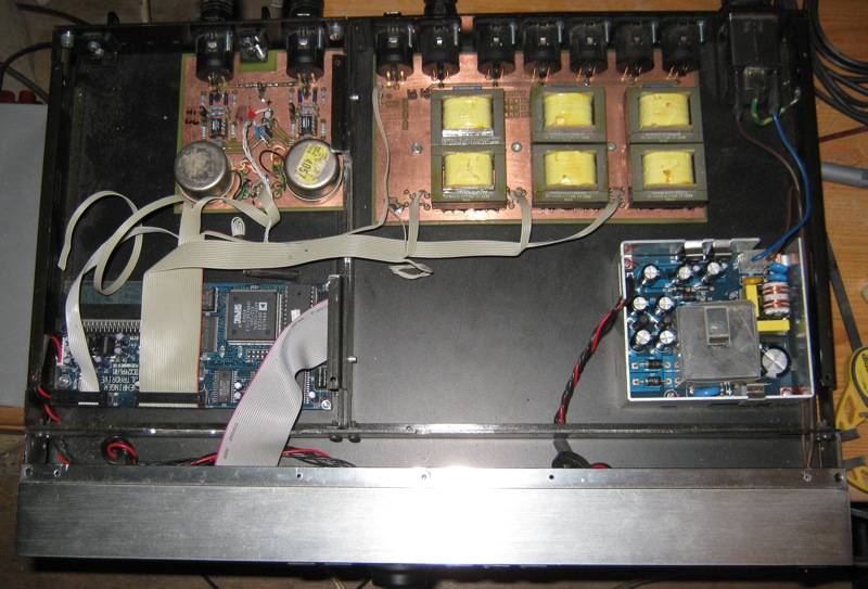

Nope. If you're using it with domestic kit, the most important upgrade is the inputs and outputs, (inputs not so much if you're using digital in).
Here's my version with "found" traffos and transplanted into a bigger box:
So the outputs it is then. I see you've got transformers, are they really better than caps? I kind of like the sound of Wima MKP polypropylene caps but have not heard output transformers in comparison.
