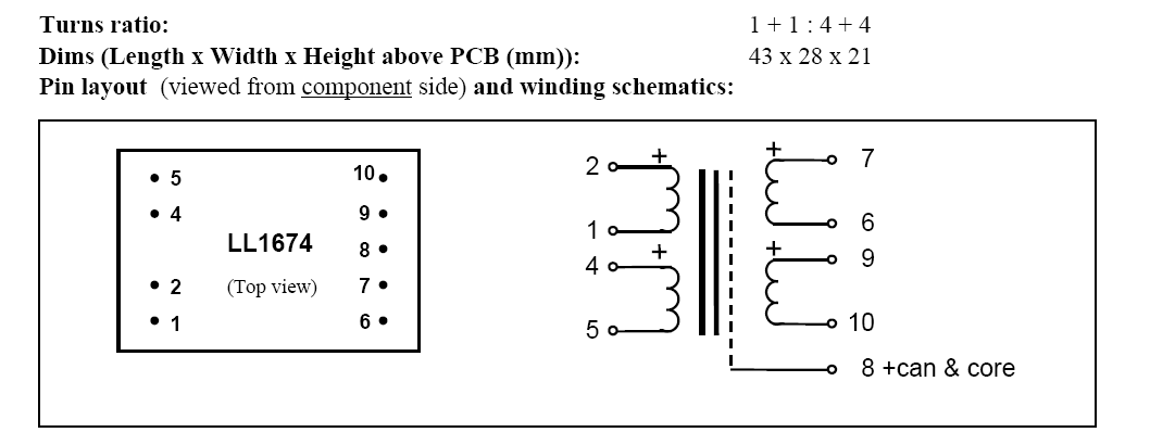

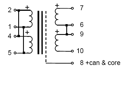

Vlad - repetitive mind-slip you're making is - your Lundahl xformers are connected 1:8 , not 1:4

Nope, nope. That transformer could only be used as 1:2 or 1:4. I have been using it as 1:2 before, and now is 1:4

look - "1" - from datasheet : 1+1 : 4+4
and look "new wiring" ... at least I drew that ........and I hope that you connected them as drawn
only in that way we have enough gain for your needs , and we can avoid active gain stage

Yes, connected as planned. See schematic above, few posts. Measured last night, gain 22.6 dB.
where is that "scratchinghead" smiley .....
from where we are getting that difference in gain - from 8 to 13,48 x ?
