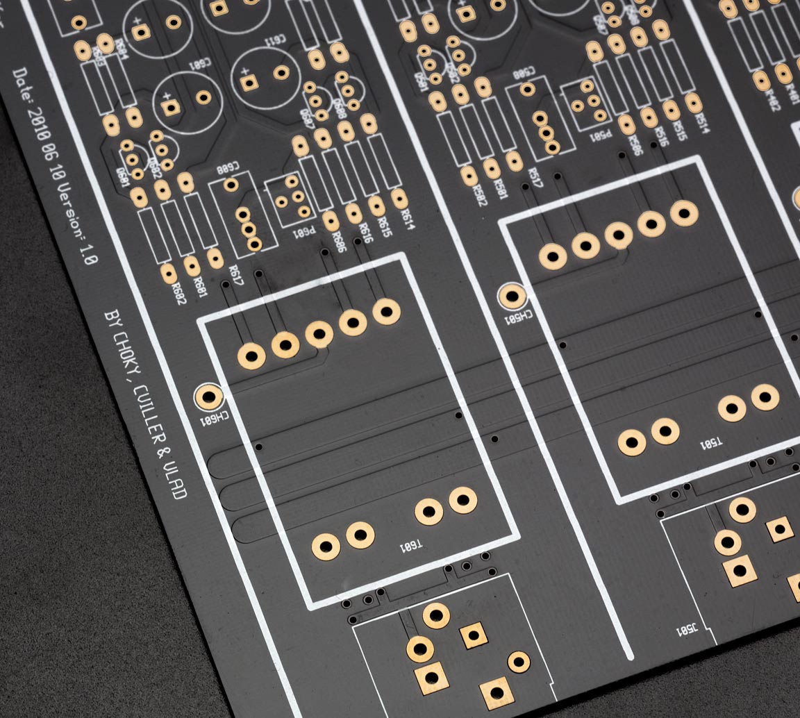

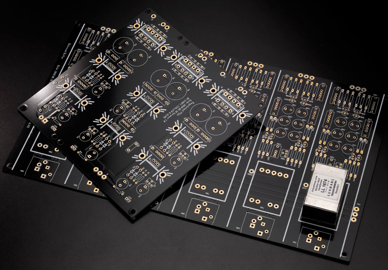

A few months ago I announced that I will be making PC boards that will hold Lundahl transformers and balanced B1 jFet buffers for balanced output mod from my modified DCX2496. I was tired of having everything point to point and wanted to make it all nicer. Also I did not have buffers, and with the help of my friend Choky, we came to the design that I have published here before. Than My another friend Christian came into the help and he did the PC board design. I sent it to China, waited about 2.5 months, and miracle! Boards arrived today. Here they are in all their glory. They are stunning, black with gold plating!
There is one more board, that I did not shoot and that one will carry output XLRs, RCAs and switches for conversion from balanced to single ended. Regulators are double regulation, dual supply, and third channel is for +5 V supply for my relay volume control that will be housed together in the case with buffers and regulators. Buffers boards are 6 balanced channels, with cap multipliers.I will post my progress. I am supper excited to complete this project!
