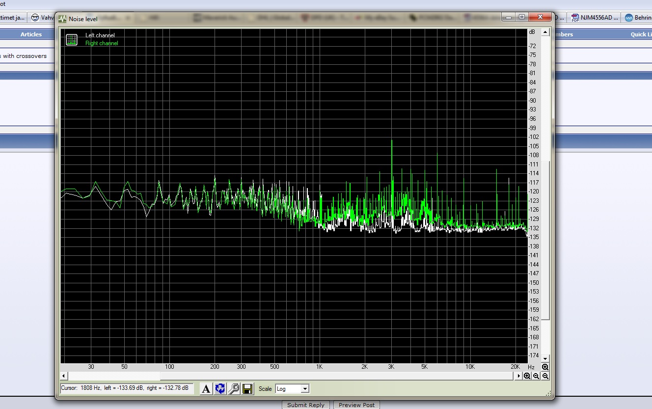

I have measured DCX with RMAA using E-MU 0404 PCI sound card (DAC = AK4395). Result were very good when comparing to E-MU. I tested it with two 1m (3,3 feet) long good RCA cables.
For some reason I always get 10dB worse Noise level with everything (incl: E-MU 0404, E-MU 1212M, E-MU 1616). I have tested all these cards and compared my result to the various test that are on the net, and always the same. With my setup noine of the cards don't achieve the same values as they have achieved in other valid tests. Maybe the PSU and Graphics card inside the PC that are very near the sound cards tend drop the DR and raise noise. There is an unexplained peak with both DCX and EMU in 3kHz, although DCX is not inside my computer 🙂.
Keeping in mind that these measures do not make justice for either of the measured candidates, the measured noise level is:
E-MU: -106,4dB
DCX: -96dB.
If I add 10dB to both they are they very near the specs that the manufacturer promises (DCX: 109dB and E-MU: 116dB). With E-MU I naturally need only one metre of cable from outputs to inputs, that might explain some of the "extra 3dB" with DCX comparing to E-MU.

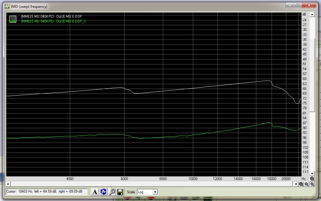

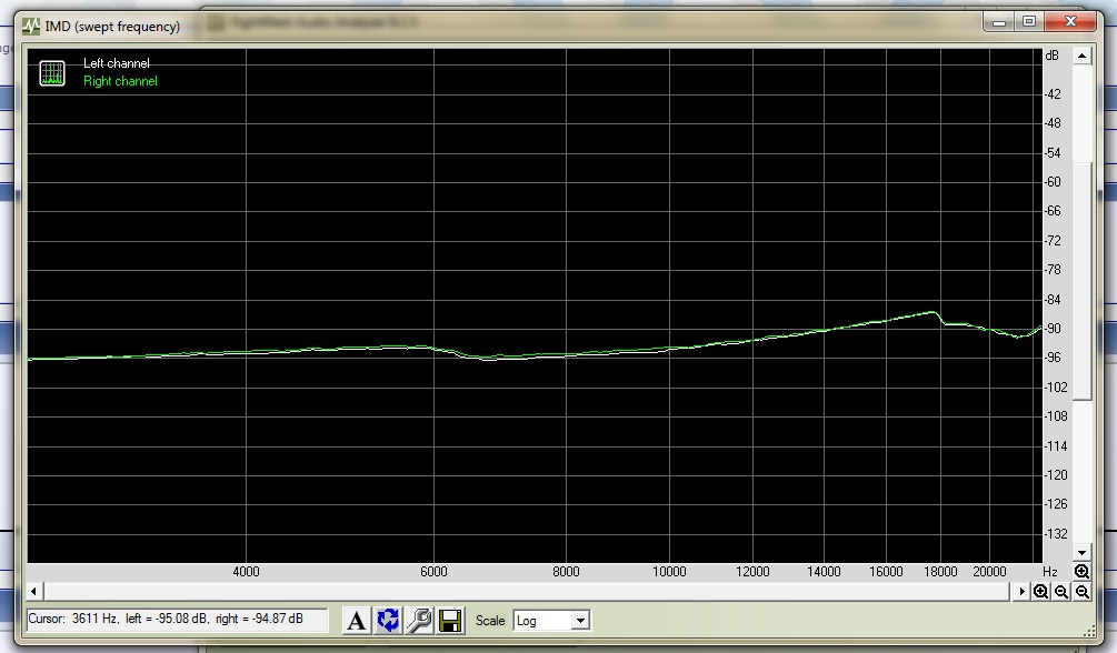

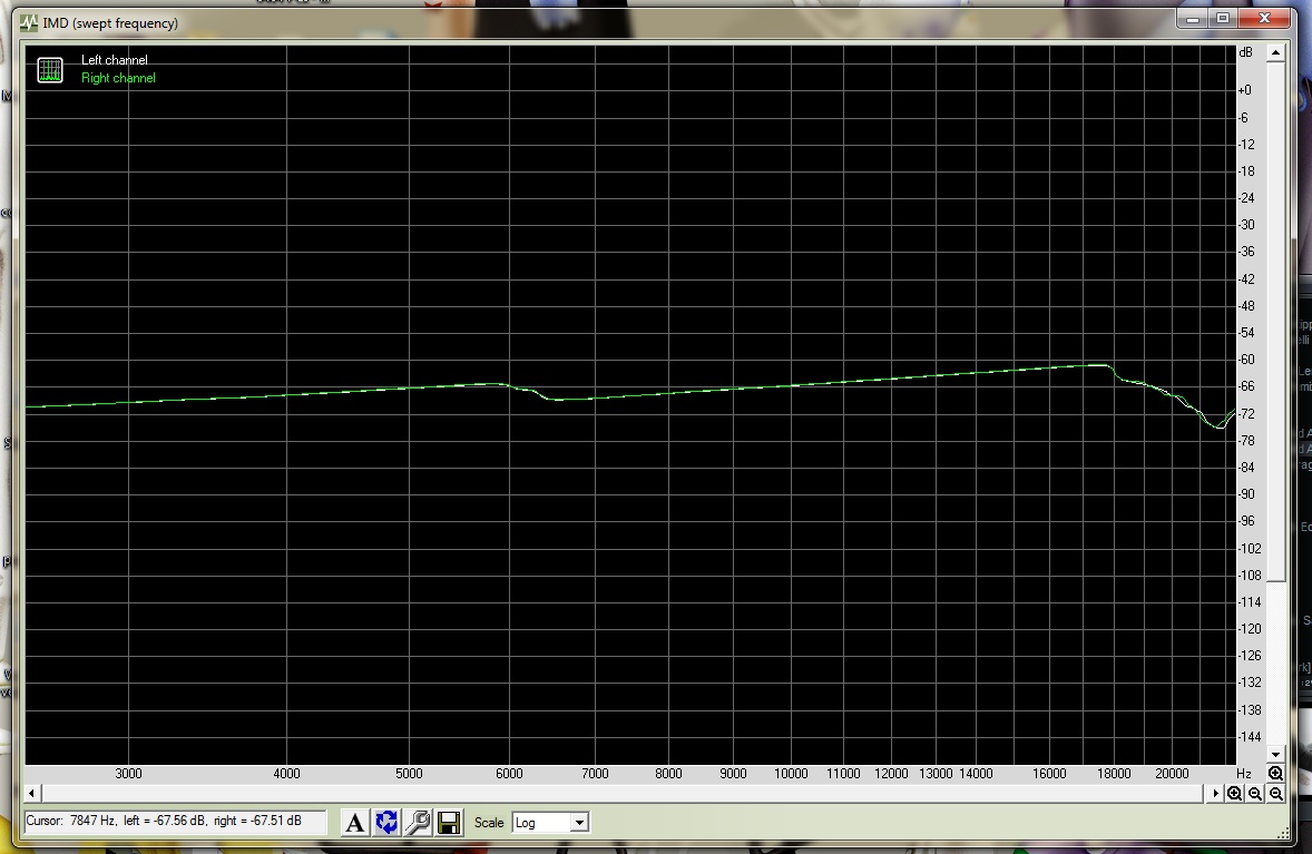

Basen on my measurements the IMD% varies like this (test is called "IMD% + noise (swept freqs)".
First is result of EMU, then result of DCX, then combined in same graph.
Yes there's little tendency that IMD% + noise rises slightly towards high frequencies, but so it is with E-MU. Someone must show us a better result with some modded DCX before we can conlude that stock DCX performs bad in this regard. I would be interested to see this test done on modded DCX. If you do please use RMAA so we have diagrams that are easily comparable.
Edit: And don't forget that some of the risign towards high frequencies is due E-MU itself.
