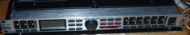

Is there any credibility to this review?? I am looking for this unit as an alternative to an active xo, saving me lot of trouble.

That review is maybe done by some DBX's or some other competing firm's stock holder😀 Is is so full of total bull shite.
You can simulate free prosessor power with the software found from the Behringer's website (scroll down). BEHRINGER: DCX2496
With 3-way stereo Linwitz-Relay 48dB config, (x-over points set to 100 and 3000) you will still have 24% of free prosessor power available. (Rememeber that you will not want to use hi-pass for the woofer nor low-pass for the tweeter.)
With 24% of free power one can set approx 24 parametrit EQs.
One can place 9 EQs per each input and each output. After setting EQ no. 1 you have to change the number to 2, and after setting that you have to set the number to 3 etc. This was missed out by the dumb joker who left that mentioned "review" since he stated that he could place only one EQ per input or output 😀. User's manual is the key to success, but even without it DCX is quite intuitive and you need nothing but general IQ to operate it.
X-overs work Exactly as they should, they do not just "attenuate the signal couple of dBs" like was stated at your link (Quote: "The crossover filters are not very effective: they don't really cut the frequency spectrum (they only attenuate a couple dBs) and the slope displayed is not correct.") Also this statement is pure rubbish. X-overs have been tested to work perfectly correct. This test I'm referring to was linked something like 15-10 pages back in this same thread. Test was written in Germany, but google translate helps.
DCX2496 is absolutely fantastic piece of equipment. Don't buy that mentioned "review", which was purely designated to give DCX a bad reputation. The review was even done in 2009 with the newest DCX version! It is total crap from the start to the end.

Wow! That is (mostly) a ridiculous review. Besides his obvious lack of familiarity with the product, I wonder if there was also something wrong with the unit he tested. I'm running Magnepan Tympani IV's with my DCX. The bass panels are crossed in between 40Hz and 401Hz, however, Maggie bass panels are nearly full range in their capability for higher frequencies. If the crossover was "only attenuating a couple of dB", I would certanily hear it. Vice versa, if the bass weren't cut properly to the midrange panel, I would have blown fuses or the panel very quickly indeed.
The only thing I agree with is his statement that you can't pick exact frequencies. I imagine that's something to do with the algorithms used for crossover calculations. But, seriously, why is he hung up that he'd have to pick a frequency that's within 1% of his target, but not exact. The same corner will be available for both high and low pass, and I don't believe at all that anyone is going to be able to tell the difference between a 24dB/octave crossover at 400Hz and the same one at 401Hz. As for the CPU power, I've still got some left over running 4 parametric EQ's and a three way 24dB setup plus summing of sub. In his defence, I will note that one of the DCX firmware updates was to allow for more available CPU processing. Maybe his unit had an early firmware revision installed.
If you buy the DCX from someplace like Zzounds, you get a pretty long, no questions asked, return for refund policy. You really don't have anything to lose trying it out, and I'm pretty sure you'll like it. FWIW, on mine the sound is reliable and good. The only thing that's not reliable are the front panel level LEDs, which stop lighting after the unit has been on for a few weeks. Power cycling it will then make them start working again. Still, this is just cosmetic, even without the meter LEDs, the crossover functions are correct. It's actually even a bit ironic, in that, on the Yahoo DCX forum, there was one guy who's project goal was to permanently disable the LEDs, which were bugging him.

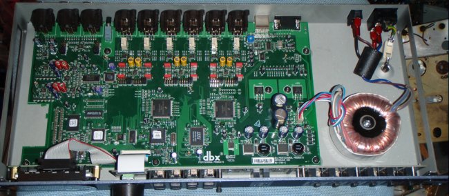

After trying a stock DCX, and found it noisy (in 112dB efficient horns!), I bought a dbx DriveRack 260. Just as noisy. Did the full DIY-routine, swapped all opamps to LM4562 (big handfull), some coupling-caps, to BG, and it did sound slightly better, but hardly worth the effort. And still just as noisy.
I sold it, got a new (used) DCX, and the kit from http://www.linearaudio.nl/6chan-1.htm .
After some initial struggle, I got it running, and my analog x-over-project was posponed...
-now I have silence !!! (when wanted). Even without lowering the output-volume. The new front-end is that much better.

Not sure whether Jan's kit has the same 0dB out, but, regardless, it has a 6-channel attenuator after the DAC's, so, at anything but max volume, it will be attenuating background noise.
Sigh.... gain structure again.
You both nail it – again - and again - and again - - - -
- S/N seems to be the most difficult lesson to learn in audio
Michael

The perceived volume is the same, -analog settings are set at +3dB in, max(+6) at output,
All digital-settings are equal (maybe even increased the treble-shelf-lift slightly), -still use the same preamp(buffer), I use the same volume-range as before.
Difference is without "Linear-kit", I had a top-hiss I could hear more than 10m away on the Altec 909(or 299)/& MantaRays.
Now, I have to go closer than 1m just to hear the faint noise.
