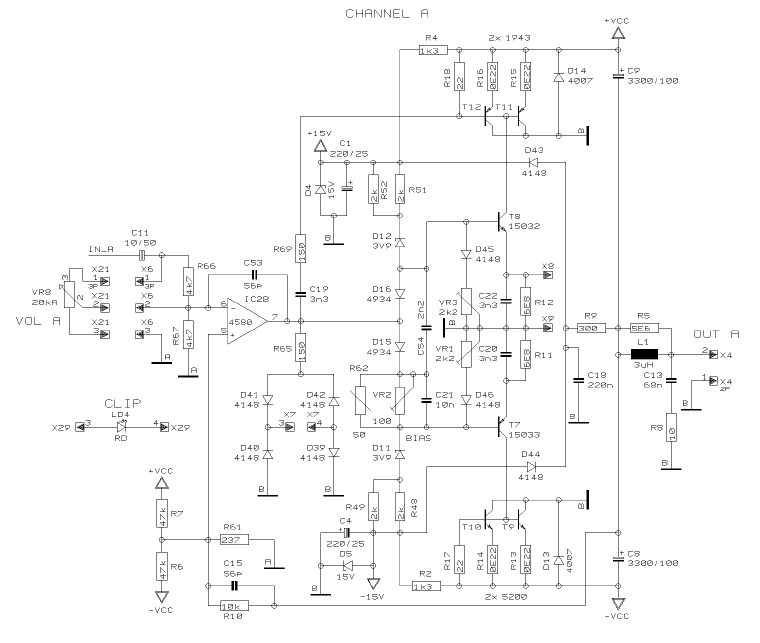

Here you go with 2 others schematics
TYVM sir, your schematic post will help me greatly. I have an A500 on my bench now, with Ch. 2 dropping into protection. I tested a bit over 100 mv DC on that output, kinda thinking that's why it only happens intermittently.
Can someone tell me what VR1/VR3 and VR4/VR6 do in the output stage? VR2 and VR5 appear to be the bias pots, and I think they have to do with DC output balance, but 2 for each side is a bit strange to me.
The install has 2 identical amps. The other sounds fine, but the meter bridge is dead in Ch. 2. I really liked these amps when I put them in, but both having issues after 4 years of light-medium duty use (funeral home PA) makes me sad.
Any answer for this?
Two words = current limiter.
(one for positive, the other for negative)
I still don't get it. Please, would you explain fully?
The pots overload the IC driving the output stage, the IC has current limiting built in. Each pot controls half of the waveform.
Surprise surprise... take a close look to this schematic and compare with the A500 schematic...
