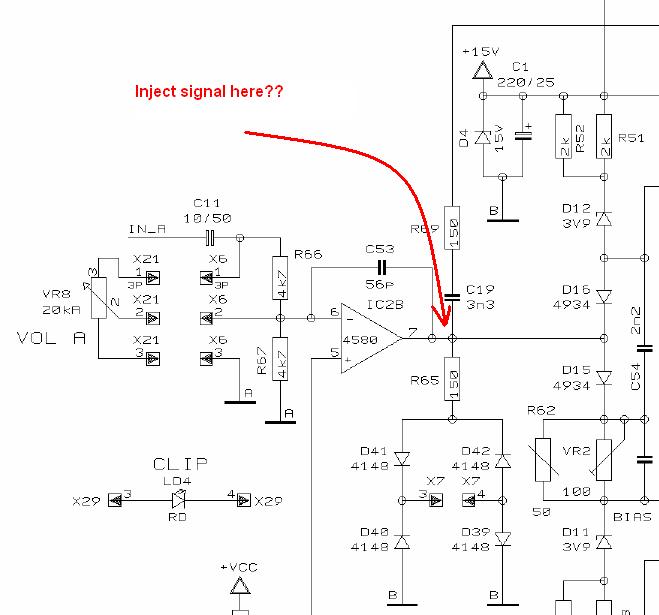

Ok, So not much feedback about my op amp dilema 😕
I was studying the circuits for the A500, and I'm now wondering if it's easier/possible/better to actually bypass the input stage (remove both Op amps and C53) and inject the signal directly to the junction of C19 & R65?? I am driving the A500 with a DCX2496 using J Didden's active i/o mod..

That OP-amp is crucial for this amp to work, do not remove it. Just look at pin 5 (+in), that is the overall feedback in this circuit!
If you just swap the OP-amp (with something entirely different) oscillations will most likely happen. Compensation must be altered if you want to use a faster/slower OP-amp.

Thanks for your reply..
I figured as much about IC2.. 🙁
So,, can I get LM4562 to work in this circuit,, or do I just revert back to JRC4580.. This thread originally states OP2134, but I cannot seem to get the smd version in Aus, and I wonder if I would have had the same problem using them as well??

LM4562 will made this amp oscillate! The input OP is the crucial part of this amp, and I will play the game on the safe side: OPA2134, OPA2604, OPA2111. Definitely not LM4562 series! Has anyone tried QSC (same circuit, but it has DIP sockets for easy OP swapping)?
