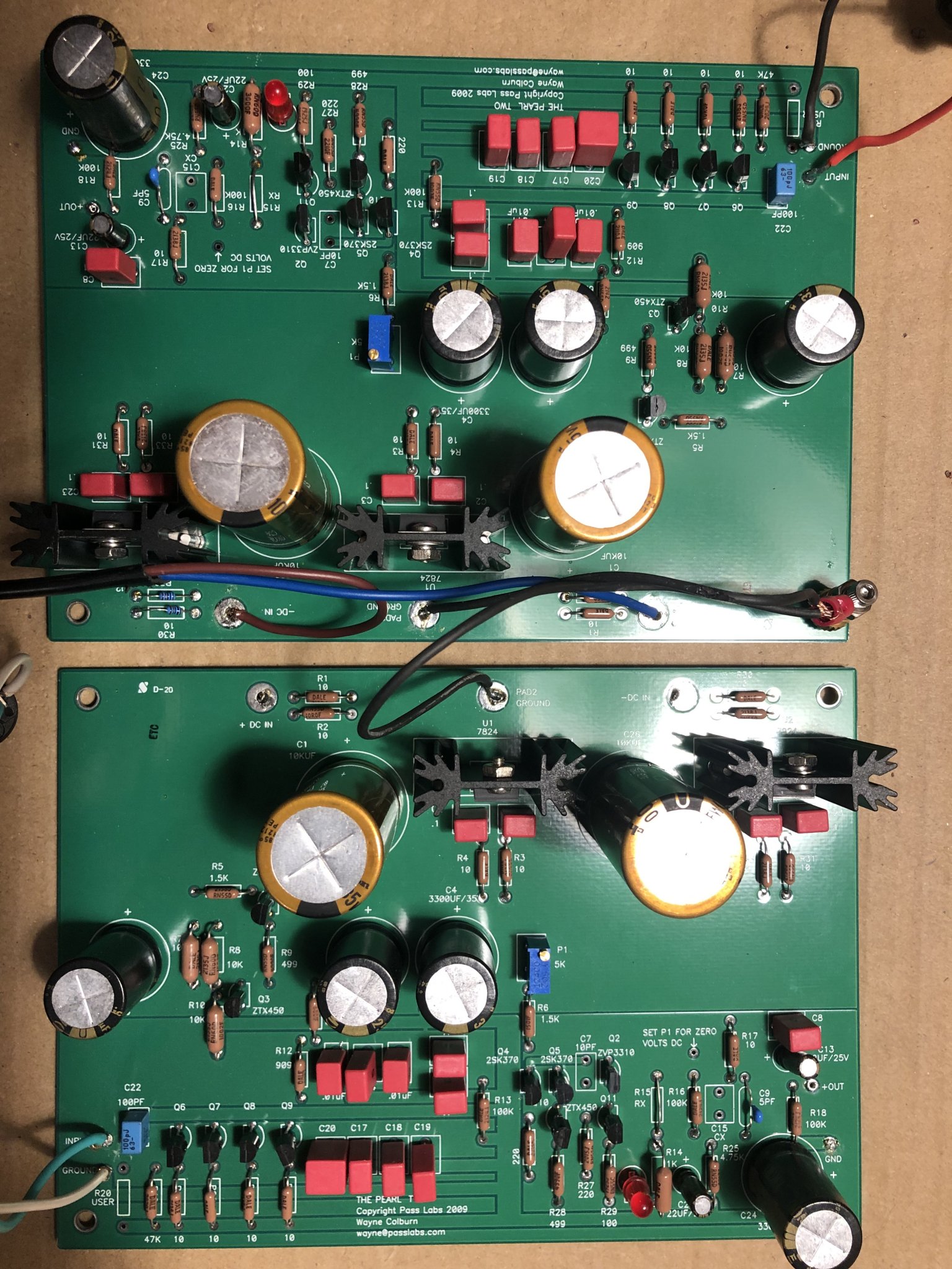

Ok, rare strait forward question: what should the voltage be coming out of Q1? I did a quick comparison of the two boards, and was able to trace back a difference between the two to Q1, with the working board having just under 20v leaving, and the other zero. I replaced q1 on the non working board, and now get just under23v leaving it, which leads to a consistent 3v difference from then on between the two boards. Can someone tell me which is correct? Thanks as always.
About 20V there is correct.
There are 13 voltages on the schematic - are all thirteen of them 3 volts higher? Check the 0 volt points first, the top of R13 and the top of R17

It took a while to get the two boards stabilized, but now that seems to be the case, so I checked voltage. What follows is Wayne/pcb #1/ pcb#2
Input R9: 20.2/22.6/19.7 (two boards noticably different, can't see why)
Output R9: 10.1/7.2/7.6 (two boards similar, but noticeably different from Wayne)
Output Q3: 9.4/7.1/7.5 (ditto)
Input R24: .01-.04/.06/.06
Drop across R6: 1.5/1.5/1.5
Output R6: 21/20.4/20.3
Input R13: 0/0/0
Input Q10: -23/-22.5/-22.6
Input R27: -22.3/-21.9/-22
Output Q11: -23/-22.5/-22.6
Input R17: 0/0/0
I am getting +- 23.6 at the output of the resistors at the regulators.
So, the area that is most different is around Q1 and Q3, and inconsistently so. PCB #1 has voltage two high going into Q1, but they both have voltage too low leaving.
Any thoughts? Thanks again for your time. If there is anything I can do to clarify, let me know.

Is R5 correct on the board with 22.6?
My readings were similar to yours until I bumped up R21-R24 to 20 ohms, on advice from Salas.
I checked r5, it is fine, but I do think that is where the problem is. There is minimal voltage drop across it on the problem pcb. Possibly the solder for q1? It looks ok, but barring other ideas I may resolder q1.
Ok, progress--tested around r7, something was obviously wrong (got same voltage both sides), replaced it, and that sorted the first voltage anomaly noted above--now I am getting around 19.6 v out of q1 on both boards. I will try 20 ohm resistors as suggested when I get them (hello, mouser).
One odd thing--I tested the r7 I pulled from the board after replacing it, and it tested out ok. The problem must have been the solder, I guess? I don't know.
Big ground plane on the Pearl 2 - a little extra solder juice is needed, especially on the ground side of the big caps.
Ok, replaced the 10 ohm resistors in r21-24 with 20 ohm, and now get 9.6 and 10.2 v out of r9. Is this difference significant? I haven't looked too hard, but so far can't trace it to anything.
Other than that I can't see anything to do beyond put it all back together and try again.

Following the previous note, I took apart the riaa and realized that the problematic board had a serious problem--I had fried the voltage regulator so many times that the pcb itself had been damaged (I am guessing from the constant soldering/desoldering process). I was on the verge of punting, and getting a new pcb to start over with that channel, but sent a picture to 6L6 before I placed the order. He said he would give it a shot, so I sent the board to him. A week later it returned, with a nifty little bridge across the damaged part of the pcb (I forgot to photograph, but will the next time I take the riaa apart). There was a small amount of drama following this, but once I got the output/input wires connected to the rca's properly, it worked! The only immediate issue was hum, which was loud enough to be troublesome. It turned out that just moving the riaa away from my integrated amp, and putting the cover on, took care of most of that. If you crank the amp enough and put your head close to the speakers you can still hear it, but if I were to get another stand to get the riaa further away that would eliminate most of that.

The board where you are replacing 7924 and burning 10ohm resistances, can you check red led. Here I tested one with reversed LED and it was doing same thing. Worked fine after correcting polarity of that Red led.
The PCB that was blowing the regulator had a teeny sliver of wire in the solder that was shorting it out. Everything was removed, cleaned and re-soldered. The PSU voltages are fine.
