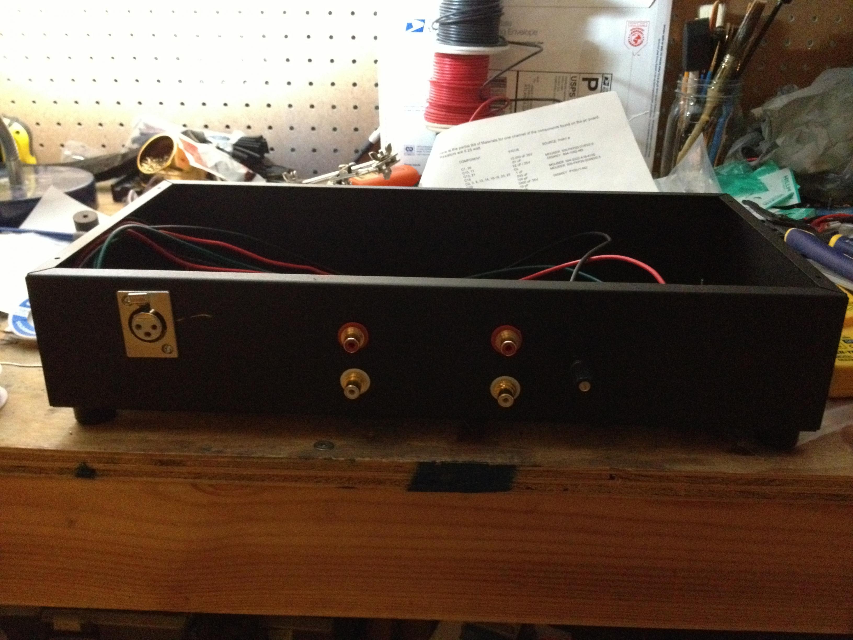

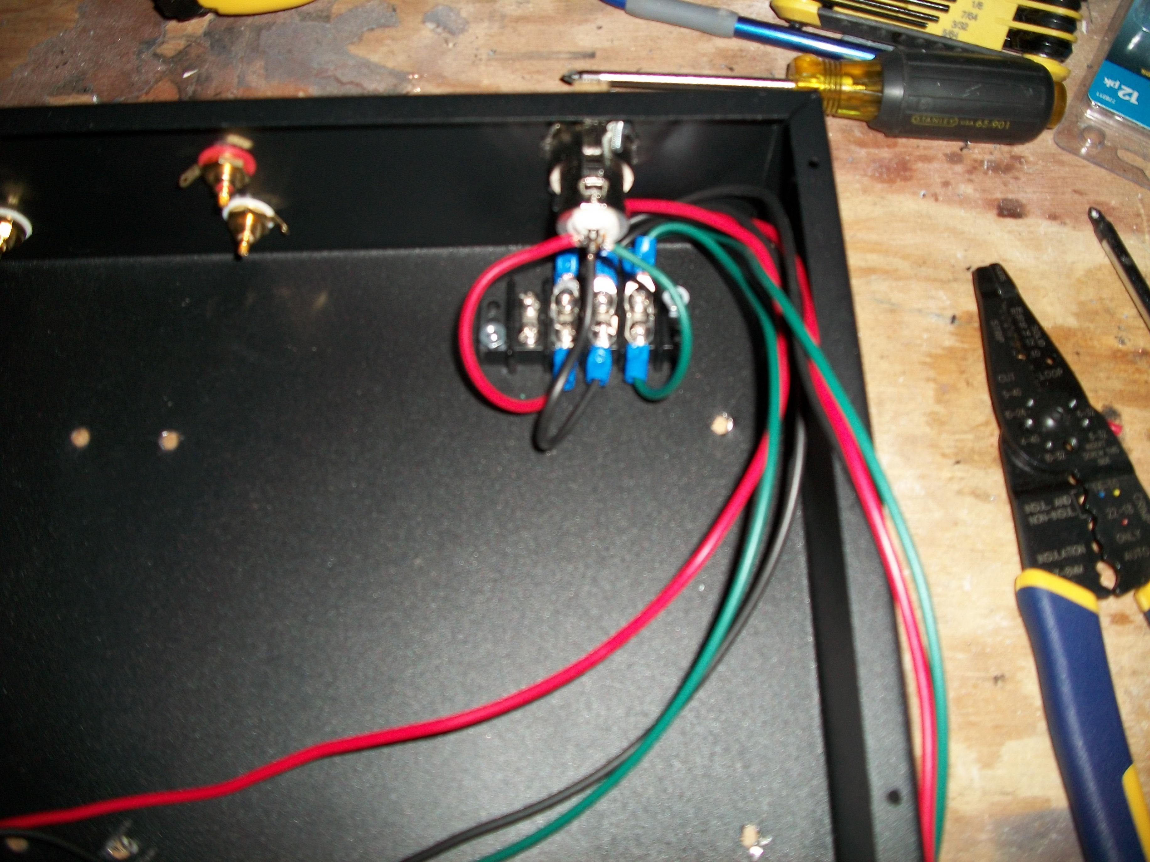

A few more shots, largely wrapping up the work on the case. One note: the hardest thing to solder I have found so far is the male xlr plugs. So what did I do? Reversed the wires, so positive went to negative and visa versa. My first thought was to just correct for it by changing the wiring in the pearl ii box, but in the end decided to fix it. Am I missing something, or are male xlr jacks a hassle to solder? Annoying. But moving along!

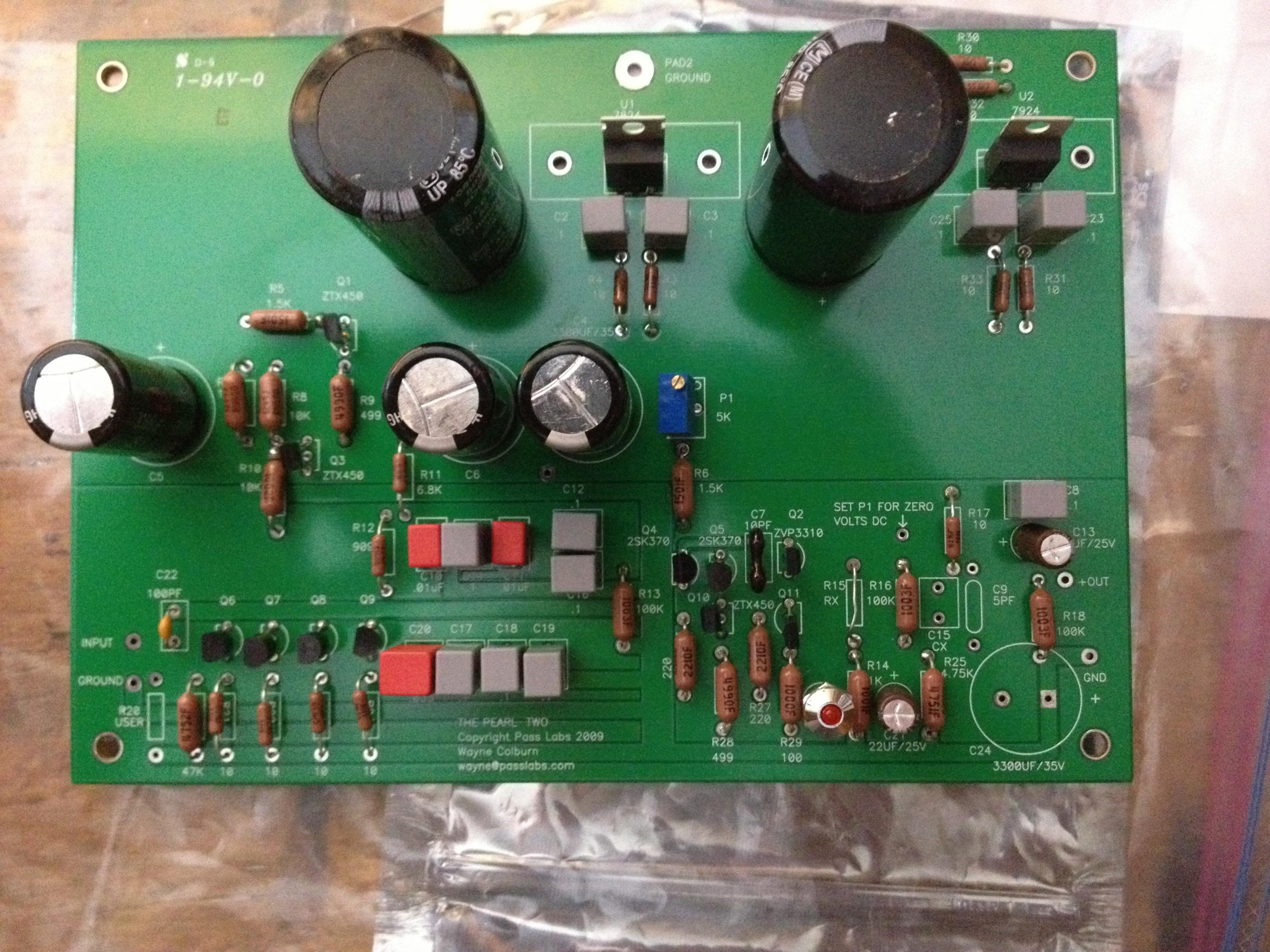

Starting on the pcb's. A few thoughts:
Below is a picture (ignore little transistor on the left, forgot to take picture before I put it in) of the voltage resistor and surrounding pieces. As recommended by 6L6, put those in first so I could make sure that I was getting the requisite 24 v out of this section (tested by temporarily hooking up the power supply to the board, putting tests on the output of R3 and ground input, similar with the DC- section). Got 23.7-23.8, so am starting to put in rest of components. This is done to avoid frying many of the transistors, I believe, if you have a problem with the power supply.
Soldering transistors is a pain. I find it difficult to get the transistor leads hot enough to melt the solder, particularly the middle lead. Every one is an adventure.
Transistors are "directional"--they have a correct orientation. I put in a few before this particular lightbulb went on, and then spent a fair bit of time trying to figure out if I had done it correctly. At some point I realized the pcb outline matches the transistor (a flat "back" and rounded "front"), to which all I can say is "duh". I had done it right, thankfully. Please make sure you do this properly.
For all my efforts with the BOM, I made several misorders. I forgot to order heatsinks for the voltage regulator, and ordered too few .1 uf capacitors and 3300uf capacitors. Mouser and USPS are doing well off of my errors. Don't just double check your order, triple check it.
It helps to have a "third hand" tool with XLRs.

You started soldering with bigger electrolytic caps first?
IMO, you should start mounting smallest parts first - resistors, film caps, diodes/LED, electrolytic caps. Smallest means parts with smaller height from PCB plane and footprint when mounted. Then move to next bigger resistances and Caps. In the end, semiconductors with >=3 legs.
Thanks, this makes sense. I put the big stuff in first to check to make sure I was getting 24V into the main section of the board, which was a good idea--I finally got the extra capacitors to put in the - channel of the second board, and lo and behold, 33V. I had soldered a connection poorly. Repaired, and now have 24 V. In general I will do it the way you suggest, if for nothing else ease of work. It unbalances the board having the big stuff in, which makes it a bit harder to solder.

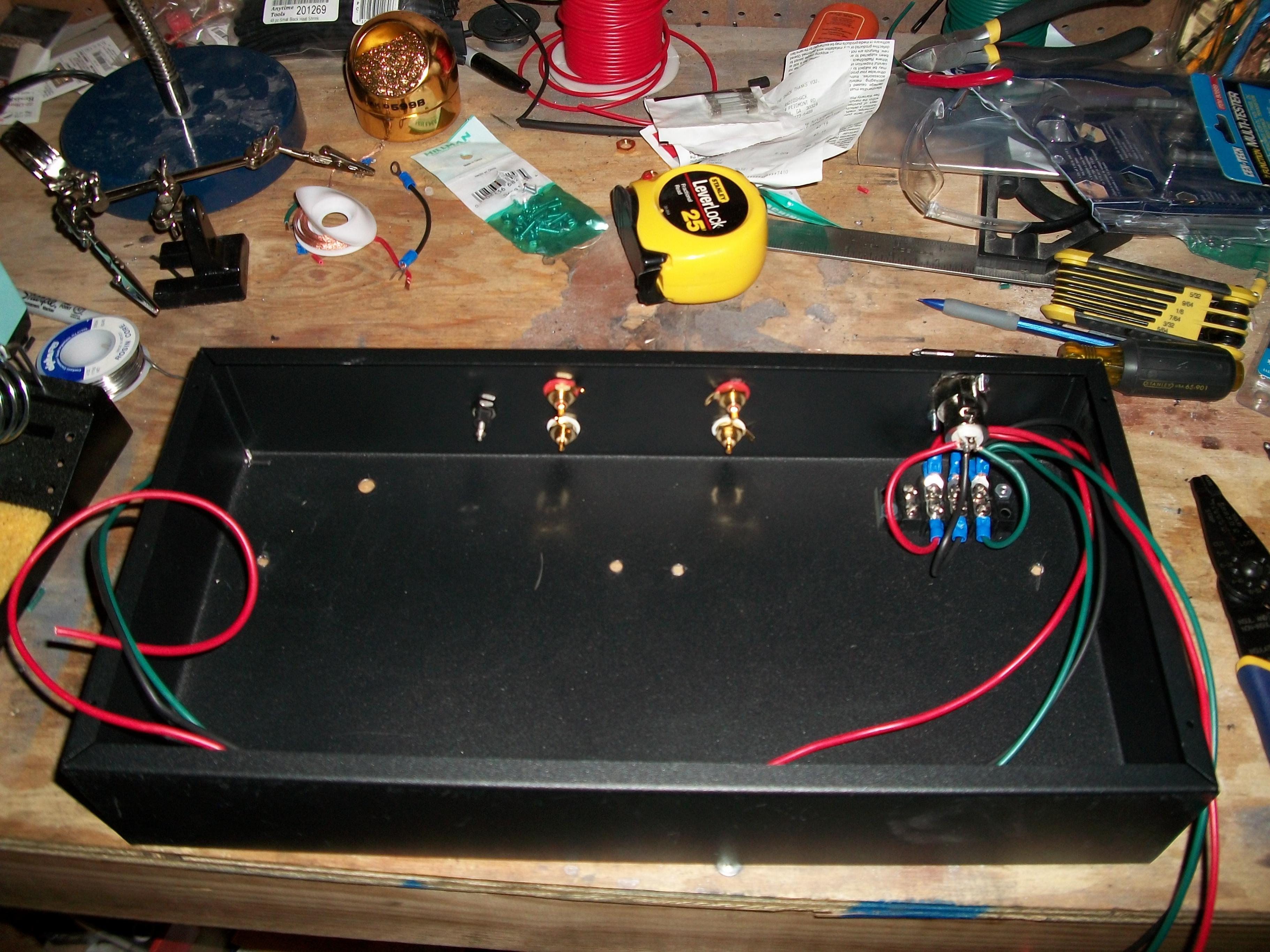

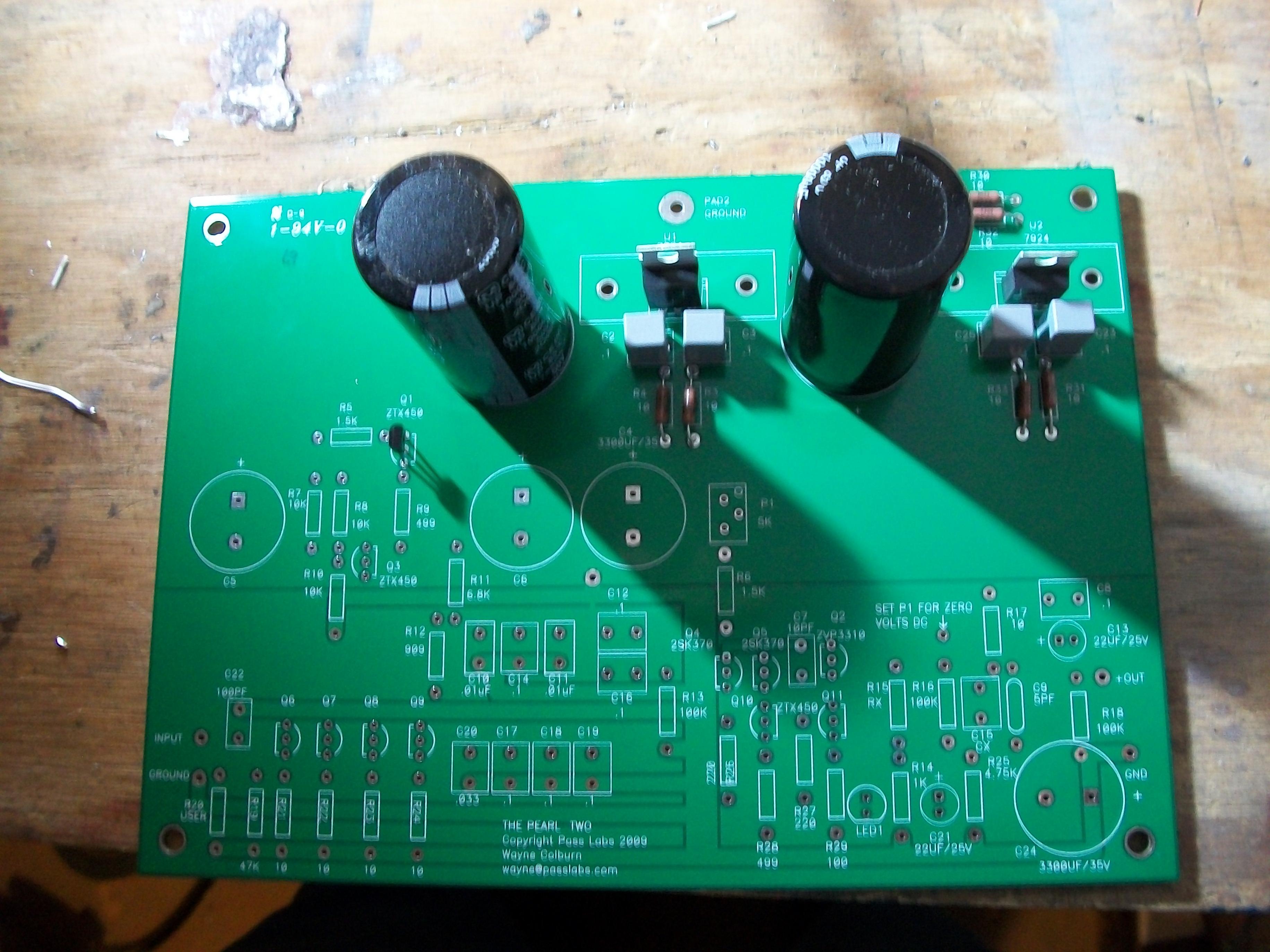

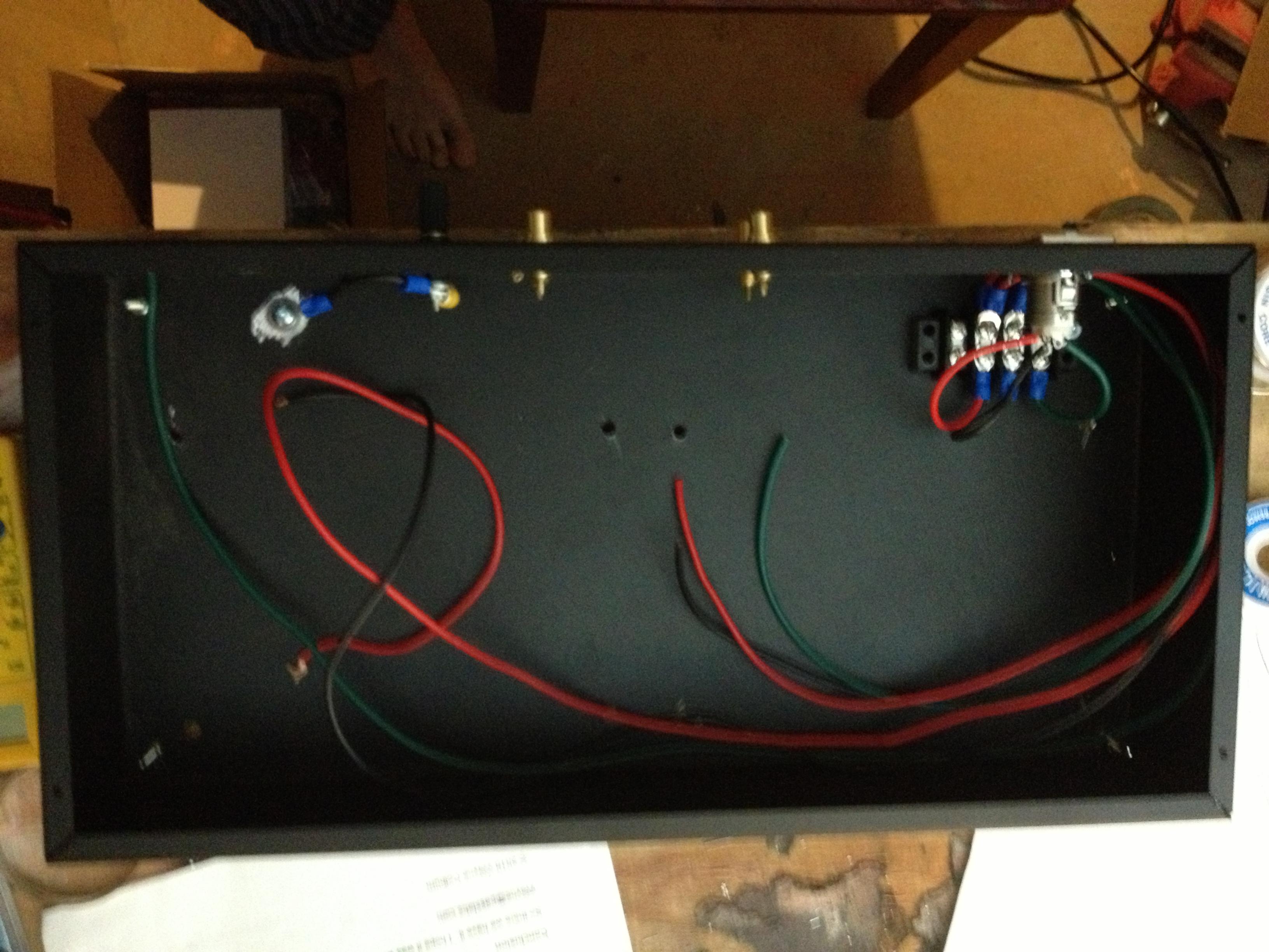

Quick update. Following a suggestion in the "Mistakes you learned from" thread (http://www.diyaudio.com/forums/pass-labs/233964-mistakes-you-learnt-might-helpful-beginners.html, I couldn't recommend enough), i tried to straighten the rca inputs on the pearl case by tightening two nuts around a bolt threaded through the hole, which lead to a definite improvement. I put feet on the cases, and finished the interior of the pearl case. Finally, I put in most of the components to the pearl pcb's. I realized that I had (by following a piece of someone else's BOM without really asking why) ordered variable capacitors (3pf-11pf) in place of the 5pf capacitor called for in the schematic. It would not fit into the place on the pcb, as it was too small and the connections were a bit too wide. Thinking that it was all that was between me and getting the pcb finished, I soldered some jumpers to it. I wasn't convinced that this was a good idea, so didn't put it in the pcb. Ultimately, I realized I had ordered the wrong size heat sink (EA-T220-38E, I believe, is the right one, I had ordered FA-...) so I had to place another (sigh) order to Mouser anyway. I added a few 5pf capacitors.
Below are a few pictures. I am trying a new camera (well, phone). Borrowing from WC, I see this as getting close to the end of the beginning--by this weekend I should have it all together, or at least the pcb's running so I can check if they work. We will see if it is the end of the end. As always, if you notice anything stupid please tell me.
Also, does anyone have any suggestions re: the installation of the heat sinks? Should I solder them to the board or just screw them to the voltage regulator? Thanks.
