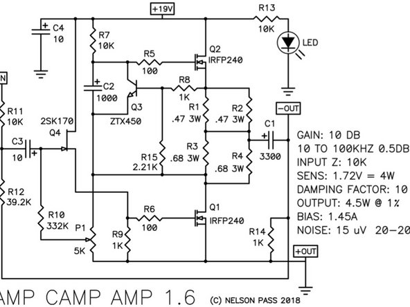

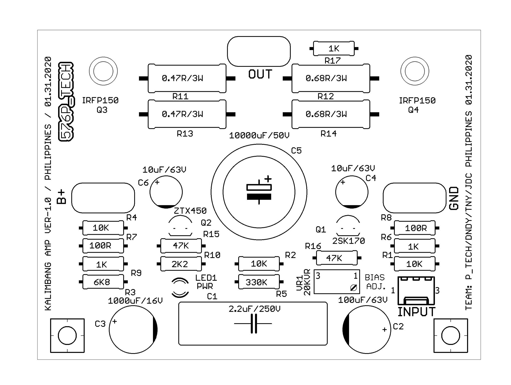

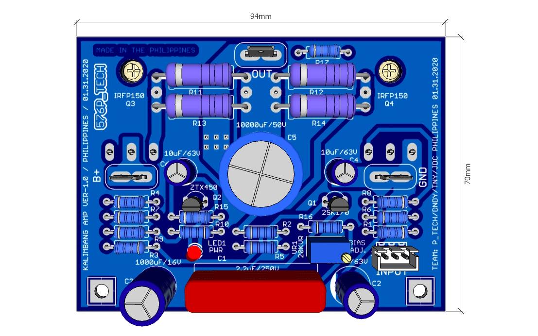

big ACA, scheme ready, layout ready....
thinking of the sk117, instead of sk170...
and a 0.2ufd at the bottom of the 330k resistor to trimpot...
may improve transient response some?

@TonyTecson, you didn't do anything to increase the standing current.
not there yet, that will depend on the actual heatsink that i can lay my hands on, a conrad engineering 350mm x 150 mm x 60 mm is what i am intending to use...we will see...not closing my doors to higher bias..
increasing standing bias can be done by changing the two 0.68 ohm resistors to say two 0.47 ohms, but i do not want to do this just as yet..
That’s a good looking PCB layout. This will be a fun project and a nice amp to listen to.
I would suggest changing the two 0.68 Ohm resistors to 0.56 Ohms. That should raise the bias current to about 1.6 Amps. The IRFP150s will sound better with higher bias.
R4 should probably be increased to 15k.

while you are there , increase R5 to 15K , decrease VR1 to 5K (max 10K)
