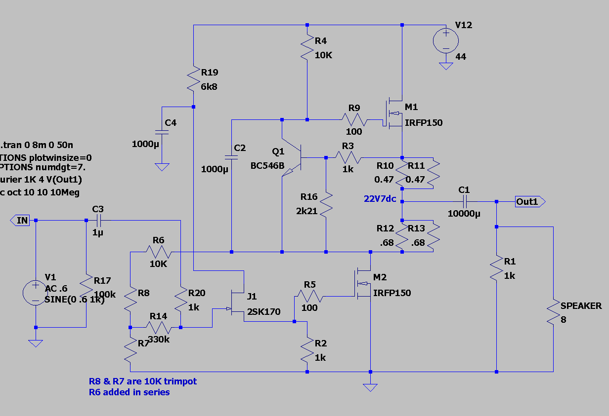

In order to get more power out of a stereo ACA with few modifications, you will need:
1. Higher transconductance Mosfets
2. Higher voltage and bias current
The known good choices for the Mosfets are the IRFP044, IRFP140, IRFP150, and my personal favorite, the FQH44N10. There are also some IXT parts that could work, but let's keep this simple. The highest power ACA that I've built so far uses a pair of IRFP140s with a 28V power supply. Look for my report in the ACA with Premium Parts thread. It's the ACA-220 v2. It sounds great, but is no match for my Aleph J or F6, both of which have special modifications of their own.
There have been reports of ACAs using IRFP150s with a 30V power supply. My experience with the FQH44N10 is with my hotrod F6. I would be tempted to run those with a 32V or 36V supply and 1.6A bias current. Bigger heatsinks will be necessary.
The input JFet will run safer if you can add an RC dropper above its drain connection. Try 499Ω or 1kΩ and 100 uF Organic polymer. The PSU should be a very low ripple design; set a goal for 28 to 30V and 10mV or less ripple. Again, check out the ACA thread that I mentioned for recommendations. If I were starting from scratch, I would use a 300VA transformer with 25V secondaries, LT4320 based synchronous rectification and a CRCRC filter.

use IRFP150
regarding 2SK170 - it's simple to change appropriate resistor to accomodate for higher voltage , already shown in ACA thread
I probably have that saved in my files , but not in this (workshop) PC
You could simply cascode the Jfet when running higher voltages, will be 'better' than a zener.
The IRFP240 (each one) sees roughly half the voltage rail so will be fine up to about 60-80V without issues.
Output cap needs to be bigger. With bridged amps the cap is not required and I would stick a 30V supply on each amplifier, cascode the JFET, uprate all the cap voltages and call it a day. You will need to cut one trace on the amp board if you want to cascode but with a 30V supply there's no need.

Zen Mod, i already have those mosfets on hand...
would like to see the jfet mod to be able to run higher voltages..
i would appreciate if you can show links to the ACA thread..
i am a johnny come lately to mosfets...
point me to schm you want to use as basic one , I'll edit and post here
easier than find previous one
