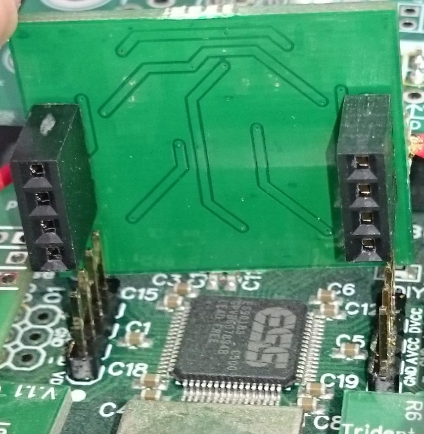

A bad silver joint on the AVCC or its board-to-board connectors could cause both of these problems. It is where I would look first.
I would concentrate on the male and female headers. Check pin continuity first, without pressure if possible (check from connected pads rather than the pins themselves).

Hm, could there also be an connection problem within the board-to-board connectors of the AVCC? If I touch the small 3-legger of the AVCC (OP-3, opamp #3), the hiss goes away. By the way, the opamps are fairly hot.

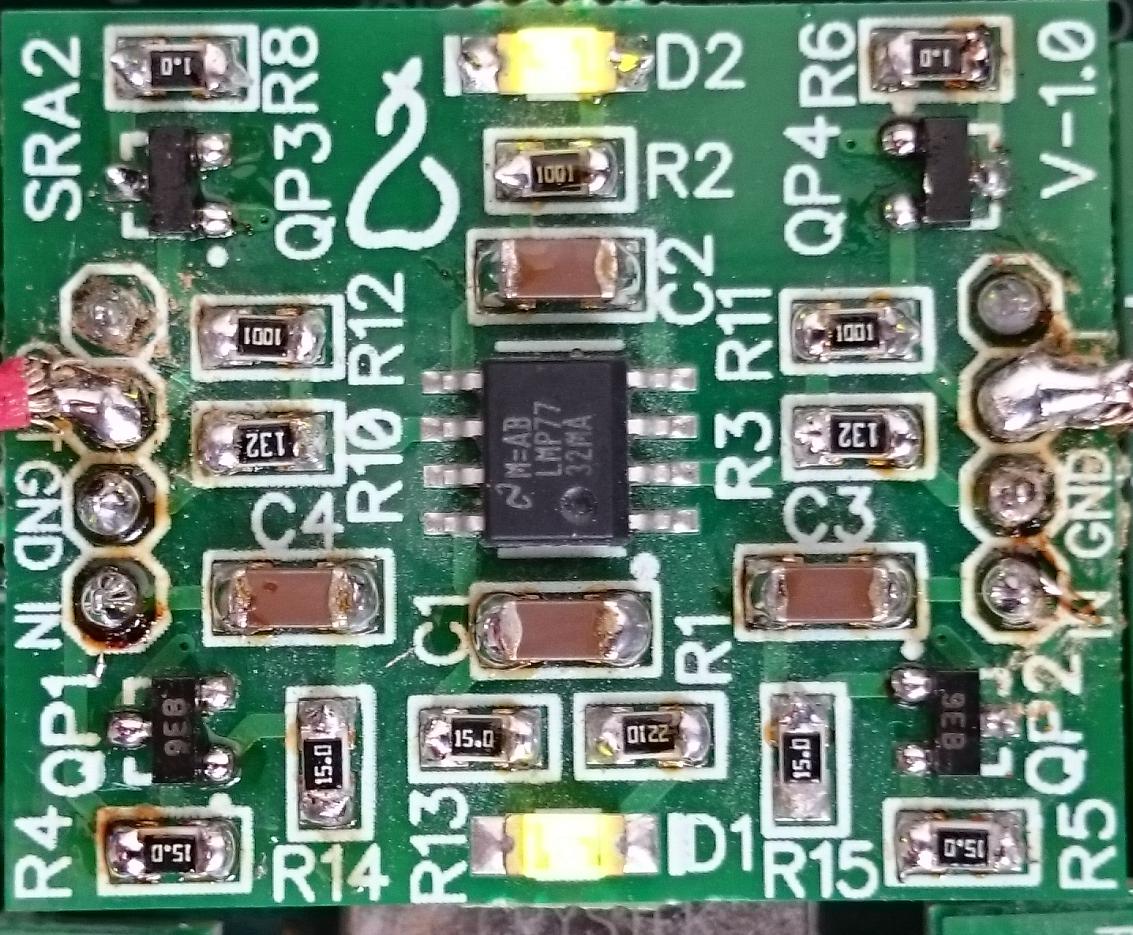

I think you are referring to QP3 (transistor). You could try touching the three legs of the transistor with your soldering iron to make sure they are bonded well. It is possible that the joint was damaged when soldering/resoldering the headers.
Can you post a picture of your AVCC, top and bottom?

Also I'll take a photo and post it, but unfortunately the back of the pcb isn't easy to reach because of the cables you can see in picture 1 and post

I assume you did not use the male/female connectors for mounting the AVCC module. Too bad, as it makes life a lot easier for troubleshooting.
Yes, I did, but as I switched from Legato III to another IV stage, I needed to solder a wire from AVCC's 3.3V pin. This is why I first had to remove the soldered wire, the rest is just lifting the pcb.
What's on the lower side of the pcb?
Soldered all joints in the AVCC, the hiss is still there.

You press the board more firmly toward the Buffalo and the hiss vanishes? Pressing with a bare finger or pressing with something insulated/non-conductive?
