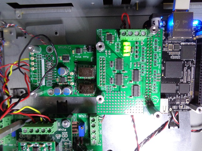

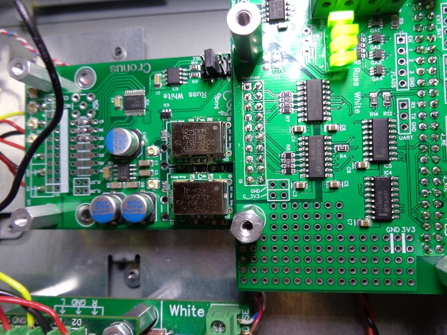

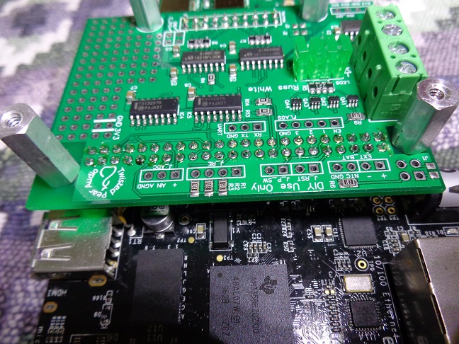

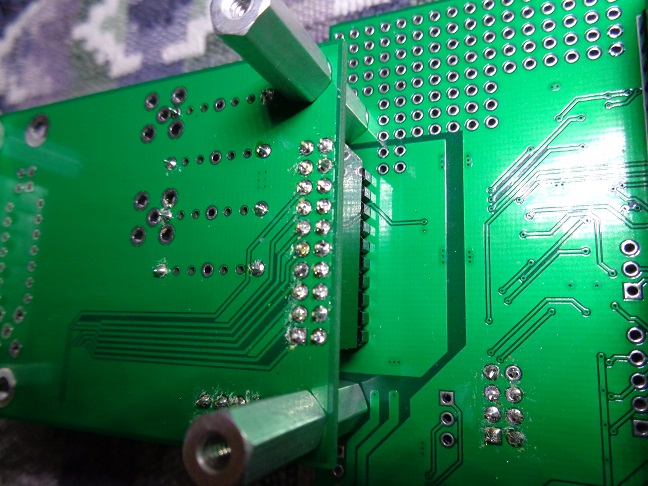

As requested by Russ, I am starting this thread on my ongoing problem getting the BBB/Botic to play.
Many software solutions have been tried and I have now started to investigate possible/likely hardware cause of the no play.
I've attached pictures of the build as requested and will also disassemble boards to reheat solder joints on all the connectors.
