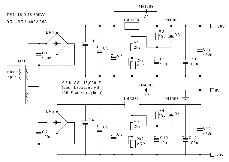

Ralf
I'd have done things slightly differently 😉
I'd configure the transformer for a centre-tap, using that as my 0V reference, and use a single bridge rectifier to produce the + and - rails, and used conventional pos and neg regulators, although it may be possible to implement your idea of using pos reg's using this scheme too, which may have benefits in terms of matching between the pos and neg rails.
C1 / C2 are not acting as snubbers, but are, in effect, reducing the self-resonant frequency of the transformer, possibly making the effect of the oscillation more audible, rather than less.
3x15,000 uF (c3-C8) is in my experience way too large for a 300VA transformer - I'd not go above 10,000u - a single 15,000 absolute tops. The conduction angle of the diodes will be very narrow, and increase noise, not reduce it. Additionally it places greater stress on the transformer / bridge rec due to I2R losses.
Bypassing can work well though, if done with care.
There are noise / ripple benefits to increasing C9 / C10, at the expense of start-up time, and you have to watch ESR of the caps at the regulator o/p's - too high a Q (particularly with the additional film cap) can give rise to instability / or simply worse transient performance.
What the schematic does not convey is the criticality of the wiring - the output MUST be taken from the bottom of VR1 / VR2 and the +ve regulator o/p, and the connection of components around the reg is equally important.
For example R3, R4 should connect as close as possibly to the regulator o/p pins - ideally star-wired (i.e. not sharing a current path with the output current from the reg..
Unless you need adjustment it would be better to eliminate VR1 / 2 and use fixed components.
A few thoughts, anyway 🙂
Andy.
