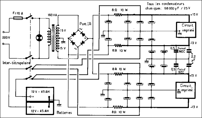

I finished my battery PS + charger this weekend.It is dual mono +- 24v and it must weigh about 30kgs!In fact I had to make a special frame for the batteries to sit on so they would not bend the bottom plate of the case and of course sothat they wouldn't move about.
I can say that at some stages working with batteries is bit hairy because they are always "switched" on and are dying for you to short them on their open pins or when you plug in the leads.
I also modified the gainclone with 2 3pdt switches so that it can be powered from its AC PS as well.
I am very enthusiastic about the sound.More dynamics,better bass believe it or not,bigger soundstage, more natural sounding than the dual mono dual225 VAC trfo dual schottky bridge PS.

Optimum reservoir capacitance
ALW (Andy),
You said in an earlier post that;
3x15,000 uF (c3-C8) is in my experience way too large for a 300VA transformer - I'd not go above 10,000u - a single 15,000 absolute tops. The conduction angle of the diodes will be very narrow, and increase noise, not reduce it. Additionally it places greater stress on the transformer / bridge rec due to I2R losses.
Do you have a rule of thumb on the appropriate amount of capacitance to use in relation to the transformer VA rating that you could share?
ALW (Andy),

Try matching the reactance of the capacitor at the ripple frequency, to the DC impedance of the secondary for starters.
Then see what you can find out from that, I've not investigated this in detail.

Now that my amp is finished, I want to complete my battery PSU. I have used the Amp Chip forum schematic. Does anyone know if when using battery supply, if the 1uF cap is necessary across + and - ?
Thanks,
Vic
Thanks,
Vic
"Does anyone know if when using battery supply, if the 1uF cap is necessary across + and - ?"
Yes!
/Peter
Yes!
/Peter
battery bypass
The 1uf is necessary for stability but I found that a larger good quality cap is necessary for best sound quality. Batteries are not very fast
Of course it a matter of taste. I would be interested to hear what you think if you do a comparison
mike
yes
hi,
i e-maild with someon who knows someone who has build the monster.
he highly recommends the caps. without you can hear a dull "battery sound"
