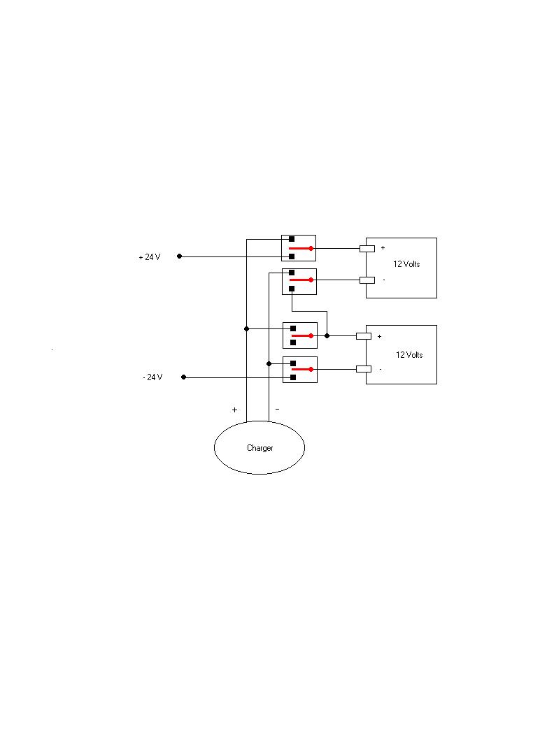

I have been thinking this through. Using a three position switch, On-Off-On, or similar, one could have the switch in 'listen' position which would open the relays to the charger and close the relays, open the charging circuit and the close the circuit for the battery supply to the component. Conversely, in charge mode, the opposite occurs. If using multiple batteries, in series, it becomes just a little more complicated but not undoable. From what I have read, you want to charge multiple 12 volt batteries in parallel to optimally maintain each one. I haven't had much time to work on this but as soon as I do, I will post a proposed layout and hopefully

vic said:I have been thinking this through. Using a three position switch, On-Off-On, or similar, one could have the switch in 'listen' position which would open the relays to the charger and close the relays, open the charging circuit and the close the circuit for the battery supply to the component.
But then you have to provide power for the relays. Why not do it directly with a switch? One position engages the batteries to the device you're powering and the other engages the batteries to the charger.

That's true. But, what if you want to put batteries in series but charge them in parallel with a single charger per side? What do you think about something like this? The switch can run the relays which are fed either by the batteries themselves or from a cheap DC source (small transformer, rectifier).

vic said:That's true. But, what if you want to put batteries in series but charge them in parallel with a single charger per side? What do you think about something like this? The switch can run the relays which are fed either by the batteries themselves or from a cheap DC source (small transformer, rectifier).
Sure. That would work if you just have one charger. In my setup, I use a dual charger (a Patco Model 300) and just use a 4PDT switch to switch all four terminals of the batteries between the amp and the charger.
Of course if you're using more than two batteries in series to get say a +/- 24 volt supply, then things get a little more complicated. 🙂
