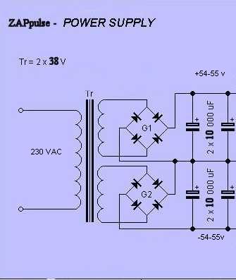

Vic,
It is basically a standard power amp ps without "any" inductance/resistance in series (see picture).
You would need a transformer with 2x18 volt rating at max. power. This would probably give you around 19.5 ac volts with a light load (max. power and light load depends on your average listening levels and power amp design)
After the rectifiers and caps you should have a dc level in the area of 27.5 vdc. This will work well for maintenance charge of 2 series 12 volt lead acid batteries.
If cost is not a big issue I would recommend that you build the ps/charge unit to run the power amp without batteries and then just create a "battery switch on and charge circuit"
This way you can choose how you want to run and be sure you have enough voltage and current to support both maintenance charge and running the amp (there is very little difference between charge on and off)
The biggest issue for me was to start it up on batteries, the series resistance is VERY low compared to a transformer. Which when you switch on and have a big capacitor bank will create completly crazy start up currents.
You could build a soft start circuit or just use the charge unit to fire up the caps and then switch on the batteries.
Hope it helps!

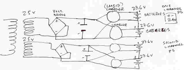

Protos.....the circuit you have drawn will work except that you need power resistors on the output of the regulators for 2 reasons.....one to set the charging current and second to equalize it or one battery might try to draw more.
Another suggestion to the charger is to have some relays on the outputs that open when the batteries are in use so you dont have any AC line noise.
Cheers!!The DIRT®
Cheers!!The DIRT®
Protos, that won't work. You can't put the charger circuits in series like that when they're run from the same supply. Take a closer look and you'll see that the midpoint between the batteries and the neg terminal of the lower battery are at about the same potential.
The charger circuit he intends to use does limit current, no need for resistors.JOE DIRT® said:Protos.....the circuit you have drawn will work except that you need power resistors on the output of the regulators for 2 reasons.....one to set the charging current and second to equalize it or one battery might try to draw more.
What about this?
Verbal
Are you saying that I need to switch out the series connection between the batteries when I charge them?Your schematic implies this.Of course this greatly increases the complexity of the charger.I would need two extra switches every time I wanted to charge the batteries.Isn't there a simpler way with direct charging of the battery pack as it is connected?What if the second leg charger is the neg type?
Would need a symmetric supply...Perhaps like this?
Are the extra regulators for better accuracy?Do we really need them? What about current limiting? Can I impose on you for a current limiting scematic as well?
