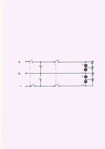

I'm making a dual mono +/-24V battery power supply for a DACT CT100 Phono preamp. I'm using 8X 12V 2.2Ah Panasonic SLA batteries and 4400uF,35v Elna low ESR caps (paralled 2200uF).
I wanted the charging circuit to be as simple as possible, although it would not be as convenient as the automatic ones (might be a future project).
I've accached a rough schematic of one channel's supply.
The DACT only draws 22mA per channel, so I would need to recharge no more than once every two weeks.
The setup means only one of the four batteries per channel can be charged at a time, thoiugh each battery would recharge within 1/2 hour with a 1A SLA charger.
To shorten the charging time I would use a second charger simultaneously on the other channel.
Can you see any problems with this arrangement, other than a little inconvenience.

I should mention that I would recharge the batteries at around 80% capacity or less, but no less than every two weeks, which would allow about 1 1/2 hours play per day.
I'll probably get two fully automatic 1A SLA charges, although I could just use the Arlec 6A Automatic 12V charger I use for my car battery. I have also used this charger to charge the same 1.3Ah Panasonic SLA battery for over seven years, and I used it again tonight for lighting, when we had a power failure.

Could you not use a 48v charger on a switch with a floating ground?
ie. the amp is grounded in the center of the pack +/- 24v then you throw the double pole switch and the charger sees 48v and charges the batteries?

if you float the charger cct you do not need a switch - you can just connect across the + & -
The batteries need to be of same age & condition for this arrangement
