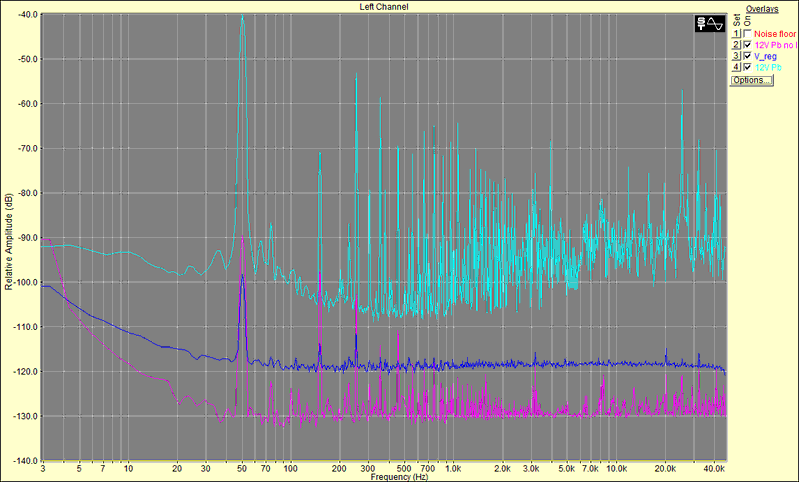

Been meaning to do this for a while, and the oppportunity arose recently whilst doing some other stuff.
The plot below is the noise of a sealed lead-acid gel-cell (Yuasa NP series) under no-load and resistive load conditions. For comparison there's a discrete regulated supply. The resistive load represent about a 35mA current drain - it gets worse with increasing load current. Even more inportant the noise doesn't stop when a heavy load is removed, it takes seconds to settle, presumably due to the chemical reaction going on inside the cell.
Bear in mind these are resistive load conditions i.e. easy, when placed under a dynamic load (plots to come at a later date) things look much worse.
Particularly bad is that the voltage output bears no relation to A.C. load, and produces other noise products that are not remotely related to the load it sees.
Adding a 22,000u cap (not shown) gets the noise above the audio band down to the regulator levels.
As you can see the battery is only quieter under no-load conditions - not a great deal of use!
I'll do plots to compare to 3-term reg's later, which at low currents look cleaner, but noisier, the noise is inocuous though as they display far better linearity.

Re: So you think batteries are clean do you?
Well, it's about damn time! 🙂
Thanks.
Before commenting further, a couple of questions.
What's the reference level for the relative amplitude?
Are you applying any averaging? If so, how much?
ALW,
the plots don't look right... how come the 50Hz spikes on the battery plots are higher than the (regulated) AC supply? Are you sure the BUT (battery under test 🙂 ) is not still connected to it's AC charger and that you were measuring the noise of the charger?

In any case a battery won't produce a 50Hz hum...(nor all those harmonics)Alex S said:ALW,
AWL could you do similer comparrisons but using NI-MH Cells. This would be somthing to consider in low current line level stages as apposed to gain card Clones. I wish reasonable NI-MH Power was available.
ALW is maybe proving something but in the same time the complete circuit isn't defined so you aren't really sure what you are seeing. This hum pickup is a bit disturbing and the noise from the battery may come from switched PS or other sources, so take the results with a grain a salt.
