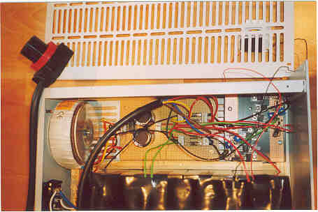

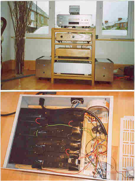

I recently built a buffered "passive preamp" that is powered by SLA batteries. The sonic results are stunning.
I used Shallco stepped attenuators with Resista resistors and OPA627 opamps as buffers. The batteries are rated at 7AH.

What did you use for charger? I'm thinking about similar preamp.

I used two Velleman SLA charger kits. Initially I was going to build a charger from scratch or buy two of the circuits that Chris Brady uses for the Teres. The Velleman works very nicely since it automatically switches from deep to trickle mode and can remain connected to the batteries 24/7. In addition, I have a switch on the front panel of the preamp to take the charger out of the circuit while listening.
Yes. I struggled with this for some time. I really wanted a single control but didn't want to add an additional balance pot to the signal path. The Shallco switched can be ganged together but they already require mucho effort to rotate.
I had a local machinist spin them for me. They are 2.25" in diameter and 1" high. The cost was very reasonable.
