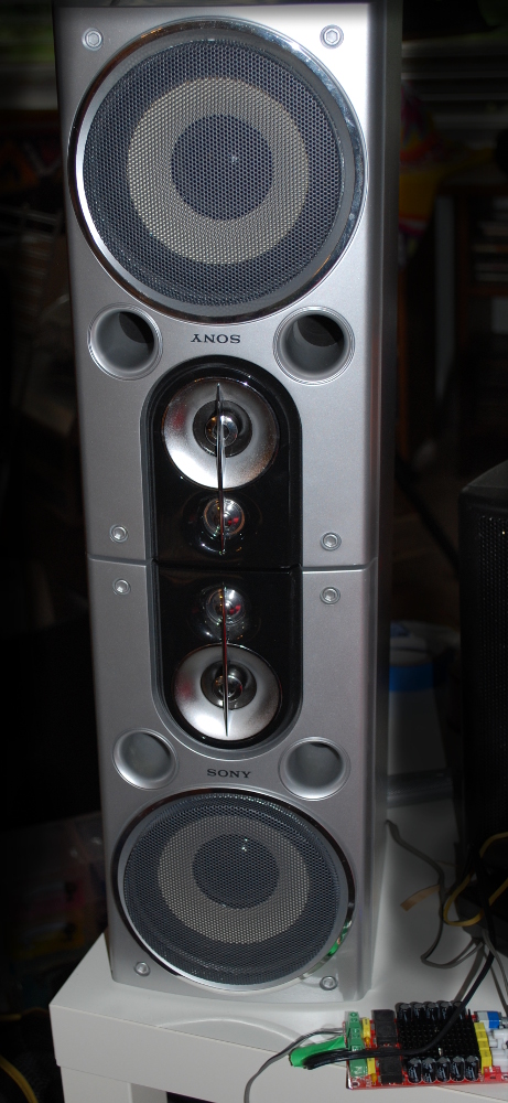

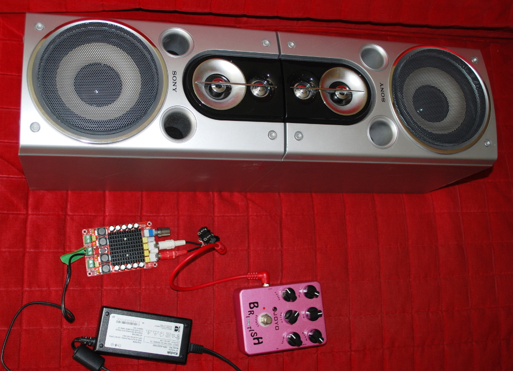

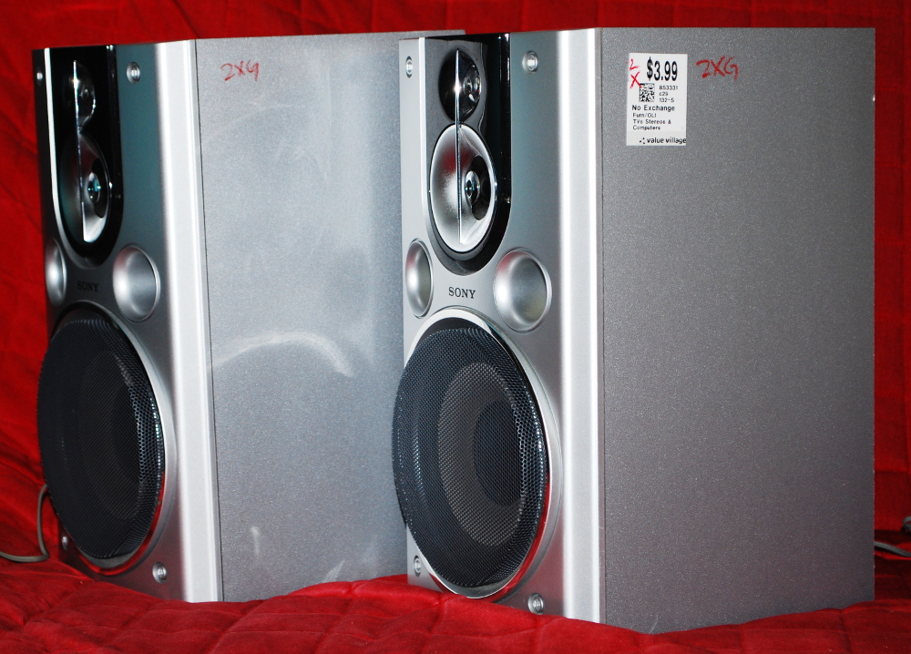

A couple of pics of my project. This started with a $4 pair of thrift-store refugee Sony speakers (first pic) and an Amazon.ca class-D circuit board.
Since the power amp has two channels, I decided to use both speakers. To minimise unwanted interference problems from two nearby full-range speakers, I had two choices: either stack them in a vertical array, or put them back-to-back, one pointed at the audience, one pointed back at the performer for monitoring.
I eventually decided to go with the vertical array, and the next problem was how to attach the two speakers to each other securely. It finally dawned on me to use a biscuit-joiner to do the job.
So far the electronics is extremely simple: a home-made adaptor connects a 1/4" jack to a pair of RCA plugs that mate with the class-D board. A Joyo British Sound (or Joyo American Sound) pedal provides Sansamp-like tube amp emulation, and accepts input from one of my guitars.
All testing so far has been done with another thrift-store refugee, this time a 24 volt switching power supply that says "Kodak" on it.
In keeping with the topic of this thread, that power supply will eventually be supplemented with a battery pack for off-grid use. The choice of battery chemistry has caused much head-scratching, and I still haven't made a decision.
This particular class D board has an onboard blue LED that lights up when power is applied. The Joyo has the usual LED that comes on when not in bypass mode. If an additional power indicator is necessary, I have some 6000 mcd green LEDs that light up brightly at 80uA (yup, 0.08 mA), so one of them would draw negligible additional power.
I expected these nominally full-range speakers would sound harsh and nasty, and I would have to design and build a "de-nastifying filter" as in a recent previous project that also used boombox speakers. To my surprise, that turned out not to be the case: for whatever reason, these speakers don't sound harsh. Most likely because the "midrange" and "tweeter" that Sony used are both actually cheap piezo devices that produce little or no output at any frequency where the guitar itself has significant signal output.
As far as playing guitar goes, this is everything actually needed. All that remains is to mount the electronics to the back of the loudspeakers and tidy up the wiring. It would be nice to have a little reverb as well, which could be done with any guitar reverb pedal.
However, in addition to guitar, I would like to add one or two XLR microphone inputs for singers, and that would require building some custom electronics, at the least, some sort of simple mixer to combine the mic and guitar signals. I may have to build the mic preamps too, if my little ART USB dual pre turns out not to have quite enough gain.

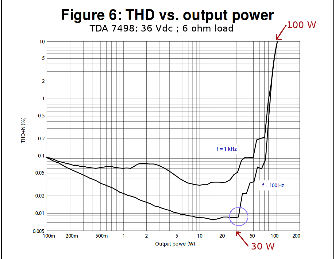

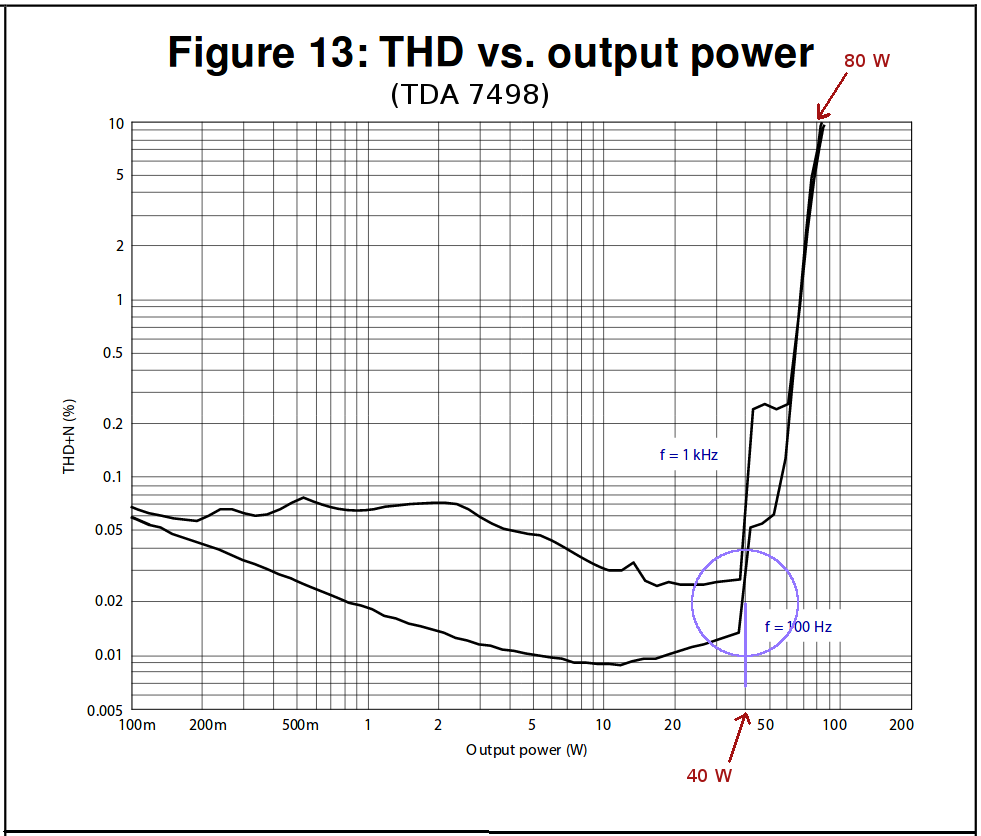

Ah, the old TDA7498......quite efficient little mite; your estimations are definitely on the conservative side; ST is posting 44 watts into 6Ω @ 10% THD on the TDA7498 datasheet. On this note, I agree with Fahey that power quotes at 10% are useless (especially for Class-D). I believe you'll have plenty o' power, though. Looking at the Micro Cube speaker, I'd say their claims of a 5" speaker are stretching things a bit; it's 4 1/2" at MOST; definitely the weak spot in this amp.
I find that comparing the datasheet THD vs power curve, and the datasheet maximum output power specification, can be quite illuminating. The attached images are from the TDA7498 datasheet for a 36 volt power supply, and 8 and 6 ohm loads.
Distortion is down at 0.01% - 0.02% at 100 Hz just before the amp starts to clip. When clipping starts, distortion spikes steeply upwards, and soars all the way up to 10%. The distortion increases by a factor of 500 - 1000 times (!), in other words.
Looking at the graphs, while the distortion increases a thousand-fold, the power output only increases by 2x - 3x times.
So what is the real output power? We all agree the 10% number is ridiculous. Should we go with 1%? That is still a hundred times above the distortion floor at slightly lower power; it is a hundred times more distortion than the chip is actually capable of!
To me, the honest power rating is the point at which you see the THD curve abruptly kick up, and transition from being nearly horizontal to nearly vertical. This sharp change of direction very clearly signals the onset of clipping.
For the TDA7498, and most similar chips, this point seems to occur at somewhere in the range of 1/3rd to 1/2 of the "max power at 10% THD" stated on the datasheet. Suddenly, the "100 watt" chip turns into a 30 watt or 50 watt chip. It's only a matter of 3 - 5 dB, but less technical buyers might not understand this, and prefer the "100 watt" chip to the honestly advertised 30 watt one.
I can see why the marketing department, whose stock in trade is lies, wants to claim 100 watts instead of 30 watts. Meantime, I bet the engineering department is frustrated by this, since their hard work in achieving a 0.01% THD floor has been completely hidden behind the "10% THD" spec.
The back-of-the envelope math I use to estimate output power may be a decibel or two on the conservative side, but it is quick and easy, and if it errs, it errs on the side of honesty. I think it's reasonably real-world accurate: I'm assuming 1.5 volts lost at each end of the signal swing to device saturation and power supply droop. How much better can we really do? 1 volt? 0.5 volt? Can we really keep our guitar signal peaks accurate to within 0.5 volts to avoid hard clipping, even if the amp can do it?
One of the nice thing about these class D chips is that they have brought the watts/dollar cost of audio power amplification so low that we can ignore the false advertising, and buy as much power as we need, within reason. So we have the luxury of pretty much ignoring the advertised power rating entirely. All we need to worry about, is whether the board can handle the power supply voltage and speaker impedance that we plan to use.
