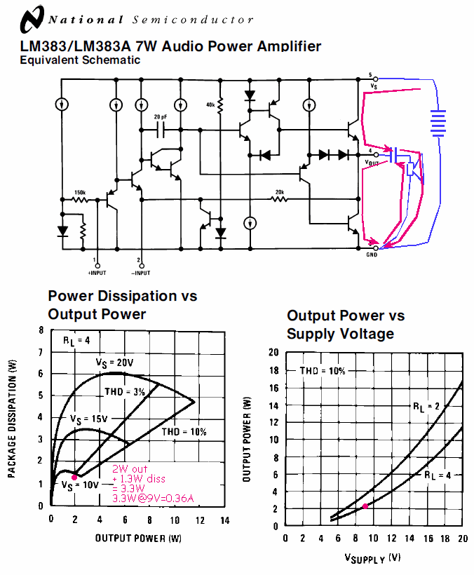

If it is a normal push-pull output (and not two amps with the speaker hanging between them in bridge mode), I think we may have been overestimating the (already very limited) capabilities of the microcube.How did you calculate the ~320mA?
You are always going to lose a volt or more to output device saturation at each end of the voltage swing, so with a 6 volt supply, it's very unlikely you will ever see a clean sinewave bigger than 4 volts peak to peak across the 4 ohm load. More likely the max is closer to 3 volts peak to peak.
Being generous and assuming 4 volts peak to peak across 4 ohms, we have a peak voltage of only 2 volts.
That means peak speaker current = 2V/4 ohm = 0.5 amps
RMS power to speaker = peak power/2 = 1 watt.

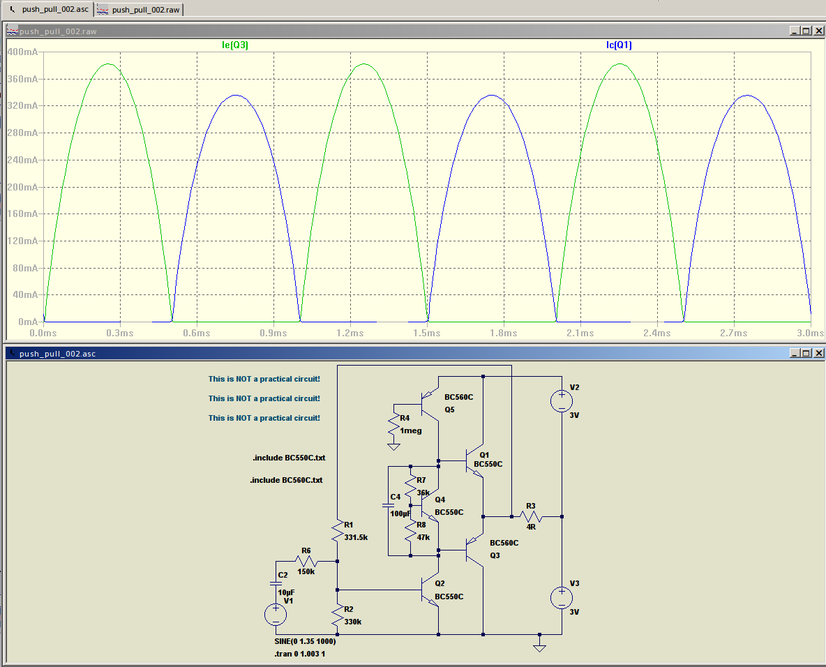

For fun, I threw together a simple push-pull amp in LTSpice; resistance values are tweaked to bias it perfectly in the simulator, but this is not a practical circuit for real-world use where parameter spreads and temperature variations have to be dealt with.
In the sim, as I expected, even with no battery voltage droop, the output starts to clip before you get a full 4 volts peak-to peak to the speaker. Peak speaker current never gets to 500 mA, but tops out at around 380 mA.
The green half-sine curves are the current drawn by one of the two output transistors. The blue ones are the current drawn by the other output transistor. They are slightly unequal because the amp is crude and there is some distortion at full output.
While those peaks get to 380 mA, there is a lot of empty space between the peaks; the average value for a full-wave-rectified sinewave like this is the peak value multiplied by 2, and then divided by pi (3.1416).
In our case, while peak currents are 380 mA, the average current from the battery will be less than two-thirds of that, or around 240 mA. And that's at maximum clean output.
So what we're looking at is a 1 watt amp whose output stage probably draws about a quarter of an amp at full clean output.

I shouldn't have posted at 1 AM - I made a couple of math errors.
2 volts peak, 0.5 amp peak. Peak power is then 2 x 0.5, or 1 watt.
RMS power is half of the peak power, so only 0.5 watts (not 1 watt, as I posted last night.)
I also miscalculated the average current. The current waveform through each output transistor does look like a half-wave-rectified sine, as shown in the LTSpice sims. But each transistor only pulls that current waveform from 3 volts (half the battery)...the net effect being that average current draw from the 6V battery will be around 120 mA, not 240 mA.
Okay, so roughly 1/8 amp average current from the battery; that's about 3/4 watt drawn from the 6 V battery (i.e. 1/8 x 6 ). And half a watt of that 3/4 watts is delivered to the speaker.

Current consumption can be estimated many ways.
I once figured a totem-pole feeding 8r acts-like 48r load on the power supply. So 4r load acts-like 24r. This assumes voltage-loss is small. Well, just assume 8V and we have 8V/24r, easy math, 0.33A.
Class B gets to 78% efficiency. Any decent AB transistor amp approaches 75%. So a 2W output needs 2.66W of DC power. 2.66W/8V is about 0.33A.
Or draw curves. Assuming 4V peak in 4r we have 1A peak. Assuming square-wave, half the time we have 1A from V+ to speaker, and the other half we have 1A from speaker to V-. So the average is 0.5A. But we conventionally assume Sine, not Square. So more like 0.35A average.
There's obviously some slop in these numbers 0.33 0.35. At some point I did go through and diddle my decimals and proved to myself they were really consistent. In real life, the other unknowns make this moot.

So it seems safe to assume that Roland's figures of 2 watts into 4Ω is reasonable, using a bridge mode arrangement; and that 185 mA of current draw is also a fair guess, being as how one is not delivering a continuous 2 watts into the speaker whilst playing. So I am wondering if it is also safe to estimate (using the TDA7492MV chip, accompanied by a step-up DC-to-DC converter to provide 12 volts from the 9 v supply), that I can get my desired ~12 watts into 4Ω at maximum. It should still draw approximately the same amount of current as the MicroCube's 185 mA while only working at the 2 watt level, but have much more AVAILABLE power if needed----at the expense of more current draw and less battery life should this be necessary.
So it seems safe to assume that Roland's figures of 2 watts into 4Ω is reasonable, using a bridge mode arrangement...
I don't believe a Bridge is involved.
Reality-check: a 12V car-amp with 4 ohm load will make like 18 Watts (more if you cheat to 14V and 10%THD). Then 9V would be 0.56 of that, 10 Watts. Roland's claim is under a quarter of that. As expected for bridge to non-bridge. It is a simple totem-pole.
Pull up the LM383 datasheet. It is mildly over-kill for this application but I don't have all night to search. It is a pretty good low-volt chip, though there are marginally better ones now, and more choice of smaller/cheaper packages. But this will work to show the basic performance.
The gut-shot shows it is not a bridge.
The claimed output at 9V 4r is 2W, in accord with Roland's claim.
Extrapolating 9V on the dissipation graph we get 2W out and 1.33W dissipation for 3.3W total demand, which makes 0.36 Watts. (And I don't trust the copied-copied smudge to 10% accuracy.)
Looking at the guts: for light load the upper output chain can pull-up to little more than 1 Vbe drop. The lower chain can pull dang-near to Gnd. At 4 Ohms, bottom of page 3 shows 7V swing, so we are losing another ~~0.7V each side from resisty loss. And yes, 7V swing in 4 Ohms is not 2 un-clipped Watts; most of these numbers are 10% THD from a sub-%THD circuit so represent significant clipping.
