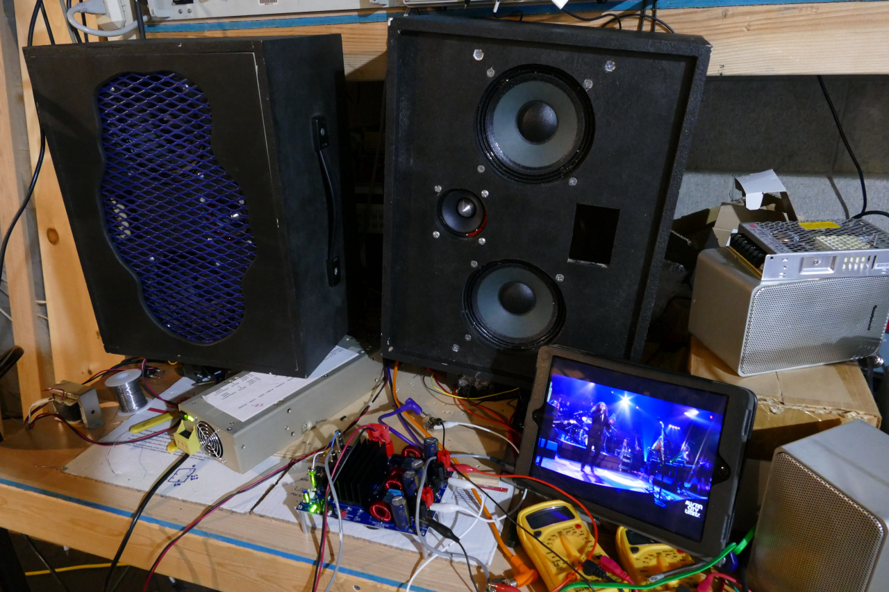

I am just finishing a portable mini-PA-system,
waiting actually for the LiIOn battery pack.
It will consist of
1 Pedelec Accu 36V/10Ah
2 TPA3255 mono PBTL-boards (2x100W/4ohms)
1 small Behringer mixer modified for battery power, delivered by
1 dc-dc-converter 36V-> +-12V
The hole arrangement is housed in a makita makpac, size2 box. Today I did a first soundcheck in our rehearsal room feeding it with a lab power supply - seems to work great with much power available.

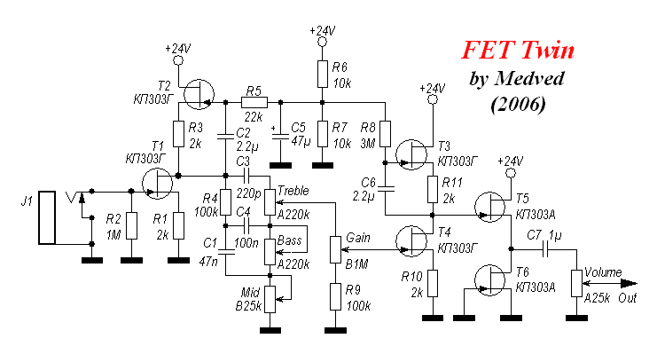

I just gave that schematic as food for thought for the thread. It isn't a bad starting point. No I haven't gone off on another direction, well sort of I have. I was just working in the direction the OP might find useful. It is just another 'what if', given the parameters how would I go about it. The Class-D module for the amp is a no brainer for a battery powered amp. I am even thinking of using one to drive a spring reverb. The problem I have is I have a high impedance tank, an 8 ohm one would be just ducky. I might use a small line transformer to step up the drive. I think I have some 25V ones.

Just had a little more to add. When you guys were looking at the LND150 I said I wanted to see if I could transpose some of the qualities of the circuit into a low voltage version. I doubt I will for this iteration but I plan to see if it can be don without too much grief. Again, for others to get into electronics, high voltage is not an issue with me.
I'd never heard of a Makita Makpac before - thanks for the tip! That looks like a good option when you need or want a professional looking, rugged, enclosure.
You're using 8 ohm speakers? 36 V power and an 8 ohm speaker should put out an honest 65 watts RMS per channel or so (assuming 4 volts lost to saturation and power supply droop.) Twice that for two channels, say 130 W total.

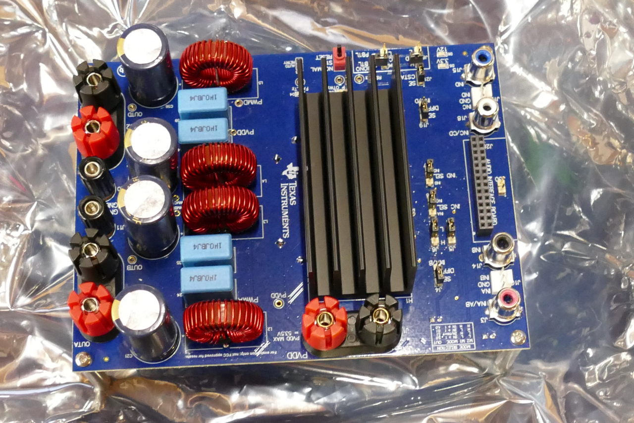

Meantime, the finned heatsink on the "100W + 100W" (not really!) class D module I have is about the size of a matchbox.
This bad boy is supposed to make 600 watts at 10% THD on 53 volts, and well into the 500W range at 1%. I believe those numbers. I have personally run it at about 150 WPC on 52 volts until it rattled the drivers loose in my DIY speakers. The heat sink is larger than a 6V6GT, but smaller than a 6L6GC. It was slightly warm after that abuse test. I just got a $50 Chinese bass guitar to go with my $60 Chinese electric guitar. I'm thinking DIY preamp into this bad boy for some serious thunder.
It seems that these are still being offered direct from TI for about $80.
TI Class D EVM Board 50% Promotion
