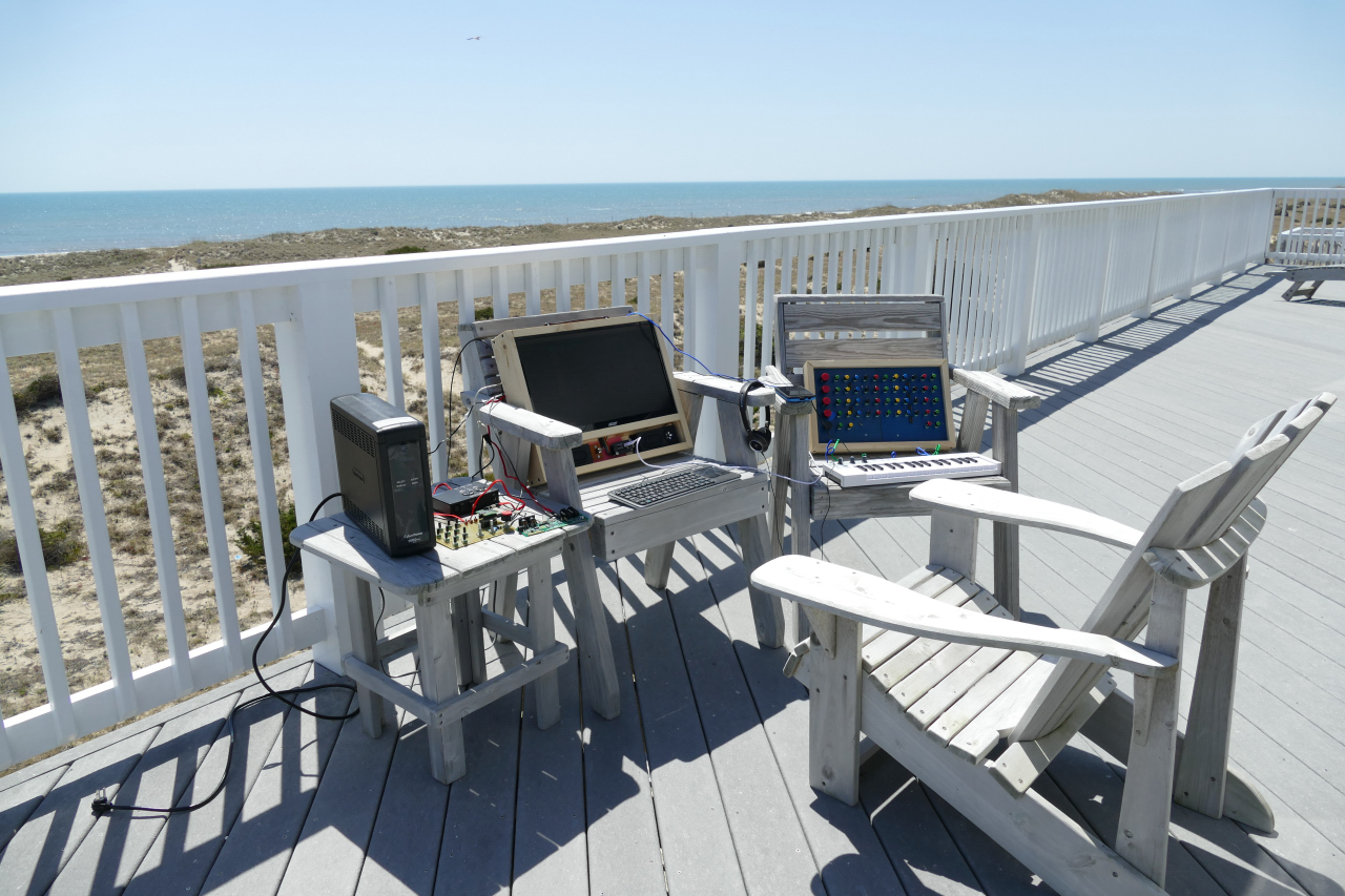

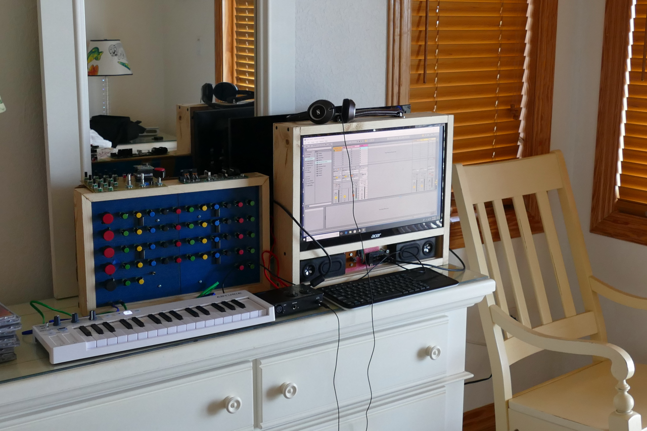

Our extended family rented a large 4 story house on the Ocean in the outer banks of North Carolina for a week. There were 12 people from the ages of 3 to 83 present. I took this "once in a lifetime" opportunity to take over 35000 pictures, most in rapid sequence for the purpose of making some time lapse video for YouTube. I brought along three DIY music synthesizers and the portable PC loaded with Ableton Live. I set it up on the 4th story deck overlooking the ocean each day, and left it running so I could capture some ideas in Live and on camera whenever the mood struck me. I also set it up in my room for playing at night. Unlike the other people in the house I never turned the TV on or played a video game.....you can do that stuff at home.
I'll post some videos on Youtube once I have had the time to organize the pictures and musical ideas into something that resembles a coherent video with a synthesizer sound track.......no guitars though I may add some here at home.
The UPS idea worked out so well that I may attempt to build something like it without the weight penalty of lead acid gel cells.......that thing was heavy. I carried it down to the beach so I could shoot some pictures for a video called "Small Synths in the Sand" but the wind, and the windblown sand convinced me not to bring my expensive camera to the sandblaster. It was so bad that just wandering the beach was not worth it, except for late evenings.
