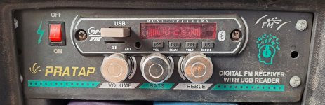

My car radio, similar FM module...

There are many people selling these assembled amplifiers.
The FM modules come in average and good quality versions, and a new version has come with a different shape and bigger buttons, same type display.
FM modules and ICs are imported, cheap versions have cheap capacitors, expensive ones get Keltron capacitors.
Resistor, PCB, pots. soldering etc. is done locally, mostly in Delhi area.
The (discontinued by Sanyo) 4440 IC has been copied by the Chinese, about 25 Rupees each, assembled and populated PCB is about 225 Indian Rupees. 0-12V AC supply, or 12V DC. 6W/channel in single, or 19W in BTL.

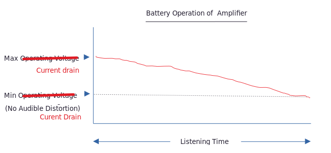

I am running my LM386 off batteries - I noticed that the 9V battery is not rather depleted and cannot power the amplifier without distortion at even low volume levels. The voltage reading, however, is about 6V. Connecting 3 AAA batteries which have a maximum of 4.5 V, I can run louder without so much distortion.
It is not the voltage reading that is important, then, but the rate of discharge (as mentioned by a member) that is important here.

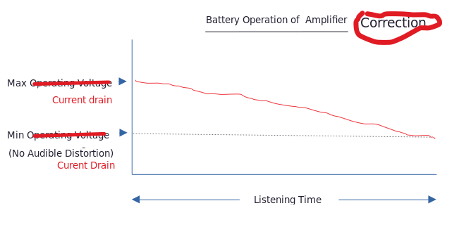

I changed my diagram: Is this correct?
