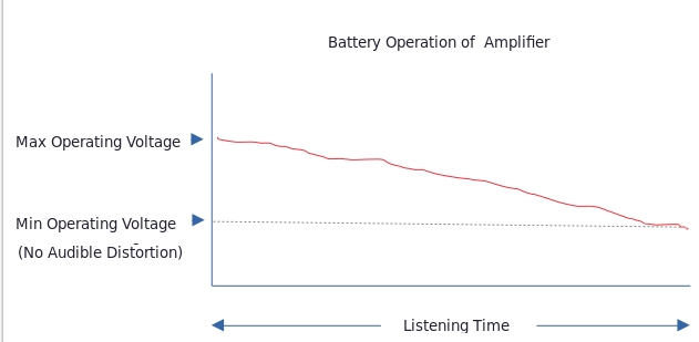

My impression is that the design for a specific listening time should make sure the loss of battery charge should be as slow as possible within the limits of the amplifiers maximum and minimum voltage? Is this correct?

I have been doing some research on this subject for a hifi setup in my truck camper and from what I understand so far the problem with the battery is voltage sag under load otherwise known as power supply impedance. Could a step down regulator stabilize the voltage ? But how does one design an ultra quiet high current stepdown regulator ? Maybe any regulator noise wouldn't matter if the amp had a well designed CRC filter. Definitely an interesting subject.
One way to think of the power amplifier is that it's a giant linear regulator, programmed with an audio signal. Dealing with sag is already part of its job.
If a class A amp has a CCS, apart from acting like a negative resistance, it filters out the audio as seen from the line, and it could be a good option despite drawing lots of power. If it's push-pull, the line can be loaded down with audio and lots of harmonics, depending on the overall design.
One nice thing about batteries is that you're not stuck with just ONE. But if there are lots of them, then recharging could be a project in itself, with a bank of relays and Raspberry Pi to control them all, or something like that.
