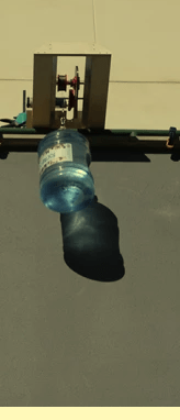

The third test was just right. We added 5kg to the container, bringing the total to 15kg. Not only did it generate enough power to start the record player, the drop time was just short of 9 minutes; we managed to play the better part of Side 1 of the Johnny Cash album At Folsom Prison.
https://reconstrained.design/projects/gravity-battery
It just proves that using a mass and pulleys is not adjustable... it always generates a fixed power/time profile. Unless a brake is used, and that wastes energy. Perhaps a complex, adjustable set of multiple pulleys, but then that really adds complexity, cost and friction.
Water going through a variable area orifice is adjustable and does not rely on a brake.
The next comparison will be the efficiency of a water paddle wheel ( turbine ) vs gears to run the generator.

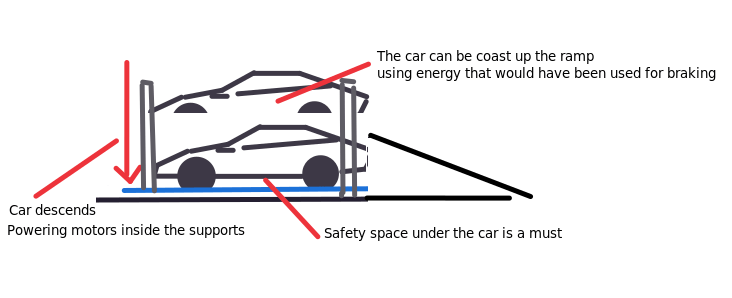

Here is an idea, with ChatGPT making short work of its feasibility: This system generates the energy contained in 2 1200mAh AA batteries.

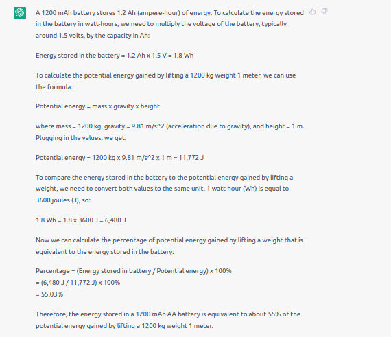

QUESTION:
If a AA battery stores 1200 mAh of energy, how much energy does it store and what percentage of energy is it compared to the potential energy gained by lifting a 1200 kg weight 1 metre?

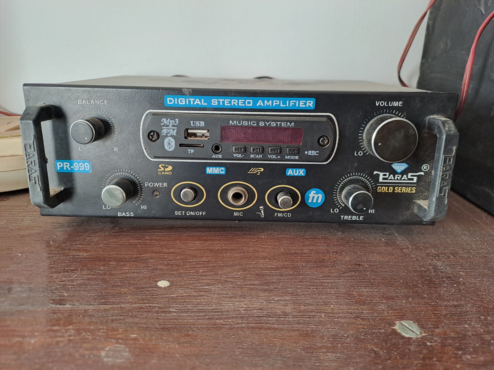

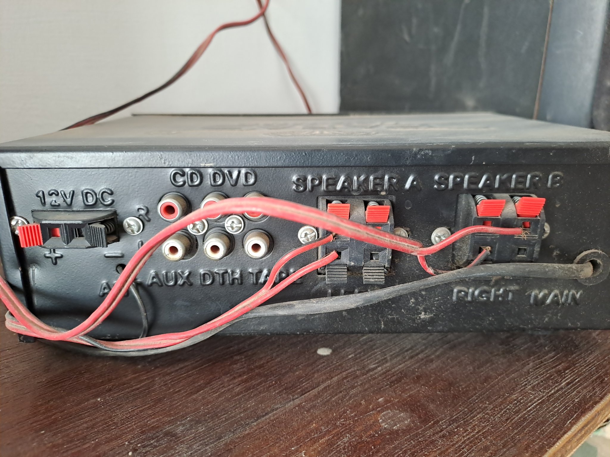

Mains version of amp, can be used on DC also.
Same FM module as in car, remote is easier to use for changing channels, tracks, input and also volume.
You can connect a mic in front as well.
Less than 10 USD...
