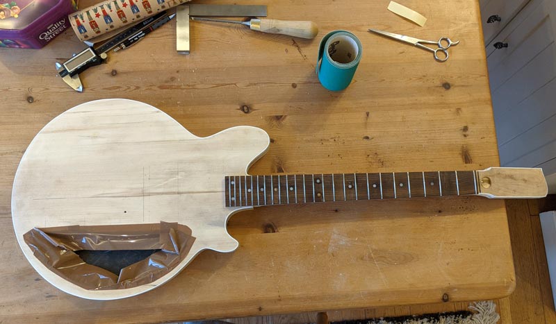

I have my first child on the way shortly, so perhaps I just want this amplifier project as a bit of escapism!
Off topic, but I'm racing against time to build a guitar before the bambino arrives, I like the idea of playing entirely through things I've made.

My two cents: do whatever gives you the most enjoyment. Particularly in today's unhappy, COVID-raddled world, every bit of happiness one can scrounge is so important. And if that means DIY instruments and DIY low-power valve guitar amps, so be it! 🙂
Years ago, when I was the prototypical starving student, I built my own electric guitar, because I was too poor to buy one. It was made from scraps and bits and pieces, including a broken archtop acoustic guitar donated by a classmate, and pickups I made myself using bits of broken loudspeaker Ferrite magnet, plastic bobbins cut and glued from the little boxes in which my mom's typewriter ribbons were packaged, and metal strips cut from an old steel bed - with my mom's scissors!
It wasn't a great guitar, but it was all I had, so I played it anyway, for many years.
Your build looks great already. Is the shape of your guitar inspired by Brian May's own DIY Red Special?

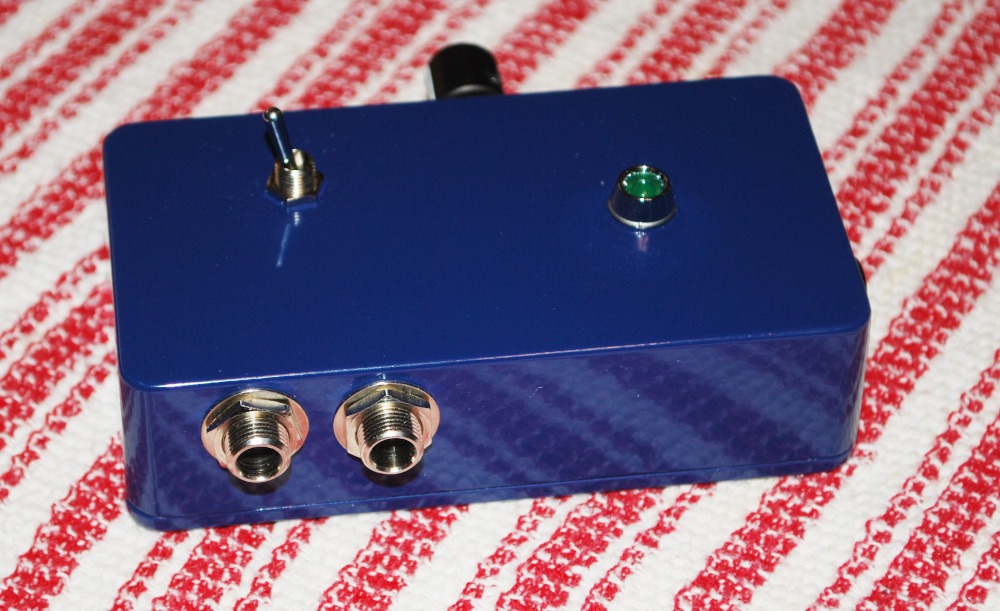

My most recently completed project - the little headphone amp I now use with my Flamma Preamp - is an example of this. I used a ready-made "evaluation board" with a little SMD stereo class-AB audio amplifier already completely built on it, along with another separate little breakout board containing a DC-to-DC converter to drop the 9V DC power supply down to 2.7 V for the headphone amp, limiting maximum SPL levels to less dangerous values.
Since all I had to do was figure out where to place all the bits and pieces in the little Hammond die-cast enclosure, and then drill all the holes, mount the parts, run the wiring, and solder everything up, it only took me one day to build the project, once I had all the parts in hand, and a few hours of free time.
I should add that I'm not trying to steer anyone else away from their chosen path to hobby happiness - merely mentioning that in exchange for adapting to the constantly changing world of electronics, one does get some rewards along with the loss of old preferences.
Here is a picture of my recently completed headphone amplifier. I don't love having the volume knob on the side of the (guitar FX pedal sized) enclosure, but that was dictated by the dimensions of the audio power amp breakout board, and the internal dimensions of the Hammond die-cast box.
The two 1/4" jacks are for left and right inputs - I can plug stereo FX pedals (like many reverbs) into this headphone amp. The little toggle switch is a mono/stereo switch - if driven by a mono pedal, flipping this switch to mono makes sure both headphones (L & R) are driven with the same signal, giving you a "double mono" soundfield.
The headphone output jack, and volume control, are on the far side of the enclosure. The green LED, of course, is a power-on indicator.

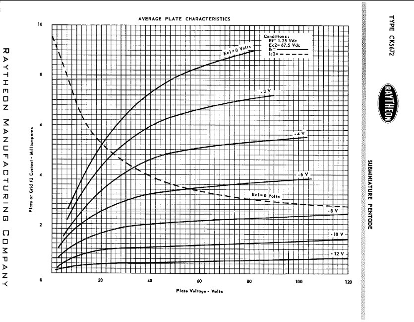

I'm trying to get my head around around how to interpret the amount of signal strength required to get full output power from a tube and to go beyond this point for overdrive.
Say in the following chart for example, if I have picked a bias point (say -6v) and my plate (say 60v) and screen voltages, how do I know the signal voltage swing required for some distortion?

Is it in simple terms a case of having a signal voltage swing capable of driving the control grid up to 0V and beyond?
In which case, using a Bassman/JTM preamp section as is, without knowing the exact voltage swing to expect from the phase inverter, let's say for the sake of arguement that it's 50Vpp - for the case given above:
The positive voltage swing would be -6V + 25V = +19V
The negative voltage swing would be -6V - 25V = -31V
Well off the charts for the 5672 tube above, so I would expect to have to ditch maybe 75% of the signal from the phase inverter, meaning:
The positive voltage swing would be -6V + 6.25V = +.25V
The negative voltage swing would be -6V - 6.25V = -12.25V
Which looks more compatible with the charts. Am I in the right ball park?

As I understand it, the grid cannot go positive. 0V is the limit. At exactly +-6V you will have full output. If you increase it, it starts to hit the 0v line and distort. So you do want more than +-6 for distortion. The question is, how much more before it starts to sound fuzzy?
I am not sure what happens when you come close to the 0 current line, though. I guess you can go very negative, but the change in high voltage will be small once you are above a certain value (the lines get really close together).
I agree with you that by dumping 75% of the signal it looks better. You may want to drop less signal, so that you can check how much is too much.

As you and Thomasha have been saying, positive input swings have no effect at all once grid voltage reaches 0 V. The output tubes start to flow grid current, their input impedance plunges from nearly infinity to just a few kilo ohms, the phase splitter can't supply the requisite current, and even the input signal flat-tops....signal strength required to get full output power from a tube and to go beyond this point for overdrive.
But you will get some distortion well before clipping occurs. As you can see from the datasheet, the anode curves are quite unequally spaced, and get closer together both as you approach zero grid voltage, and also as you approach -12 volts on the grid. If you have reasonably good ears, this will cause subtle (but quite audible) amounts of distortion long before clipping occurs.
Guitarists will typically call this low level of distortion "clean tone". But in fact it has several percent THD, and this is what makes "clean tone" from a tube amp sound so much better than "clean tone" from a typical solid-state guitar amplifier. The SS amplifier will typically have 0.1% or less THD, which sounds too clean for guitar - thin, cold, lifeless, sterile, etc.
Okay. So much for subtle distortion. What about the other end of the curve?
My rough rule of thumb is to initially aim for a peak drive signal that's twice as big as the actual grid bias voltage. In other words, if your output grids are biased to -6V, aim for a 12-volt peak signal (24 Vpp) as a starting point. You can always tweak it from there by ear.

It so happens that your rule of thumb is pretty much spot-on for the 5F6-a circuit. The bias voltage (according to the schematic) is -48V and the PI clips at about +95V on one side and +80V on the other into a 220kΩ load (grid leak value).My rough rule of thumb is to initially aim for a peak drive signal that's twice as big as the actual grid bias voltage.
Cool!
Do you think this might be coincidence, though, since supposedly Leo Fender never intended his Bassman to be overdriven?
I think the rule of thumb works well as a starting point. If the loadline for the output tubes is carefully chosen to go "through the knee" of the pentode curves, it gets me reasonably close.
