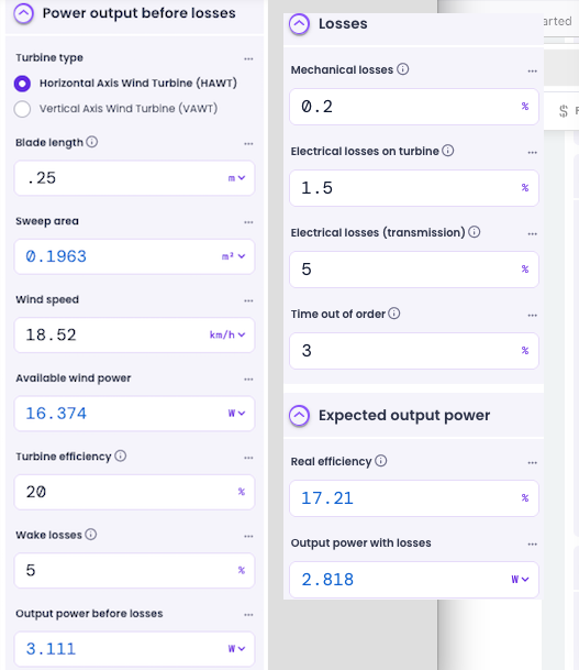

This site has information about calculating wind turbine efficiency:A question here, what would be this turbine's efficiency if it can provide the design power of 100w in expected 10 knots of wind?
https://www.omnicalculator.com/ecology/wind-turbine
With a swept area of ~.2 square meters at 18.2km/h (10 knots) there is ~16 watts available from the wind.
20% efficiency would probably be on the high side of what you might expect from fans used as generators, one might produce ~3 watts at 10 knots.
When the boat is moving upwind, the wind resistance of the generator would be ~6 times what its power output contribution is.
By comparison, a person can put out around 100 watts, and a .2 square meter, 15% efficient solar panel up to 40 watts at solar noon.

This is the problem. I hope you got my lil pun with the Betz available. I don't truly understand this, so I want to explore this. I am sure a lot of smart people have already, but just like the anti-reverse ball bearing, maybe someone well versed in other area may find ways to connect the neck bone to the hip bone. Something that a windmill geek/engineer might just not think of. Just like the ARBB, I know about this item from exhaustive work with fishing reel drag systems and now with bike hub tech. When I read about the difficulties that foil type turbines have in starting up and how they can carry smaller secondary drag type helper I started thinking other ways to initiate the foils, and it came to me that the drag type can be just as wide or wider then the foil type if they are isolated from each other but able to pull on the same shaft. This keeps the shaft turning at low and high speedsavailable from the wind.
We want to see what we get at 1 turn per second on this hub motor. Its peak performance is at 11 rounds per second loaded where it draws 1500w at 48v. We are only after 20w from this
What I don't understand is the surface area part with if that is per blade or total of the blades and if it also takes leverage into account?
So 2m2 to generate 16w in 10 knots. Firstly, is it wrong to see the system as what's needed to generate 16w, rather than seeing it as a dismal net result? I mean it that is the situation, then it also is the target and specification. In that case these losses cease becoming losses and rather the 'transfer' system. I implore to view it just like using over spec components in an audio system to spec it at a lower distortion at a lower operating point
Secondly and more importantly is that 16w available another iron law? Can we lift that 16w to 20w for the 2m2 in a direct drive?

I wasn't aware it is the "Betz limit" that states that no wind turbine can convert more than 59.3% of the wind's kinetic energy into mechanical energy, so the lil pun was lost.I hope you got my lil pun with the Betz available. I don't truly understand this, so I want to explore this.
Anyway, presently the best engineered large scale wind generators only extract ~80% of the Betz limit (47.4% of the wind's kinetic energy), small scale generators far less.
