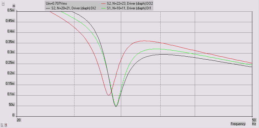

Be careful with ported isobaric enclosures. The two drivers do not couple properly at the port resonant frequency due to the compliance of the air between the drivers. The resonance in the enclosure minimises movement of the rear driver, but the front one can still move due to the "springiness" of the air between the drivers.
The attached graph shows the excursion of two MCM55-2421 drivers mounted face-to-face in a 30 litre enclosure tuned to about 30 Hz. The black line is excursion of the rear (inner) driver, the red line is excursion of the front driver, and the green line is the excursion if the two drivers were coupled rigidly (cone glued to cone). The difference rapidly gets worse if you increase the volume between the drivers, for example by mounting them in tandem (both facing out).

Correct. I am aware of the problem (which cannot be avoided in vented PPC), but its effect is not as detrimental as it seems. First, the drivers have a mechanically rather stiff suspension (their Vas is only 14 liters), second the air volume between the drivers is only 3 liters (the rest is "filled" with their frame and magnet structures), so the resulting air spring is rather stiff.
If it causes any distortion, it is around port resonnce (30 Hz),where the ears sensitivity to that aspect is not too high, and very likely still distorts less than a single woofer with its bending cone at that frequency.
Anyway this design went through already on a few hundred hours of listenings and demos for friends with good ears and gears, and none of them ever complained about any kind of distortion, actually almost all of them commented immediately the unusual clarity and articulation of the lower registers.
