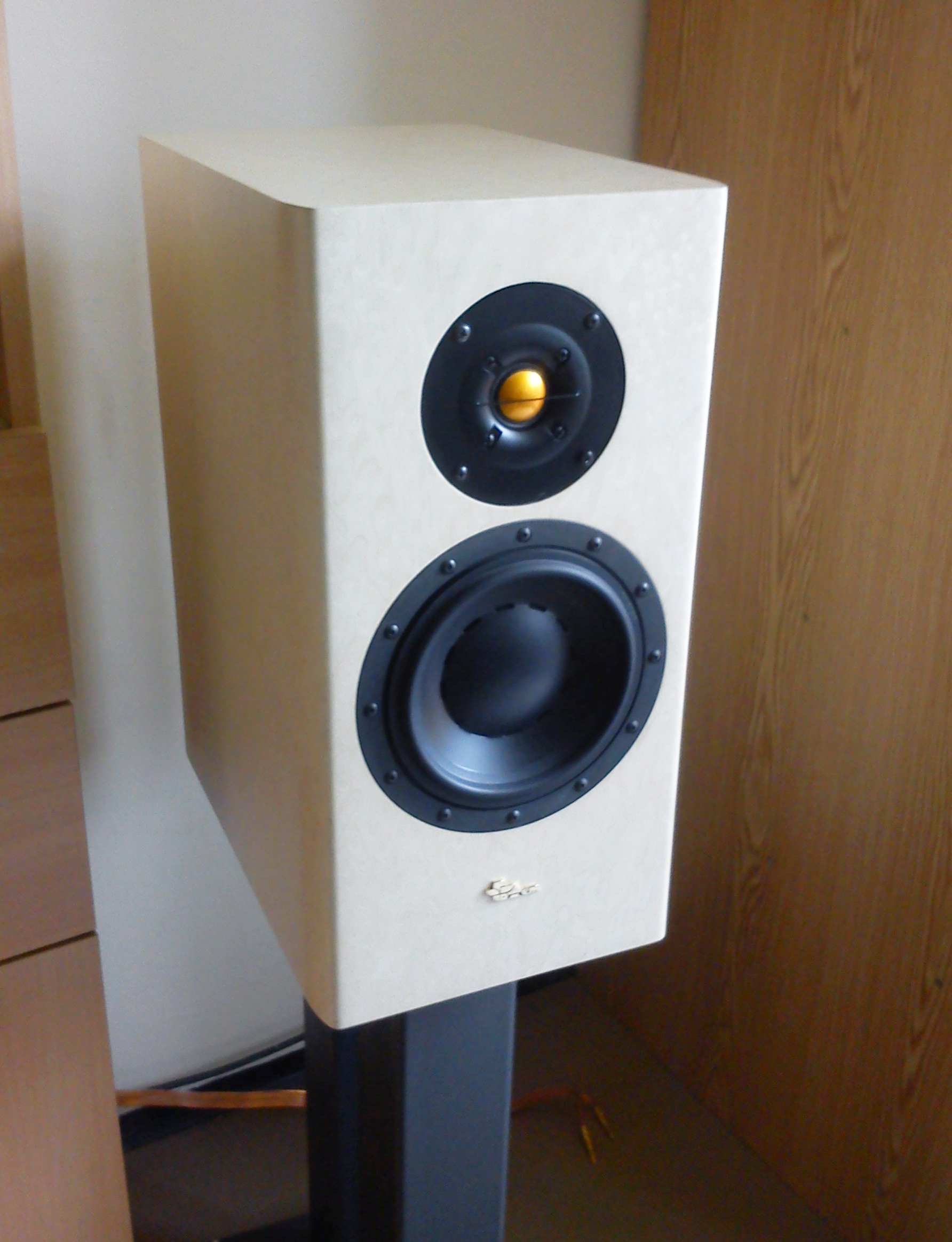

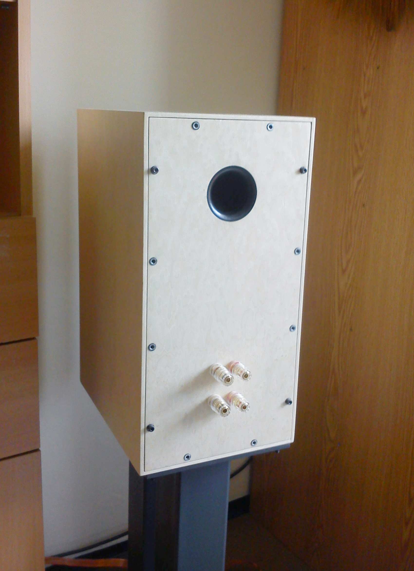

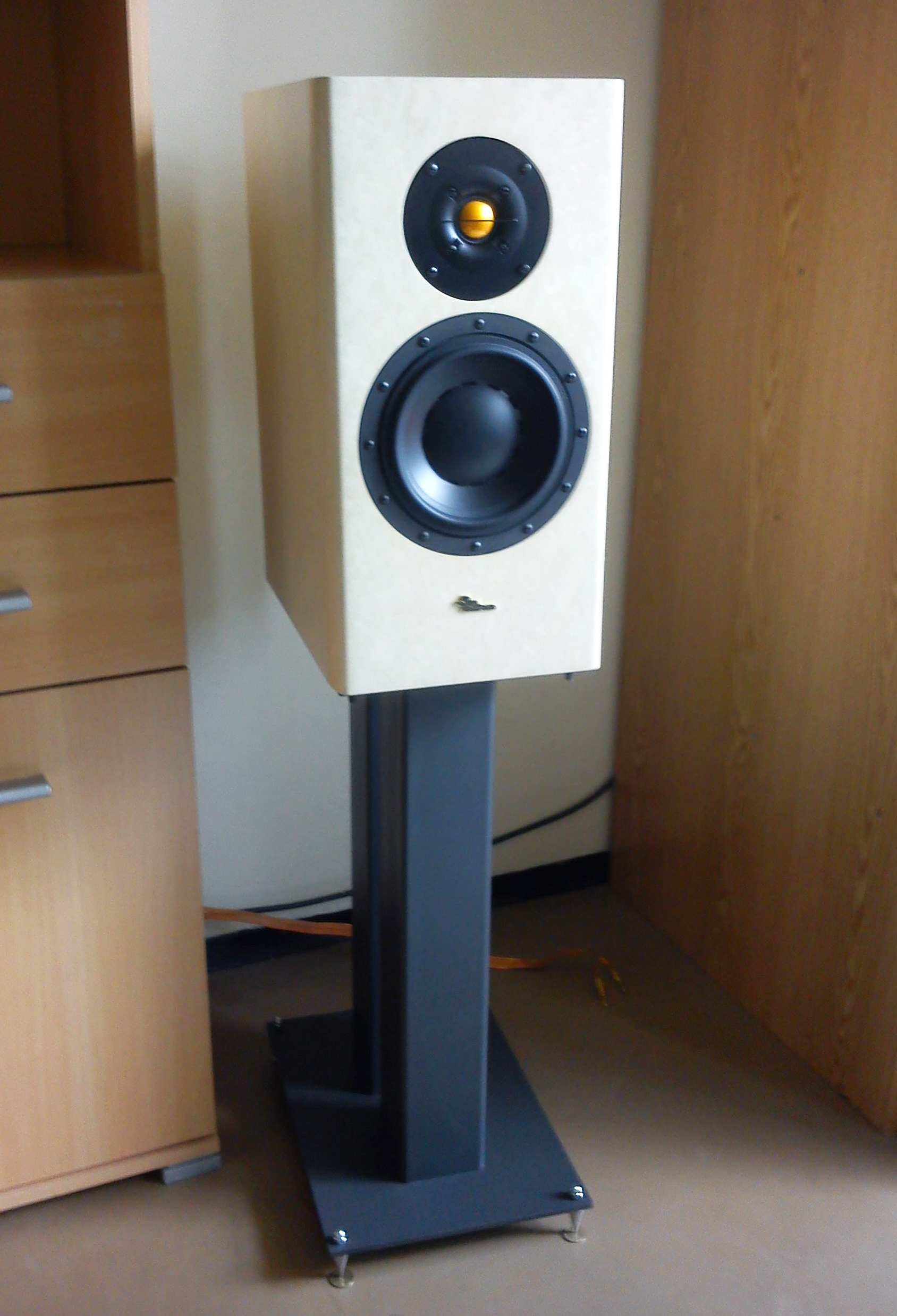

Here are a few shots of the box, I will dig out the box plans some day. They are veneered with "whiteish" sycamore-maple (if I am correct), over 3/4" and 1" MDF. The back plates are removable (obviously, inner driver access) fastened with 1/6" metal bolts into threaded sleeves. Their net internal volume is cca. 15 liters, plus the PPC enclosure, so overall about 19 liters. Tuning is done with 1.8" i.d. PVC tube 21cm (8.3")long both ends flared. I am not going into details with the crossover, it is still in the works, but I must find a tweeter witl low Fs, no ferrofluid and very good sound without costing a lot. My primary candidate (based on previous experiments ) is the SB29 RDC from SB Acoustics. The planned Xo freq. is around 2.2kHz, looking up with some sim. programs it can be done with a simple 2nd order voiced in for the particular drivers.
He did say bass impact, way too small for such ....
