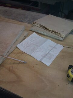

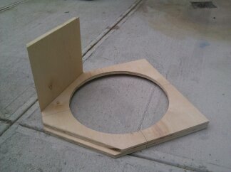

That was in one of the earlier editions. The last drawing, and Hornresp input screen are correct: the slanted corner board is 12"deep, you add to that the thickness of the Front-outside (filler) board, and you get a duct length of 12.709".
Looks like you're having access to a nice wood working shop. Hope you get it done in time, and keep the pictures coming.
